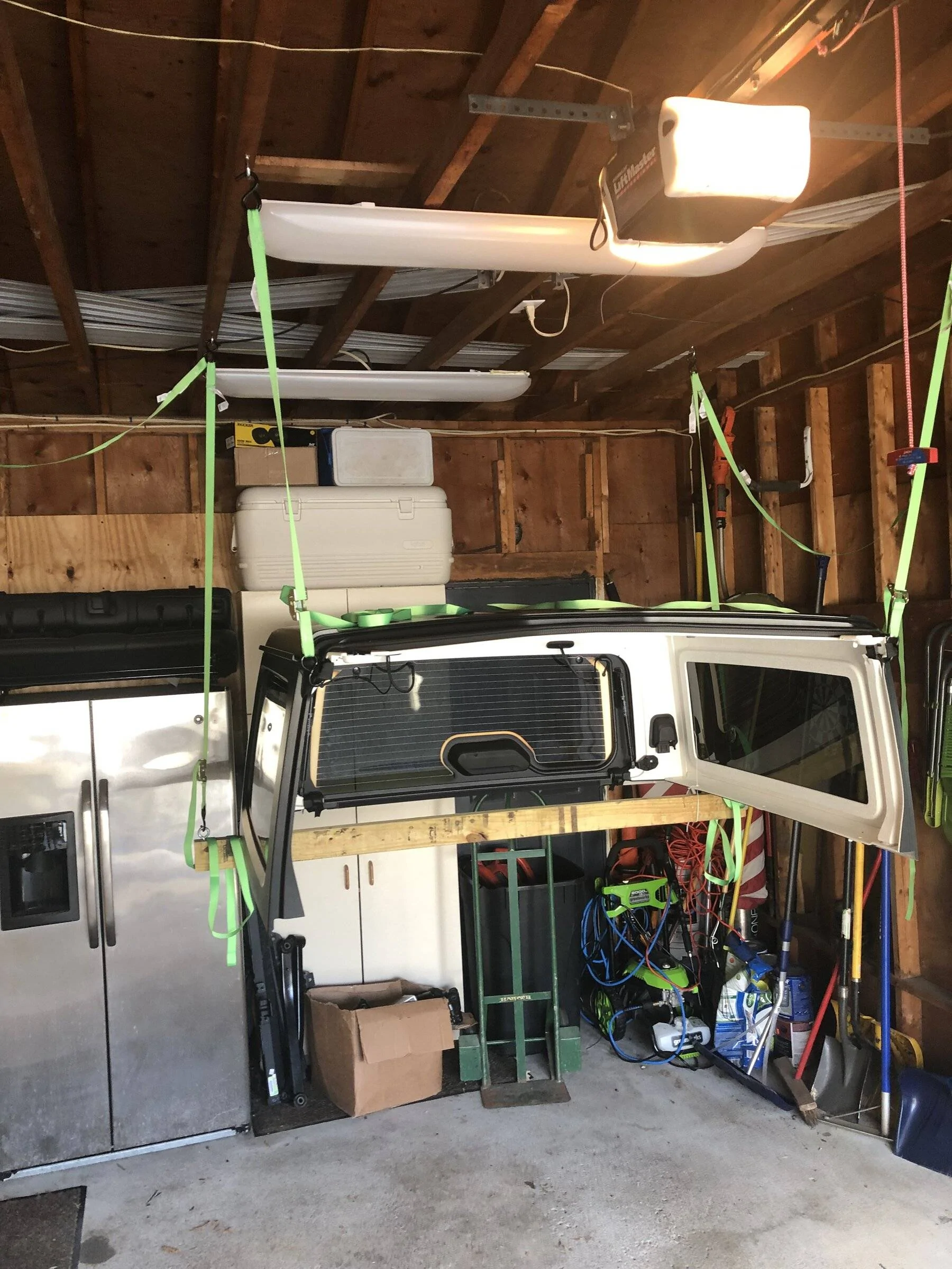

A few pieces of angle iron, some quick links, a set of cam buckle straps, topsy brackets and good too go. $50 max.
Jeep Wrangler JL Where do people store their hard top? 99536B6A-AD22-4F97-8DC2-5BB14EBBAB68

I think you sold me on this route. As I wait for my jeep, I'm trying to prepare for how I'm going to store the dual tops. I had planned to do the hoist through the rafters.. but this seems just as secure and a little less prep. Thanks for the pic.

Only advice is to take your time lifting it. Each cam strap makes it easy but my dumbass lifted quick and scratched the door since I wasn’t 100% lined up.
New rules:
-doors open
-verify wiper motor disconnected
-lift slowly keeping top from swinging
-verify rear tire clearance when driving away.
I’m an idiot and rush sometimes. Take your time and you’ll be good.

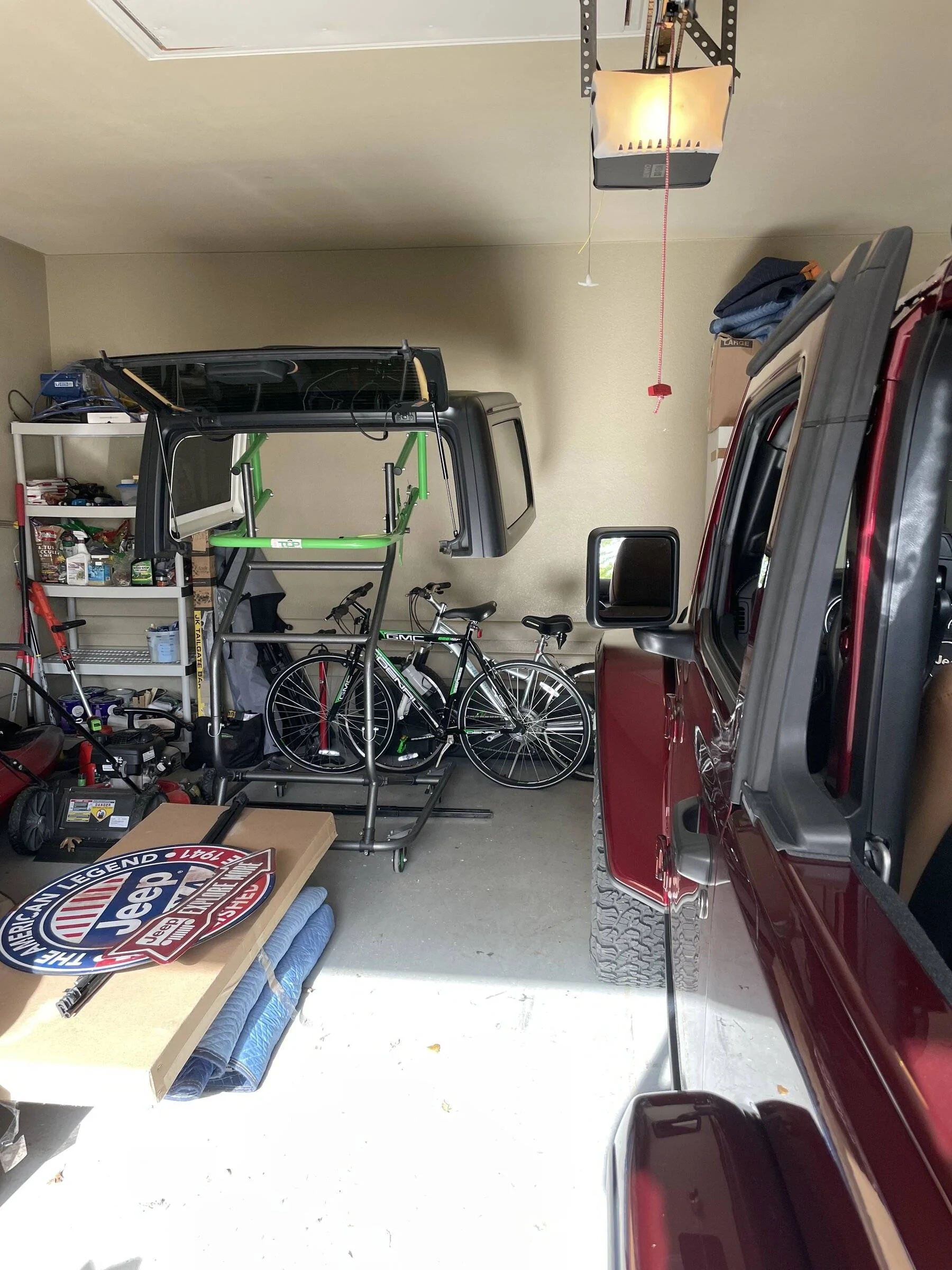

ALso if you are storing hard top longer term I would not do it with suspension as it may tweak the shape, which is why I bought the Costco shelves so the top basically take no room away from the garage and no ducking to get around it.
Jeep Wrangler JL Where do people store their hard top? Hardtop storage 1
