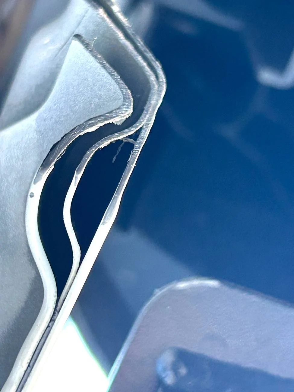

I didn’t need to do much trimming on mine. I only had to get into the bottom rivet… after I cut mine I filled the void in with JB Weld, and painted it with Mopar color matched paint…..then I painted the part of the fender under the flare black…Sorry I don’t have a better pic, it’s 6 years now and no issues….
Jeep Wrangler JL Wheel Well Trim IMG_0412
Jeep Wrangler JL Wheel Well Trim IMG_0411

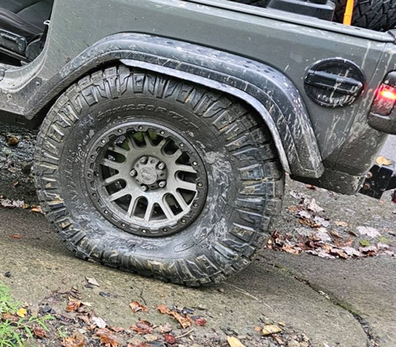

@Bearcrawl I did not need to trim anything to run 38x12.50's... I am still on factory rear arms but I also still have liners
Jeep Wrangler JL Wheel Well Trim Rear Clearance

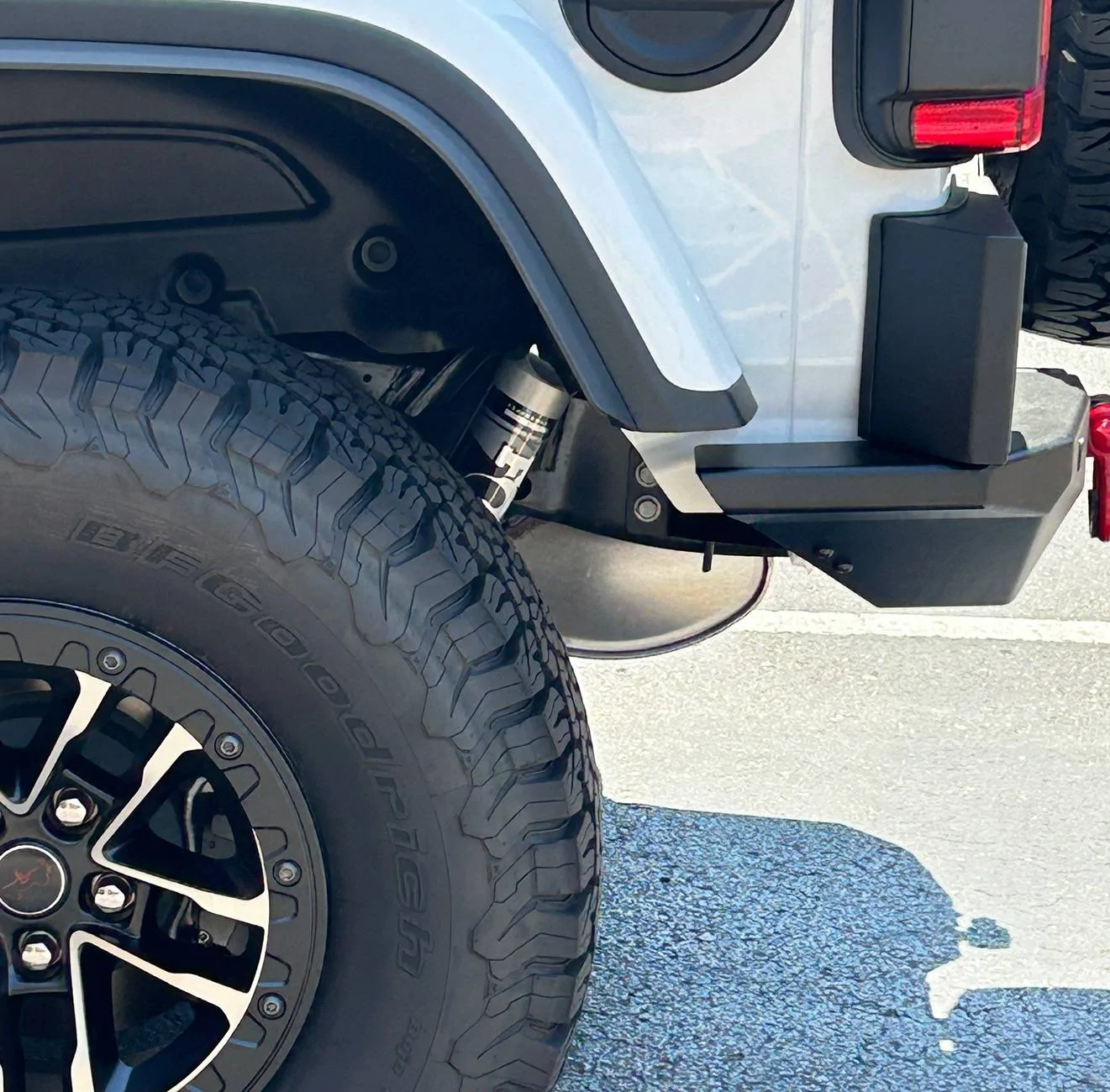

My god that is a clean cut, nicely done..

Thanks, I have been known to be just a little OCD... :)
Also I did not use a filler like JB Weld as the factory did not (drainage?) and still had good spot welds just above.

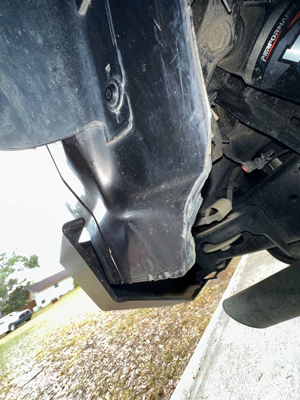

A couple pictures below of rear lower trimmed wheel well:
This is mine after trimming and painting...
Here is an end view before cleaning up the edges and painting....

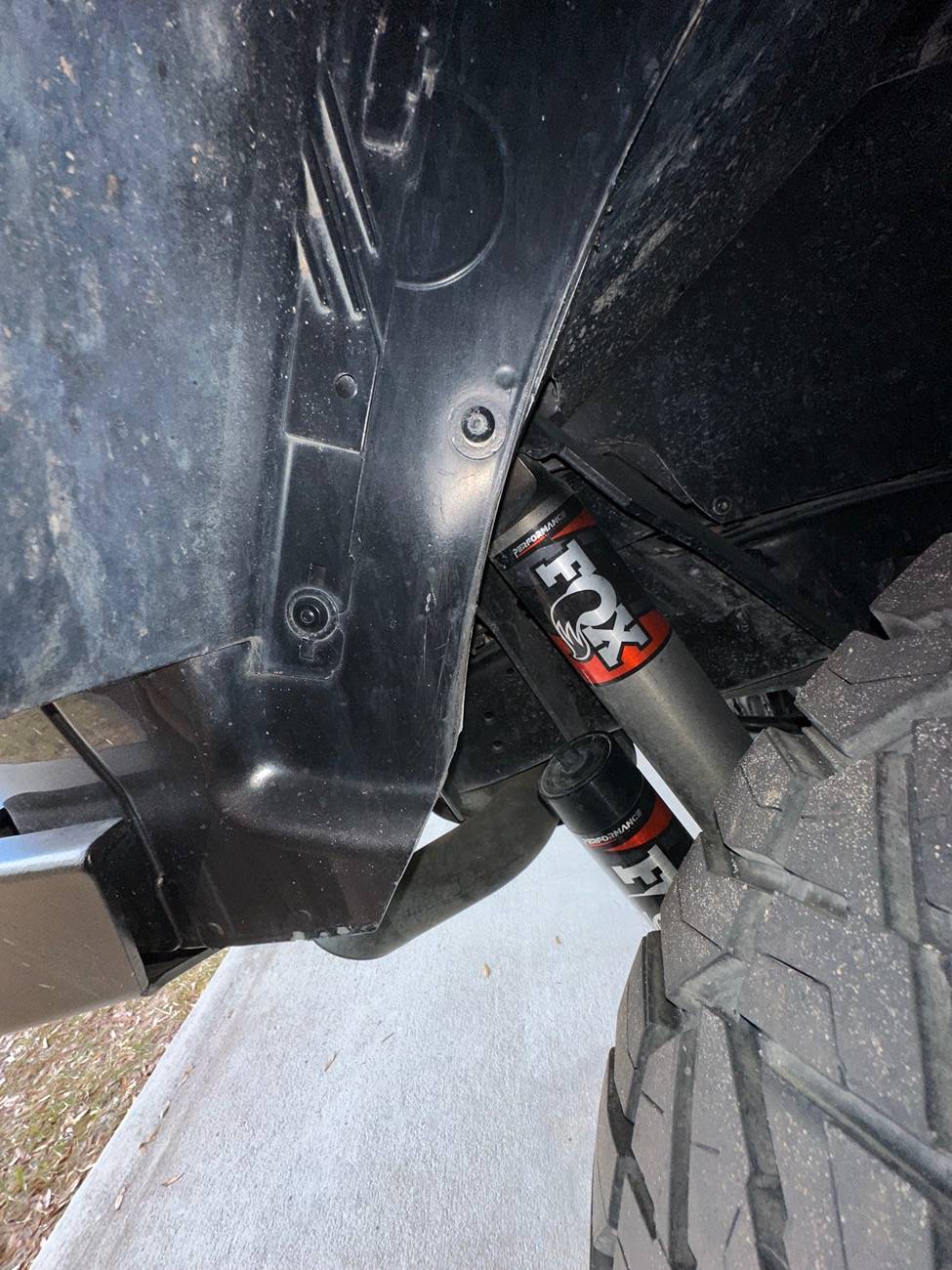

@4x4Funlover I recognize that this thread is really focused on trimming sheet metal in the rear fender but I have a closely related question related to the rear fender liner rubbing/trimming; you mentioned that you are still on factory liners though your tire is stuffed in your picture.
Did you do trimming of the OEM liner? I just upgraded to 37s and have rubbing aside from extending bump stops which is obvious, I also want to avoid ripping the liner out at full compress.
I removed the lower rear part attached to the bumper(and the bumper shortly after) and heated the part above that with a heat gun and molded it around the pinch seam. I did not have to cut the liner at all. I think I have 2.5" of bumpstops added for my 3.5" lift
Cool. Thank you. I will do those things too. I recognize that these are obvious adjustments but I also don't want to just start cutting randomly and just stacking bump stop extensions when others like you have already broken the ground. Good news is that my pinch seam is already gone, trimmed that a few years ago already.
