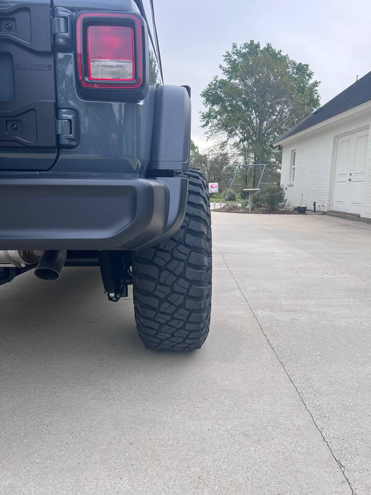

38x12.5r17's on 17x9 with a -12 offset just a little poke before the XR flares (dont know it if matters as much in MD) 3.5 inch lift.

Awesome set up. What suspension and can we see it from the side?
