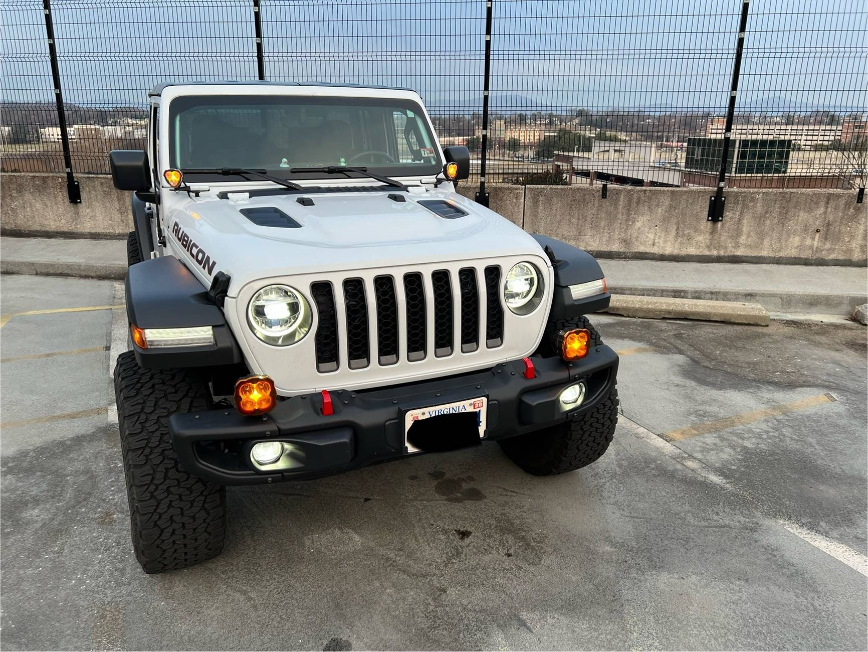

SWVA JLUR
Mar 25, 2023
187
366
JLUR Wrangler
Those tires on 17x9 wheels with -12 offset will stick out roughly 2.8 inches.
