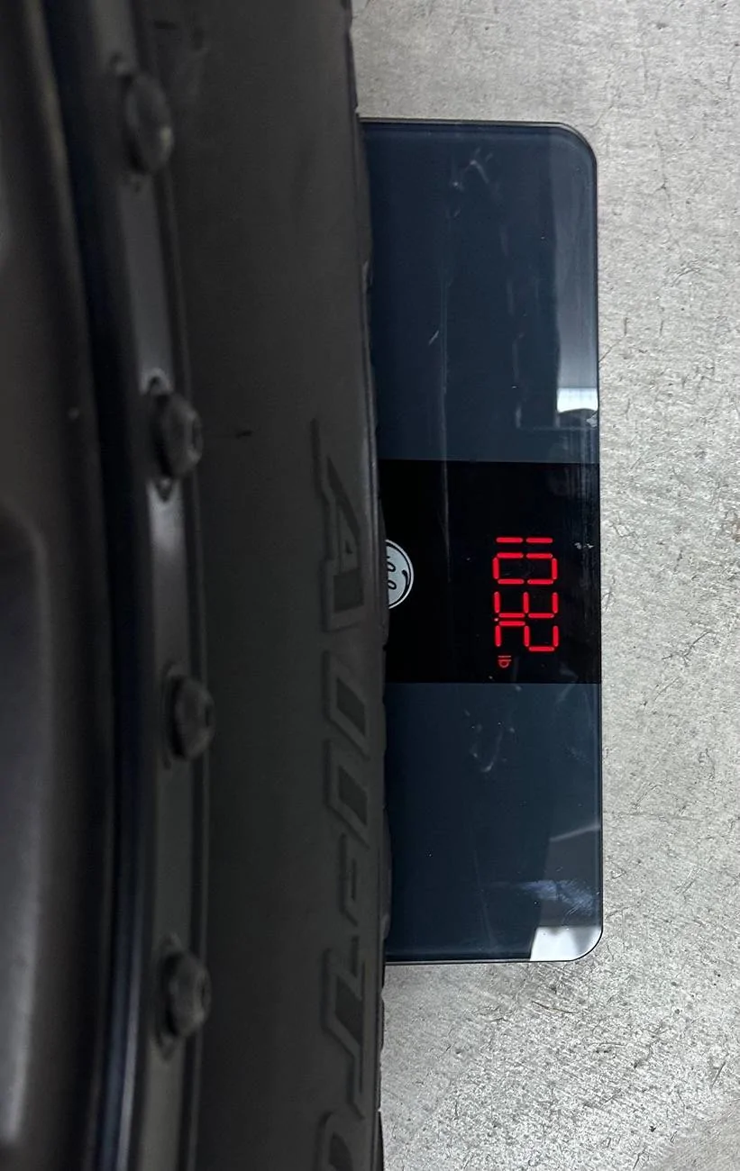

Just to add to the confusion of the XR wheel weight, here is my unofficial weight of ‘23 XR fake beadlocks when I had factory 315s. Typical cheap GE digital scale so its accuracy is unknown. The factory fake beadlocks are a bit piggish.

they get heavier when you make them NOT "fake beadlocks".
the hardware for beadlocking them is a good bit heavier than the hardware used for the beauty rings.

Curious if you mean just the attachment hardware? I have a stash of these since I grind them down offroad. 25 of the M8x1.25x30mm grade 9.8 Torx bolts for the fake beadlocks Is roughly 1 lb and 1/4oz. Even doubling that weight could only add roughly another pound per wheel to the real beadlocks. I wonder what the weight difference is between the two rings?

yes,
i don't know exactly what they weigh, but the bolts for the real beadlocks have to be longer, and have a standard head with more mass than the litttle button-head Torx bolts.
i'm also unsure how much difference there is between the rings, though the beadlock rings have to have a little more mass since they don't just lay flat on the wheel.
(FWIW, i expect my rings actually weight a tiny bit less than average because i had them etched and blasted before i mounted them to get them down to bare metal. it didn't make any sense to me to have paint on rings that i was going to rub against rocks, and weren't going to rust anyway.)

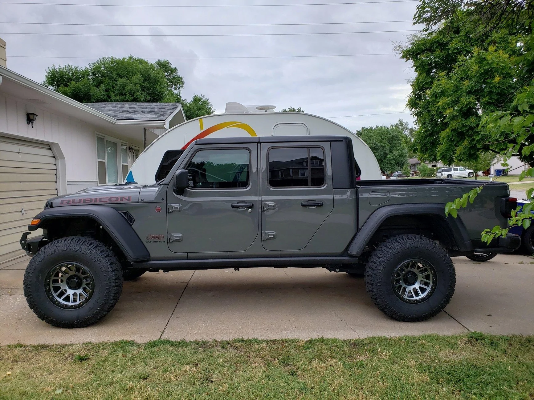

Oh I agree. I still have mine and I was going to do the AEV 2.5" dual sport lift and go with 37s on the same wheel for now. Mainly because my wife didn't want me to spend the money on new wheels at the same time. Now that I see the weight of these things, I'm gonna change them out for sure.
I am looking at the Vision Nemesis in gunmetal for my Sting-gray JLURXR. They are 17x9, -12mm with bead protection rings in plastic and changeable to different colors. The best part is that they are listed to weigh in at 24 lbs while still handling 2,400 lb load per wheel.
Here's a pic of the right color and right wheel, but wrong Jeep.

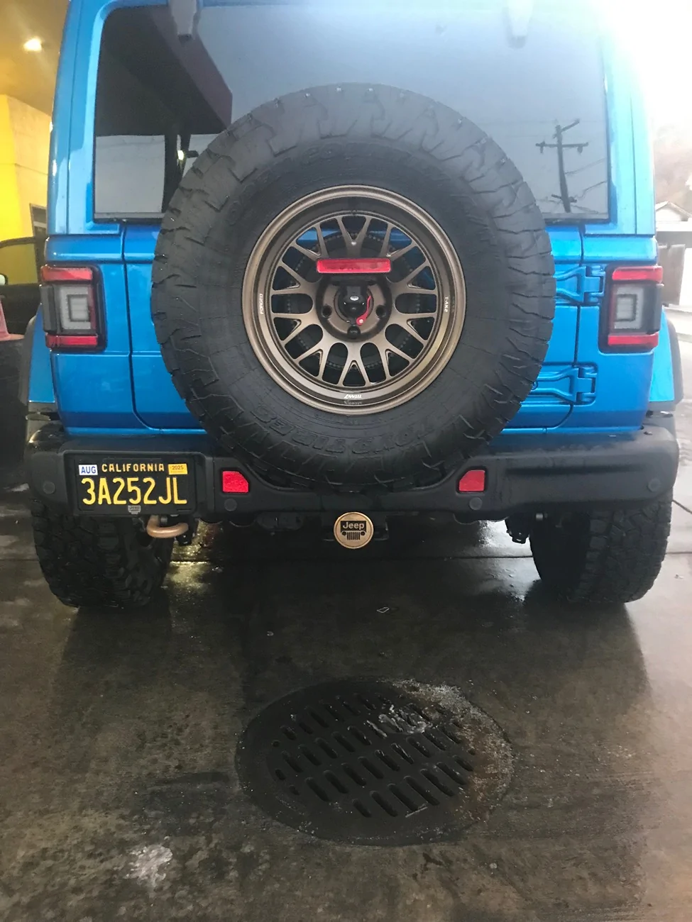

Very similar to my 8.5” -1mm T-AK2’s except no ring . They are beadgrip knurled
Jeep Wrangler JL Wheel suggestions E3D2D924-10A6-4471-9F92-E5C44F490239
Forged aren’t cheap $2500, but iirc adding the reinforcement to my Alpha was $7-800 not needed. Also less rotational mass = better Mpg, performance, braking, brake and steering wear. ….. I memorized that for my wife. 😉 to not hear “Your High Dollar Jeep !“ 😁
