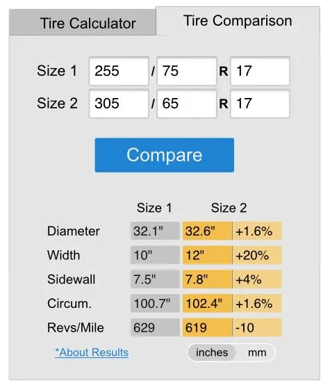

Whoops.. looks like I caused some confusion. I am referring to 305 65 17s as 33x12. It is exactly 12ā€ wide and close enough to 33 that that’s what it’s called.
Compared to stock rubi tires, they are slightly taller and 2ā€ wider (my bad - I said 3ā€). Anyway, I understand the added width also adds weight, but I assume it’s less than going from stock 33ā€ talk to 35ā€. My assumption is based on my experience and that my 33x12 perform perfectly on my Sport S with 3.45 gears. Albeit auto.
Stock rubicon tires are 285/70R17. That's about 11.2" wide, compared to a 33x12.50 which would be about the widest available 33" tire, thats not a lot different. The problem is that you gain almost nothing by going to a wider tire of equal height.
