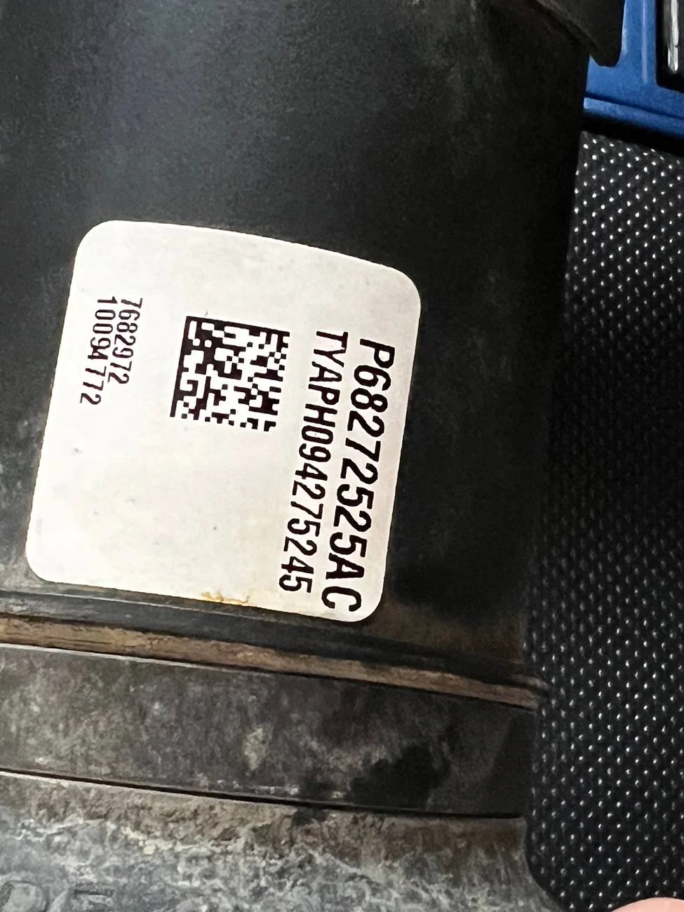

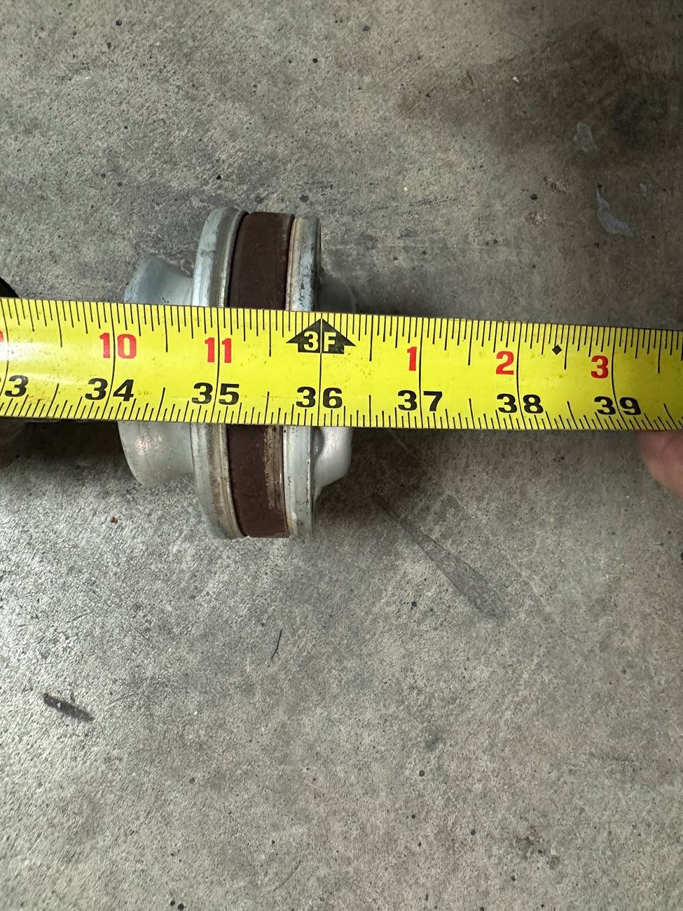

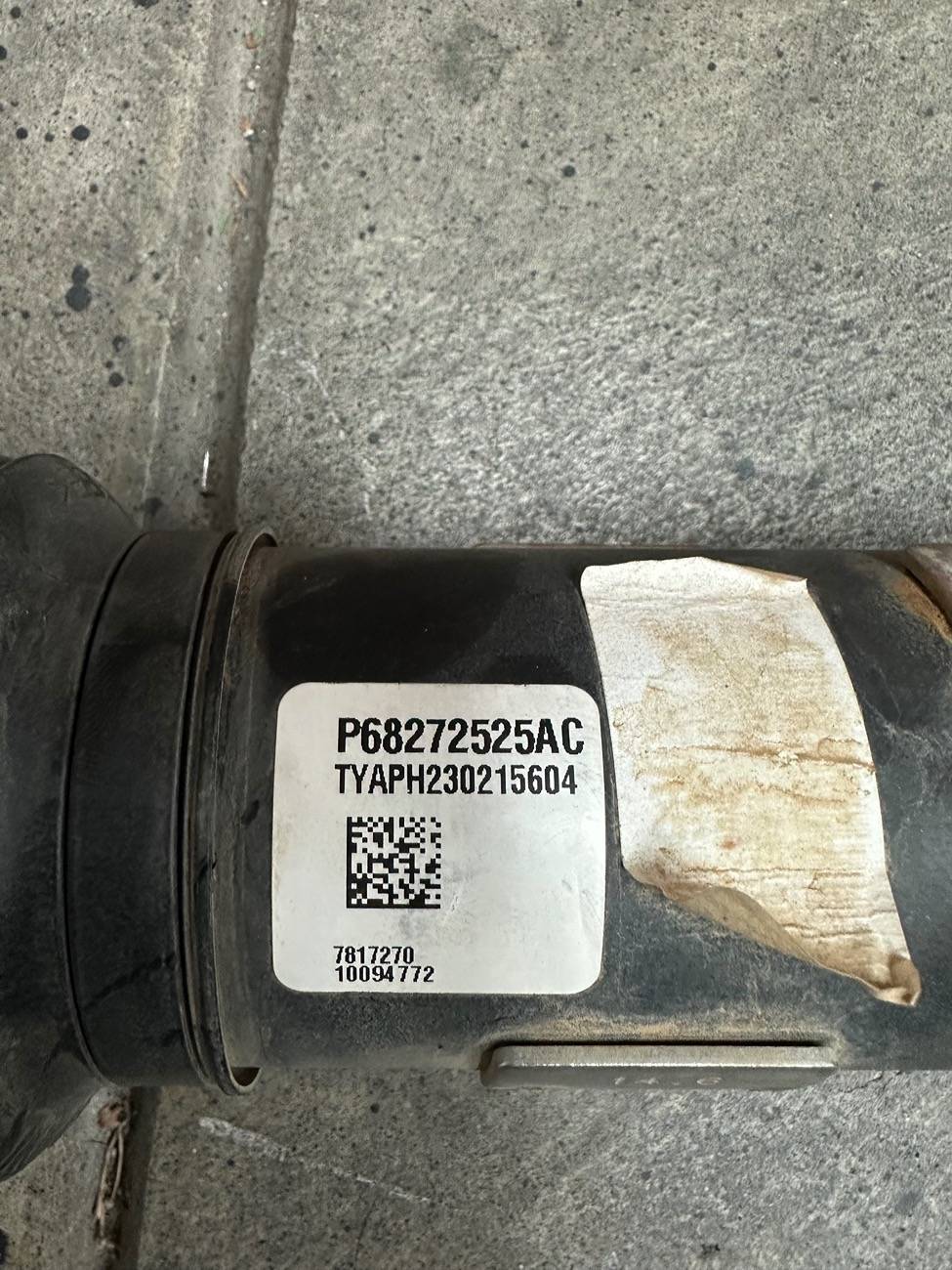

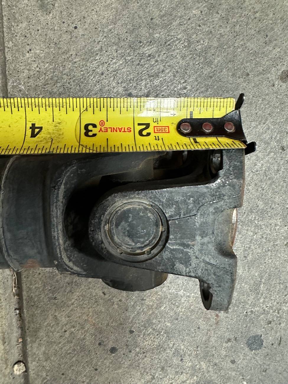

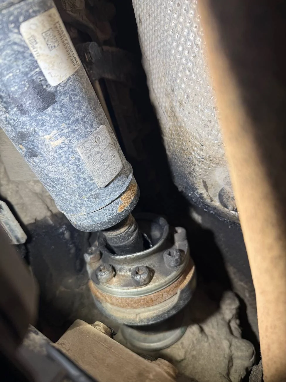

I recently replaced the front driveshaft on a 23 JLU Rubicon XR. Here’s some pics of the OEM front driveshaft compressed to as short as I could make it. The part numbers for the front driveshafts for the Dana 30 and Dana 44 appear to be different.

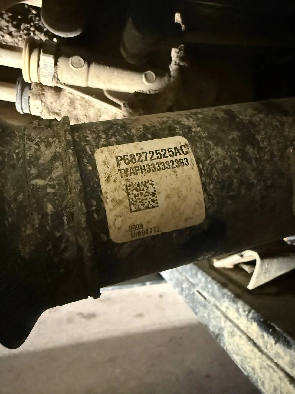

So then it’s definitely off an XR

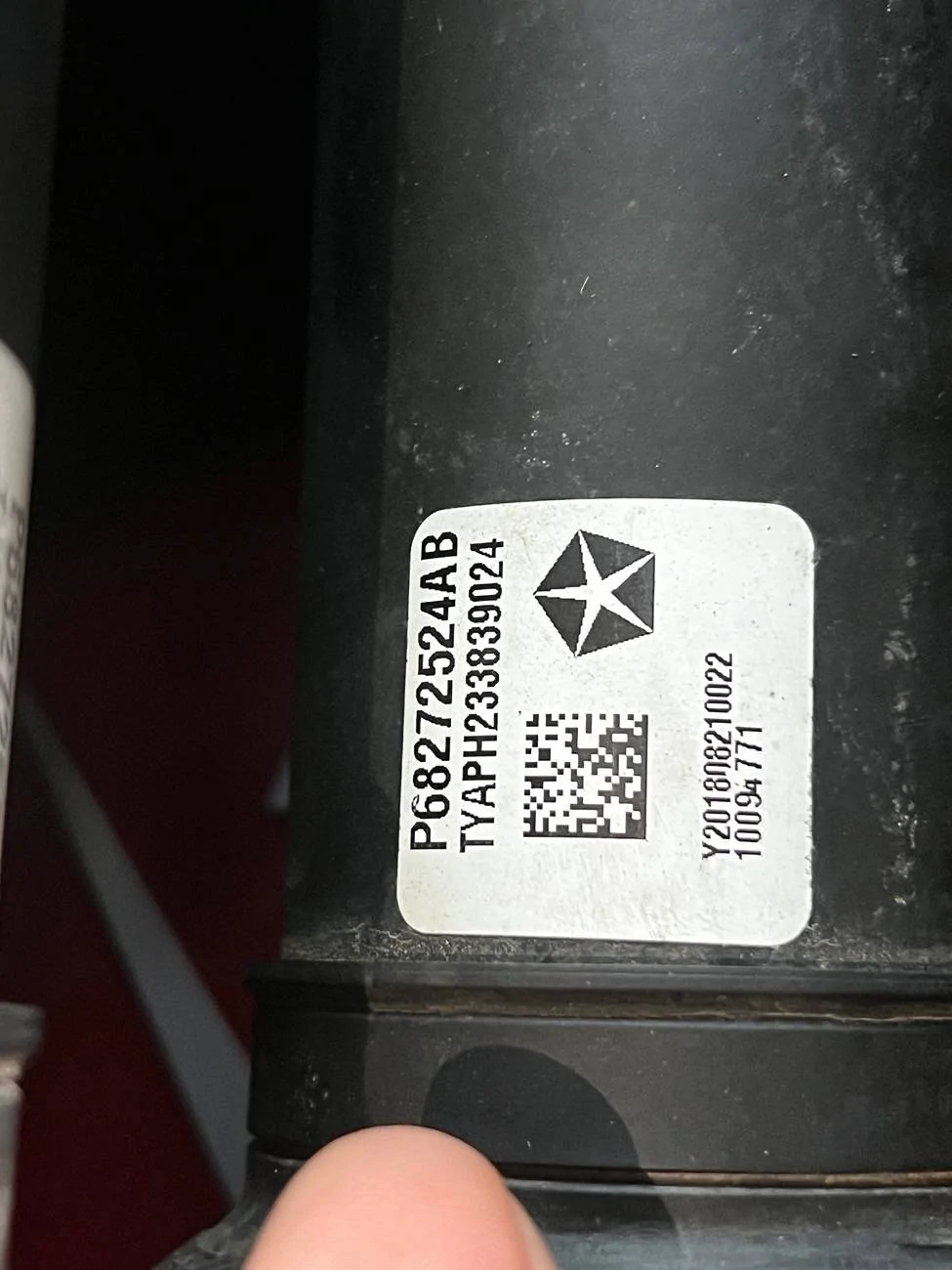

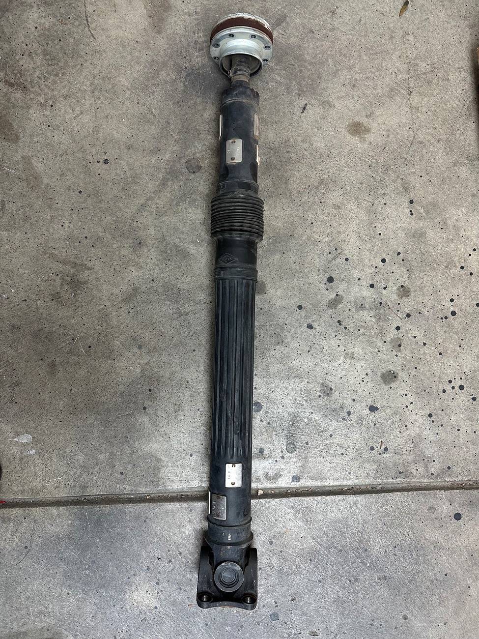

Here was my stock XR POS driveshaft
Sorry I’m still a little pissy about the whole situation.
