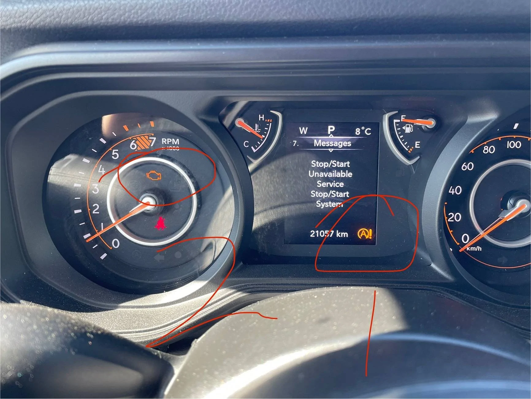

24 wrangler sport with 2.L
One is auto start symbol the other one is to check engine light
not sure what happened and how to fix them

An engine light is kind of a large window of codes. I ended up buying a cheap $25 scanner from Harbor Freight. That would really help narrow it down.

Auto start stop may indicate batteries are bad. Check them with load test.
