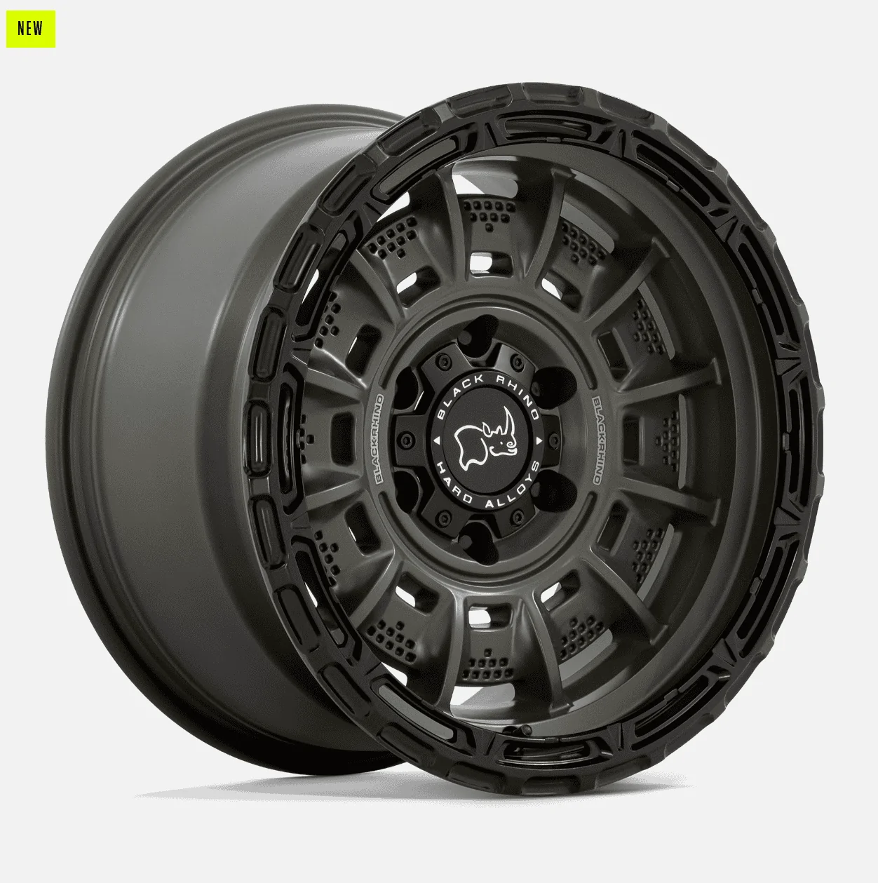

Hi all,
I am planning to upgrade to a Teraflex ST 3.5 lift, falcon sp2 3.3 on my 23 JLUR. In need of advice.
I want to get the Black Rhino Atlas, 35s with KO2
I have no idea what rim size, offset, and back spacing to go for. Also, what tire width is ideal?
https://www.blackrhinowheels.com/black-rhino-atlas
Mostly for road use.
Thank you,

That particular wheel looks like a universal fit. I would avoid it, as they are only lug centric. Plus the hub area, being drilled for 2 different patterns (10 holes) isn’t as strong as wheel hubs with five holes. You only have 2 offset choices in 17”. One is a 38, which is only slightly more offset than stock and the other is -10 which will stick out about 1.75-2”.
The factory wheels are 44 (+44). You will not find aftermarket wheels with more offset/backspace than that.
Most people do 12.50” width, but there are also 11.50” width and 315 width, which is about 13”.
3.5” lift on a Rubicon would be better suited to 37s in my opinion.

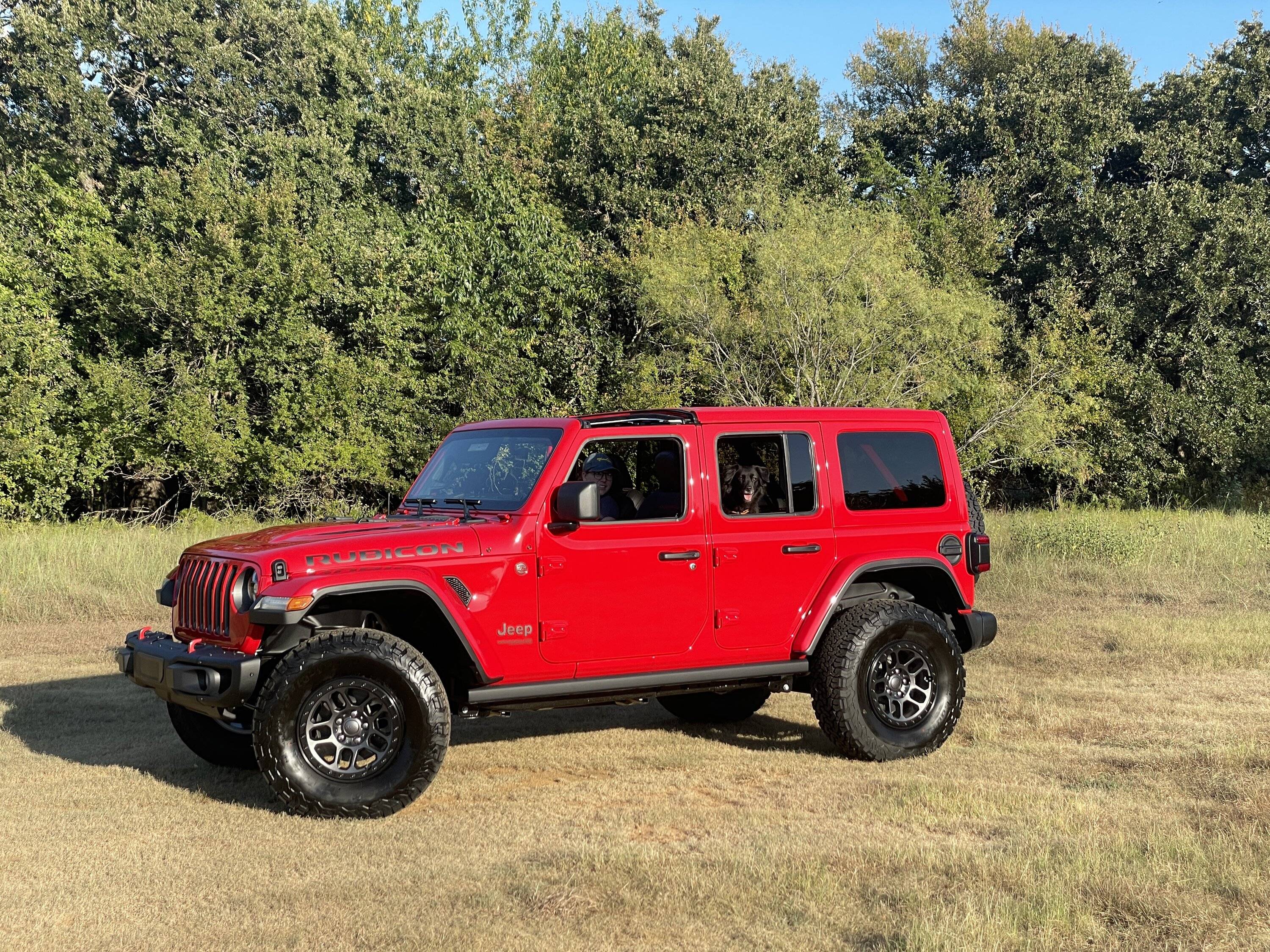

Just to help with visuals, here are some photos of my Jeep on 35” BFG KO2s with 1.5” XR lift
Jeep Wrangler JL What offset and size should I go for? 9F956041-A24D-4EA5-9853-651AF1B0D0EB
35” BFG KO2s with 3.5” Metalcloak lift
Jeep Wrangler JL What offset and size should I go for? 1D5BA475-D68D-457E-93C5-C7C4A38CAE0D

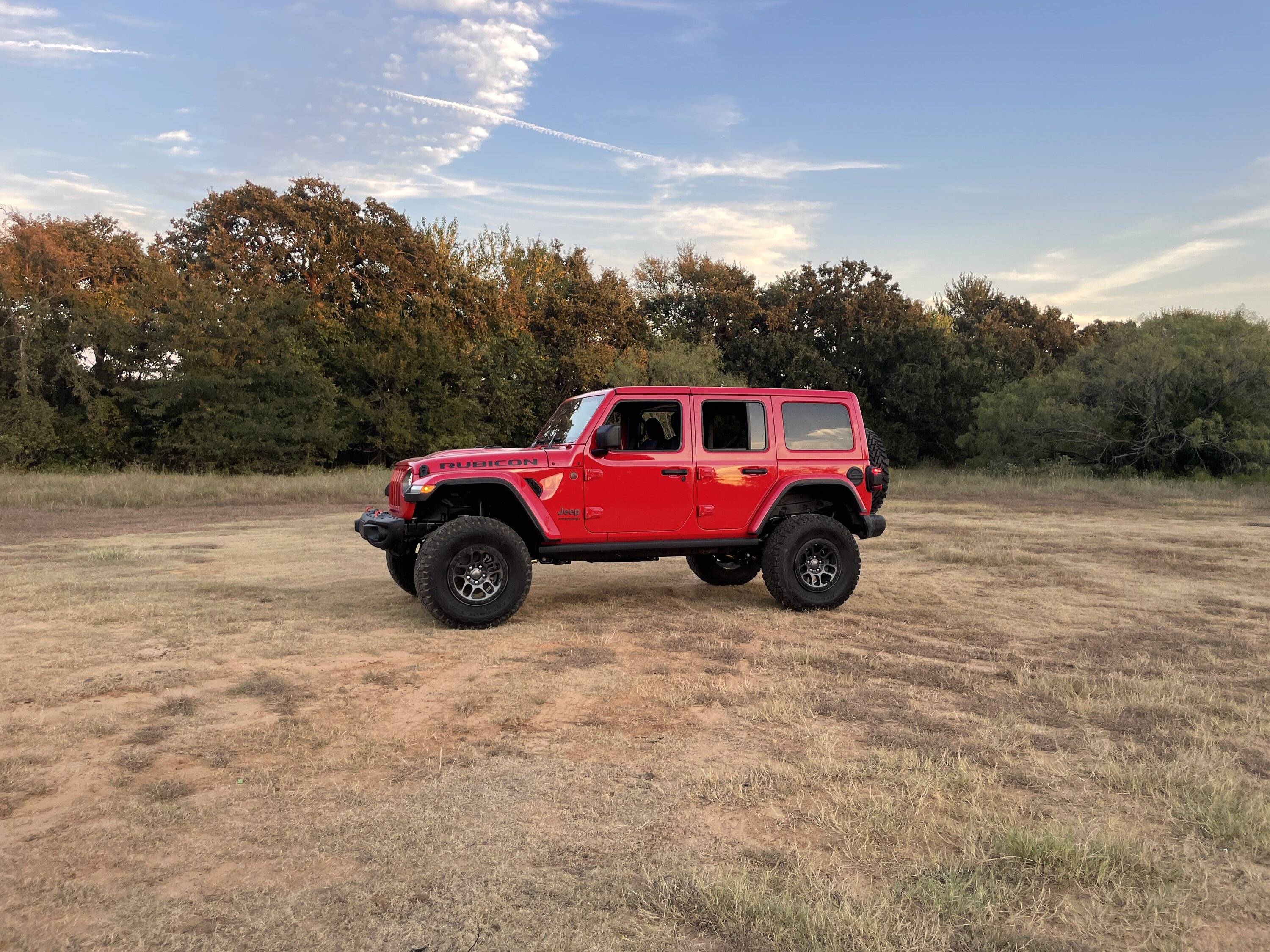

37” Yokohama G003s and 3.5”
Jeep Wrangler JL What offset and size should I go for? E97A9209-EE69-4D68-9A8B-D3D36EBC14A8
37” Yokos and 3.5” lift with ”overlanding load out”
Jeep Wrangler JL What offset and size should I go for? 9CE8856D-A364-47DE-A0C3-9A8890EEB003

Pic confirms what the others said above, 3.5" lift is too much for 35s on a Rubicon.
Definitely a nice looking Jeep regardless...

this model might not hub centric to jeep spec.. pick something else form Black Rhino there are other similar looking ones with the exact bore size - Hub Bore (mm) = 71.50
