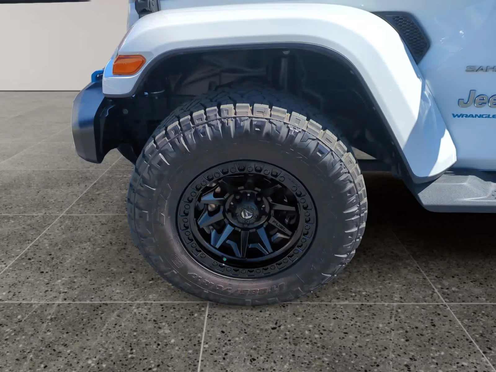

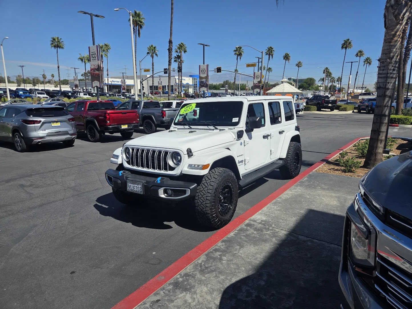

Curious on this stance and sizing, could anyone offer up some help on what offset / rim size / tire size is this? I believe these are 33"
Looks like stock height as well for Sahara (No lift?) Thoughts?

You should have gotten some closer pictures. Hard to tell. But if I had to guess, 17x9, with zero offset.
Tires are likely 285/70/17, which are 33s. Look to be Nitto Ridge Grapplers.
I would agree, no lift.

Nailed it! I like the stance but would prob get a less intense rim design.
I do like the Fuel D579 Vector 17x9 but I think it only comes in a -12 offset? Unless you move up to 18"

Yeah, with no lift, zero is about it. In my opinion +10, +12, and +18, somewhere in that area, look best with no lift. But zero gives you some growing room.

Yeah, the Vector is a classic, but it seems to be getting phased out. Low selection there.
I’d say Method is about as popular as it gets for an aftermarket wheel on Wranglers right now.
