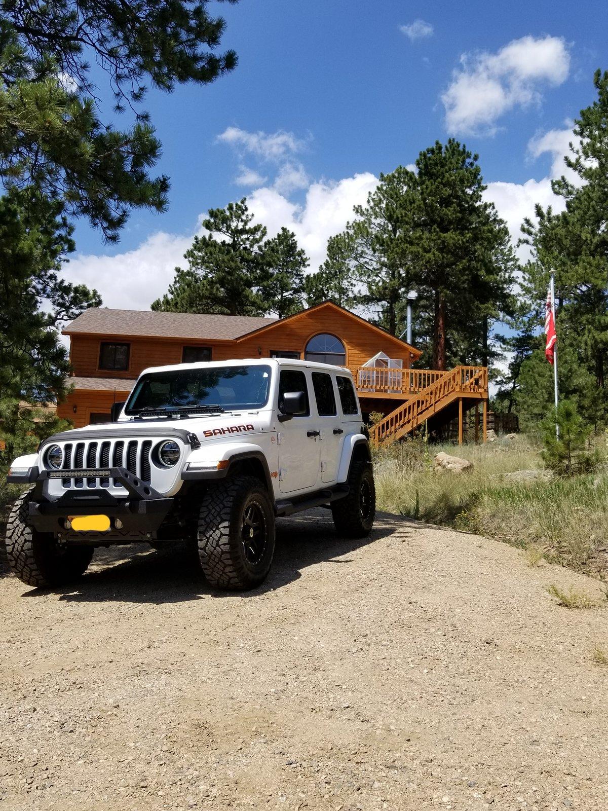

Try this...
www.rimsntires.com/specspro.jsp
Put your OEM +44.25 offset and rims size specs on the left and put your new set up specs on the right of this calculator. It will tell you some more. Then search the forums for pics close to what you want to get a real visual.
What you are trying to avoid is having your wheels look too small once you lift.
I have a Rubicon express 2 inch lift with 33 inch tires... 295/70/17.

What is the offset and back spacing on your rims
