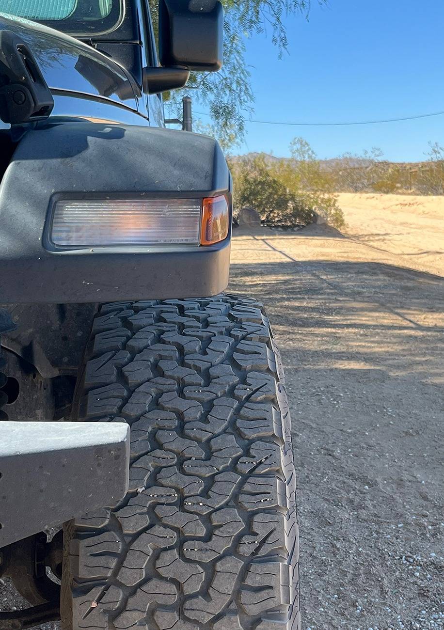

Hi and welcome to another offset thread. I've been math-ing this for days & can't nail it, please help.
This is our 18 Sport S w/ 315 KO2s 2.5 RC lift & Black Rhino Convoy wheels, 17x8.5 4.04 BS and -18mm offset. This fender measures 12" from the body at its widest front point.
Jeep Wrangler JL What offset wheel to match this stance? IMG_1031

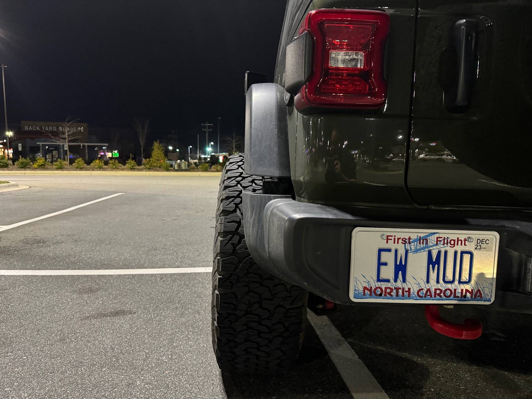

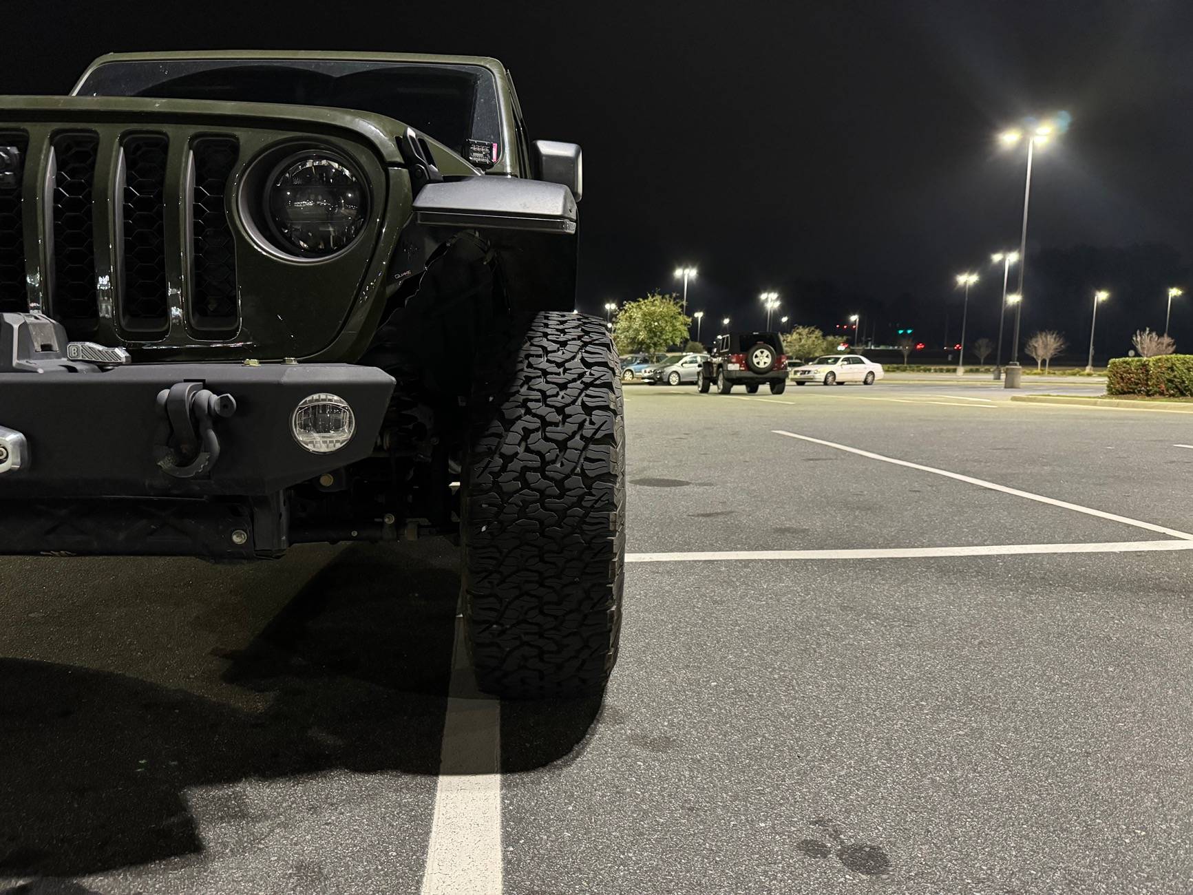

The Willys I believe is gonna have the wider Rubi axles now won’t it. If so this is 9” wheel with -12mm offset 315 tires on a 23 Rubicon
Jeep Wrangler JL What offset wheel to match this stance? IMG_3886
Jeep Wrangler JL What offset wheel to match this stance? IMG_3887

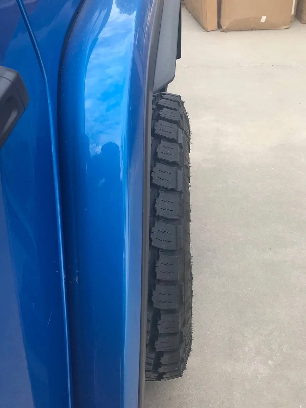

If wide axles and Rubi flares 12.50’s tread is even with stock 7.5” 44mm
Jeep Wrangler JL What offset wheel to match this stance? A0FB99DE-17E6-4FD5-A8EA-5C2D26E463BA

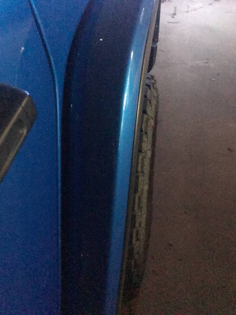

with 8.5” -1 mm even with XR extensions
Jeep Wrangler JL What offset wheel to match this stance? 8742FCBA-BF4C-46B4-B2B0-3B9E93D369E2
-12 mm is ~ 1/2” more poke
