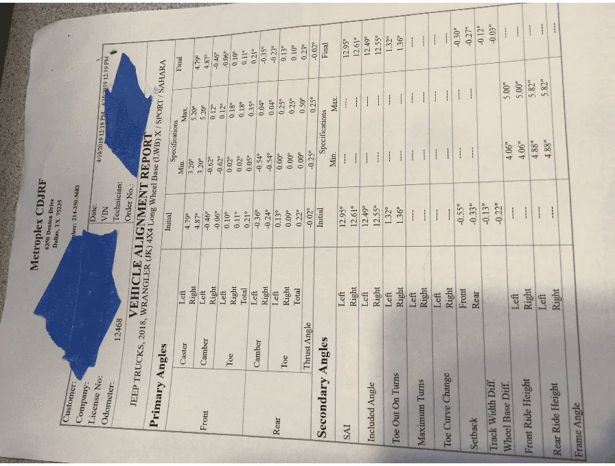

.10 left and .11 right. I had my alignment done 3 days ago to help fix the wandering steering. They did not change my toe adjustment however whatever it is they changed made a huge improvement.

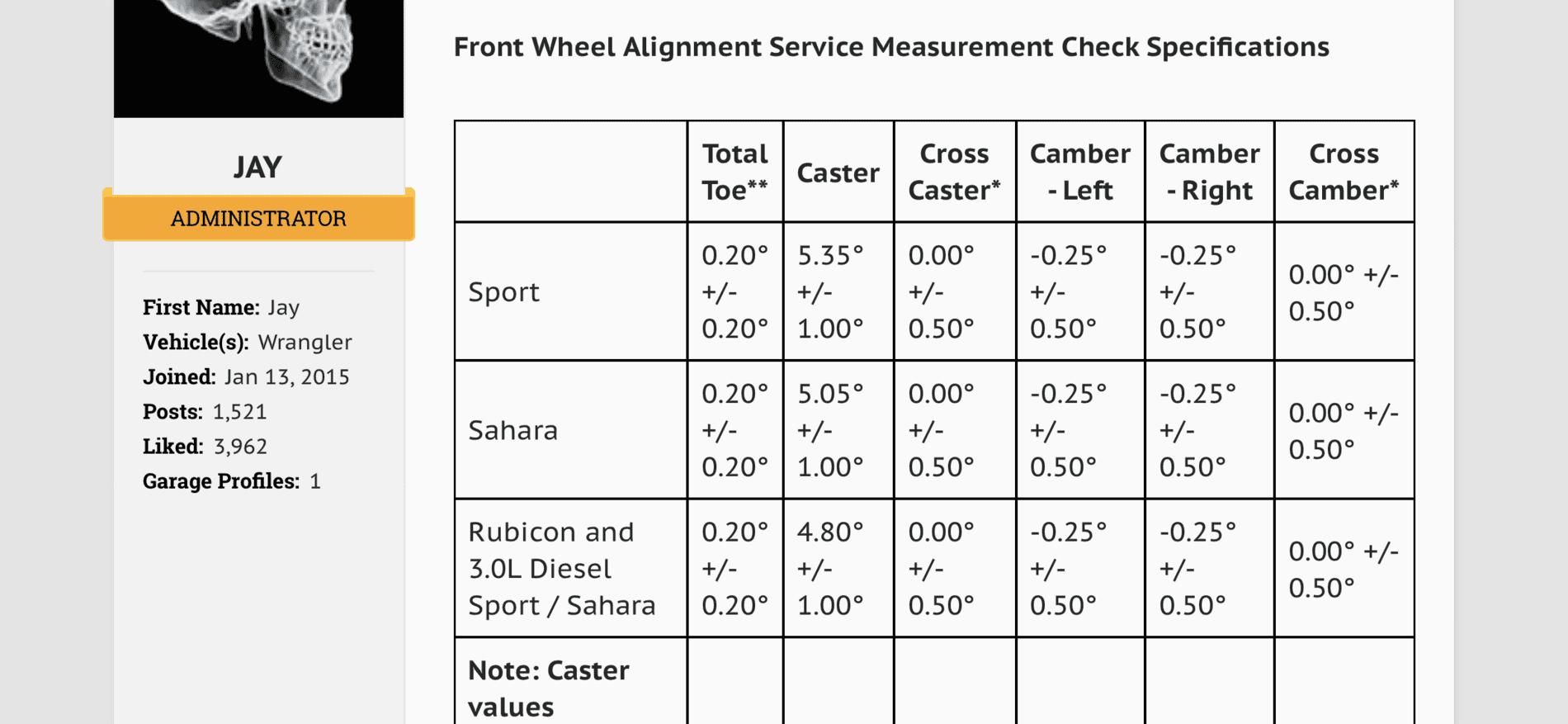

Have you seen this? I’m on a Mopar lift, my toe is within the spec shown here, and my castor is at 6.5 degree. My Jeep tracks straight as an arrow. You may want to get adjustable lcas so you can adjust more castor than those fixed control arms can give you.
I did see that. Are those the alignment specs for the Mopar lift or stock? Do you have adjustable control arms or the Mopar fixed length ones that I do? Do you know your exact toe setting? Do you haves picture of the alignment sheet by any chance?

These are my values, before and after. Hopefully you can read it, being sideways and all lol. I just noticed they used JK specs. *sigh* It still drives noticeably better though.
