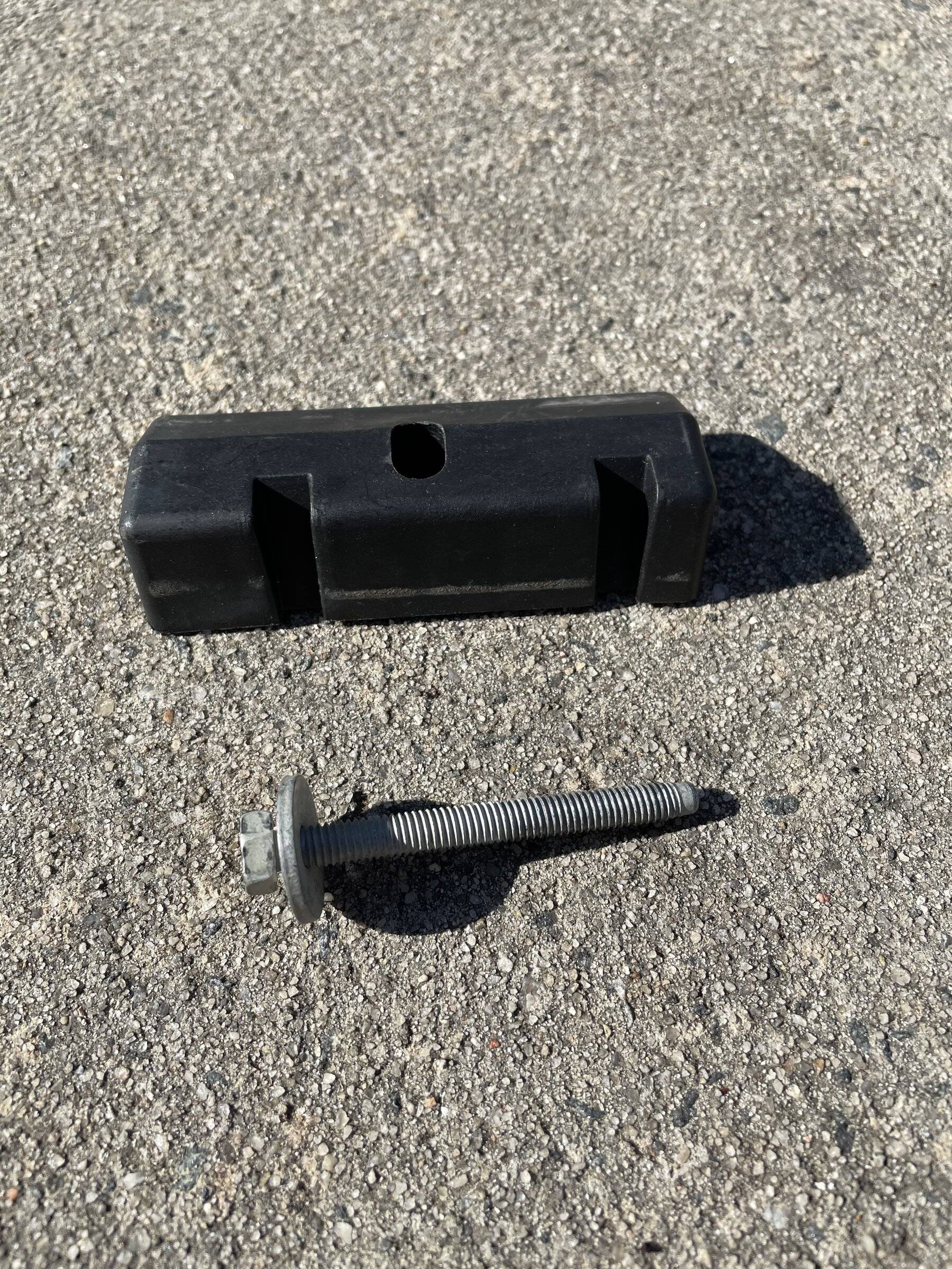

I took my 2019 JLU 3.6 into the dealer to have the auxiliary battery replaced. When I got home I found this mysterious black plastic part and a bolt sitting on the engine. Any idea what it is or where it goes? I’d rather not go back to the dealer for more A+ work.

That’s it! Thanks!

When they send that email asking for you to give them 10s on the survey, send back that picture and explain things. Report back.

I absolutely will. I had an issue where the ESS does not work and always says ”not available, battery charging.” They replaced the auxiliary battery under warranty but the issue persists. Such a waste of time.

Did they check the main battery too? I'd go back and get that replaced, and have them fix their screw up while doing the main.

If he does that they will make him a 7 am appt 2 weeks out and ask him to leave it all day.
I wish that was a joke... I've experienced that myself. Took 3 appointments and almost 2 months to get my batteries replaced.
If they cared at all, they'd get him in right away to fix their mistake.

Update: I went back to the dealer Saturday morning when they opened without an appointment. I nicely let them know I wanted the battery replaced and that they should have done it the first time. As you guys said I had to leave it all day, but they did give me Ram loaner. Good news is I have 2 new batteries and everything is working again.
