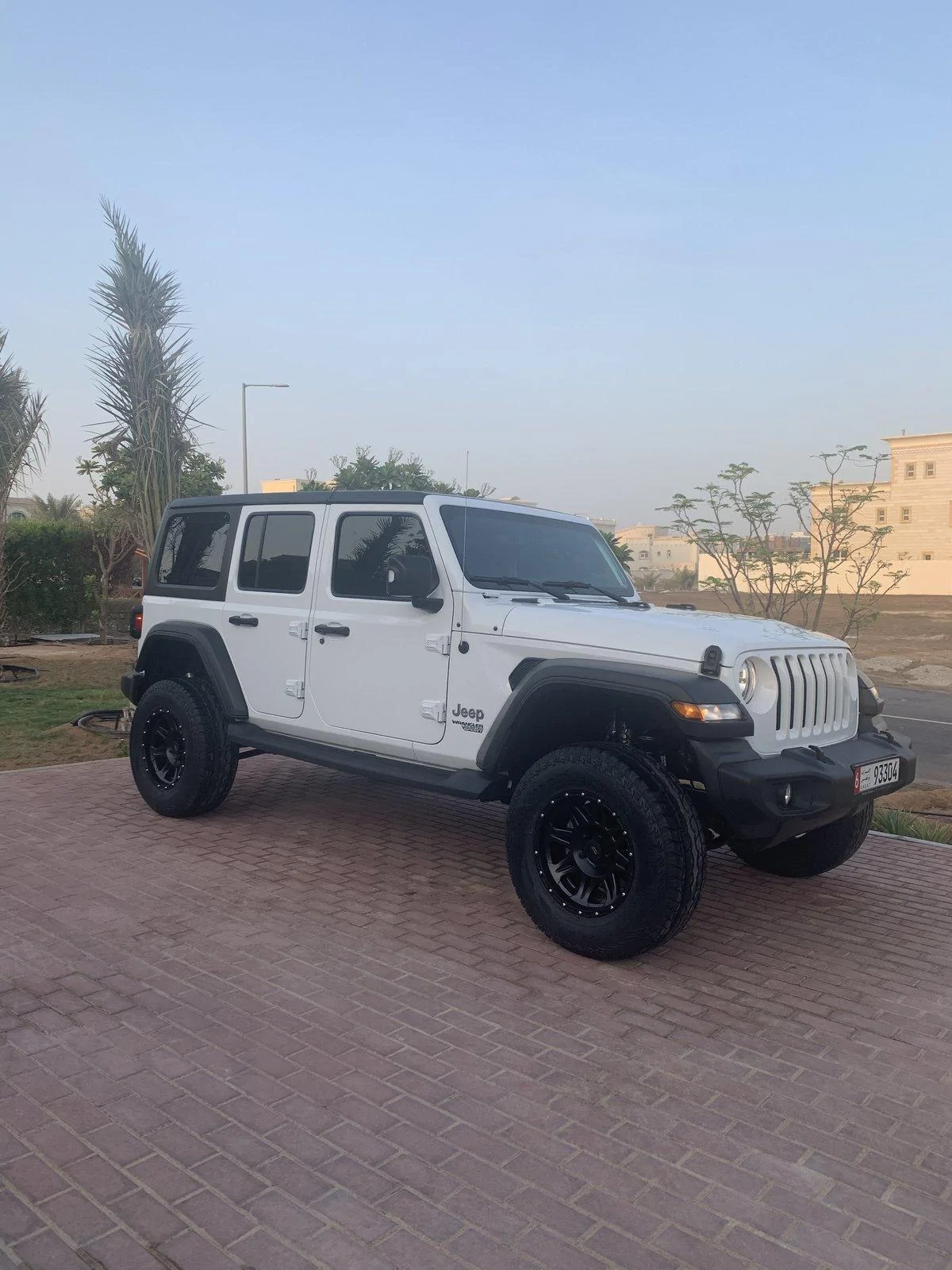

Got any pics of your jeep? Im interested to see what sport on mopar lift and 33s looks like.
Well I just want to use the 8th gear
And heres a photo of my wrangler
