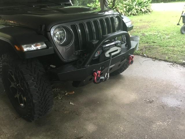

I’ve had steel cable winches on UTVs that had a Kong ball stop that I would just snug up to the rollers. This is my first synthetic line and this just seems destined to make noise:

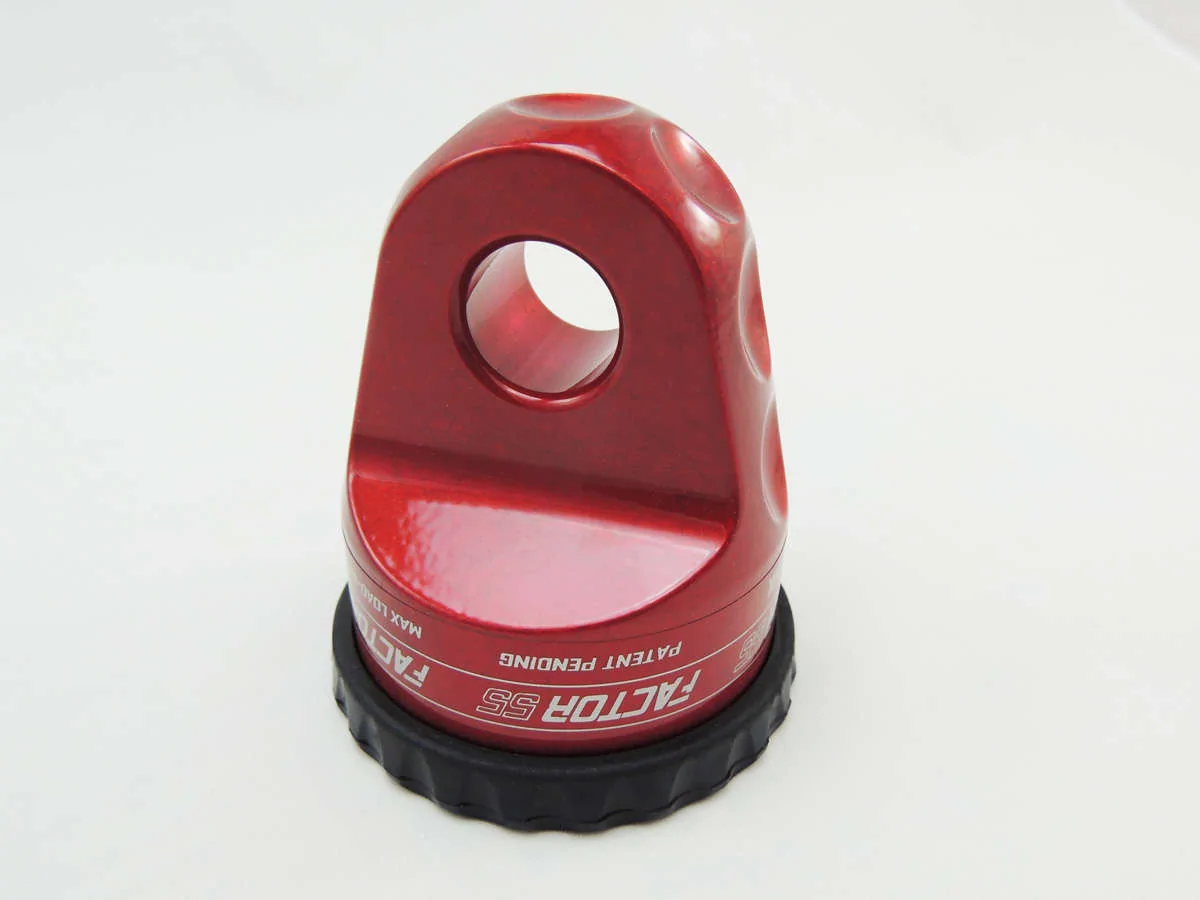

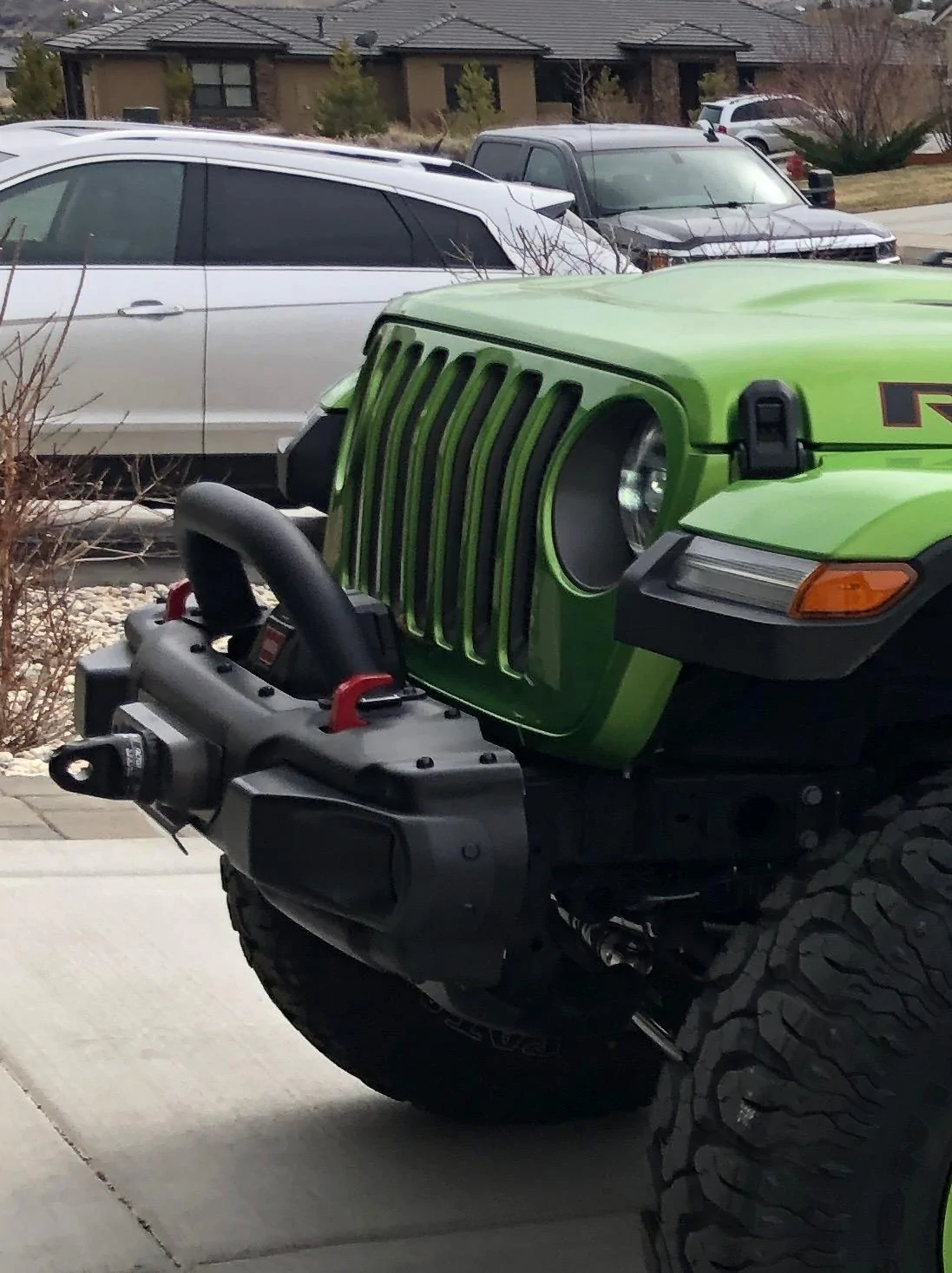

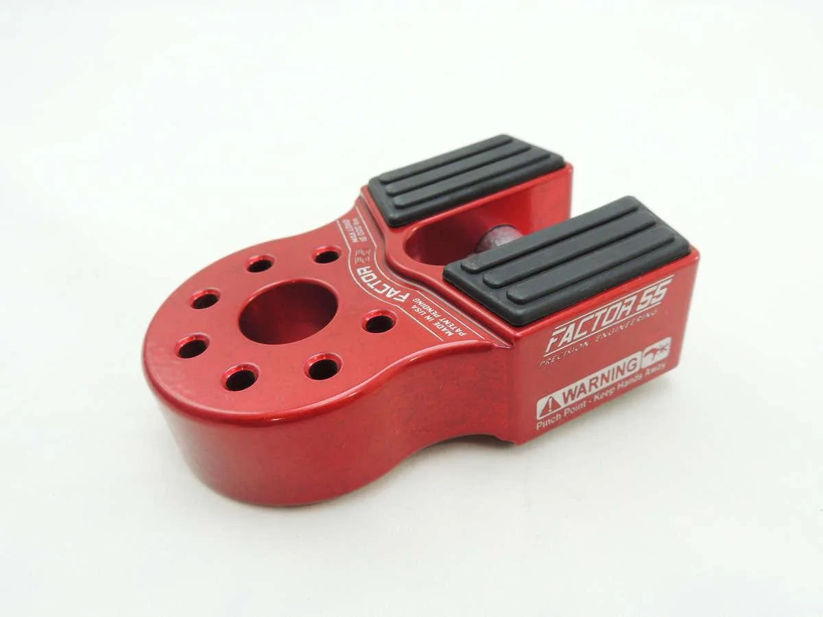

Get something like the Factor 55 Prolink or Flatlink. They have a rubber surface on the back side so you can snug the link up to the fairlead. No rattles, holds the line under some tension, and you're not risking the hook moving around and scratching your bumper.
I use the Prolink for now, but thinking about going with the Flatlink in the future. Not a huge fan on how far the Prolink sticks out.
