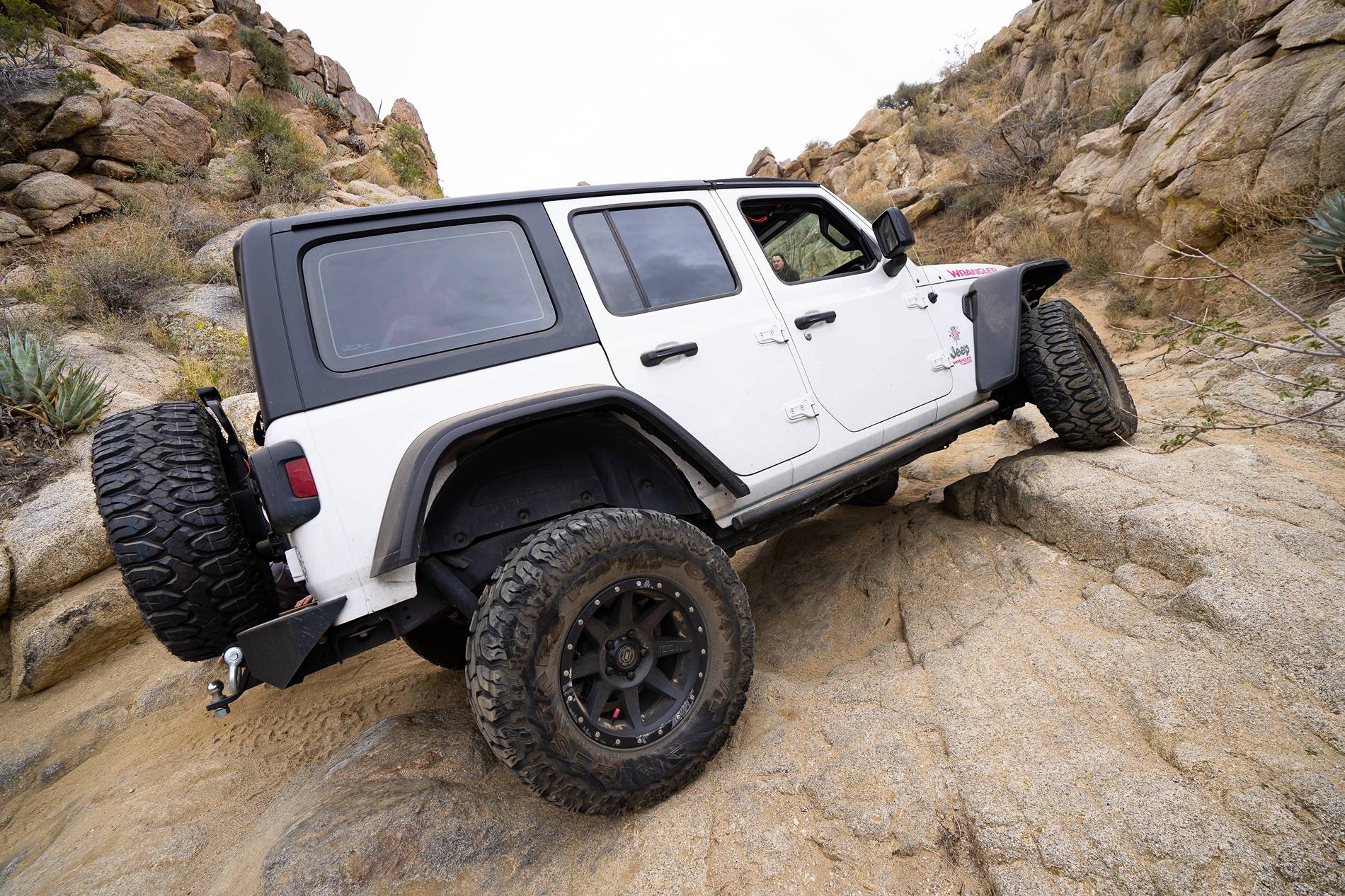

Highly recommend spacers if you’re only looking to go 1.5” AND you are satisfied with the ride quality you have now. You can get away with pretty much whatever brand you want, doesn’t have to be crazy expensive it’s just a spacer. Quite a few spacer kits will have longer sway bar links as well. You can use those all day without issue and research other ones with disconnect options at a later time. .
Don’t let anyone ever tell you spacers are trash, they do exactly what they’re intended to do. My wife rolled on spacers and 35s for almost 6 years before trading it in.
Jeep Wrangler JL What do I need to make this work?? IMG_6041
