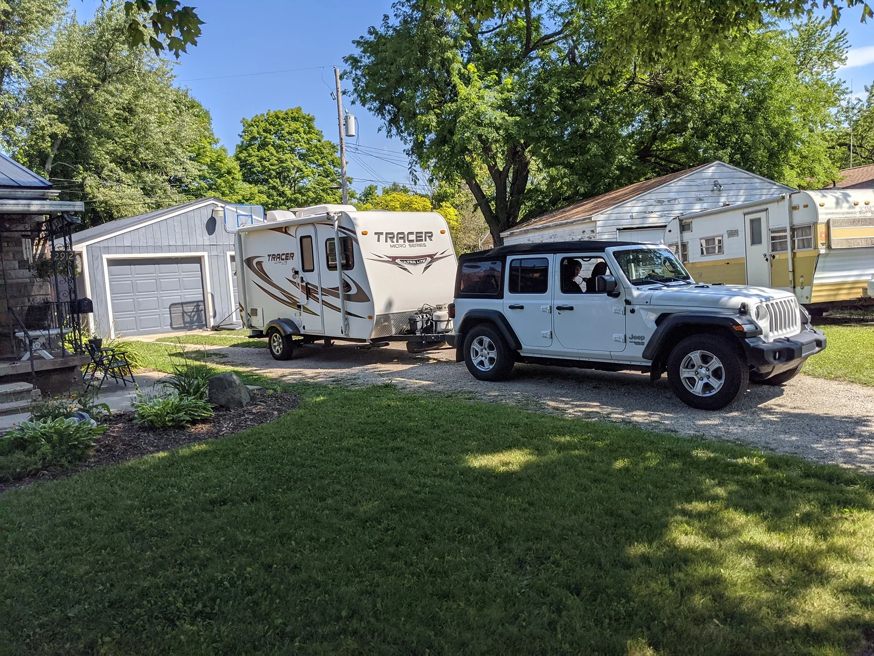

I used a wd hitch for this little guy. The jeep is so light and suspension so soft I thought it best.

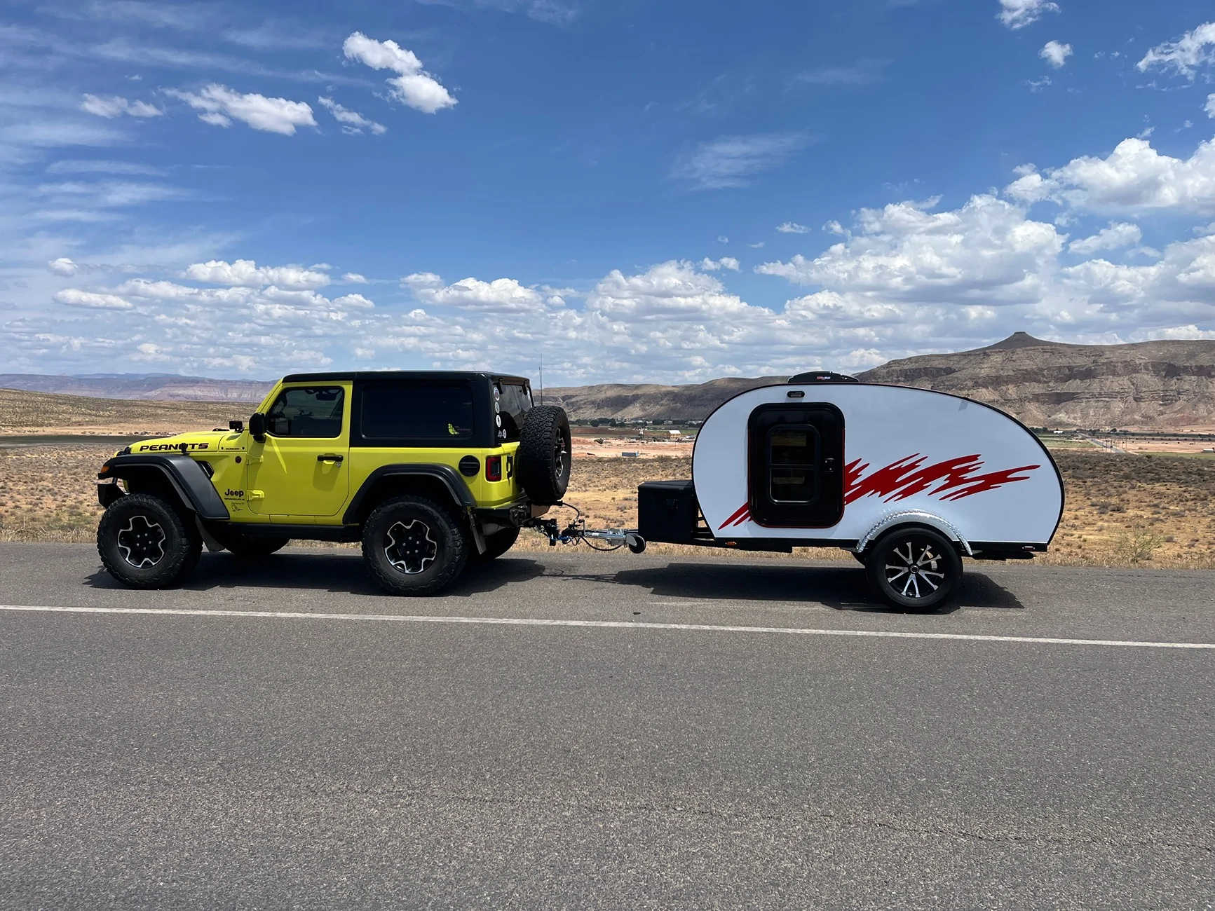

I tow this tear drop, it is around 1100lbs limit for the 2dr jeep is 2000lbs, tows great does not even know it is there

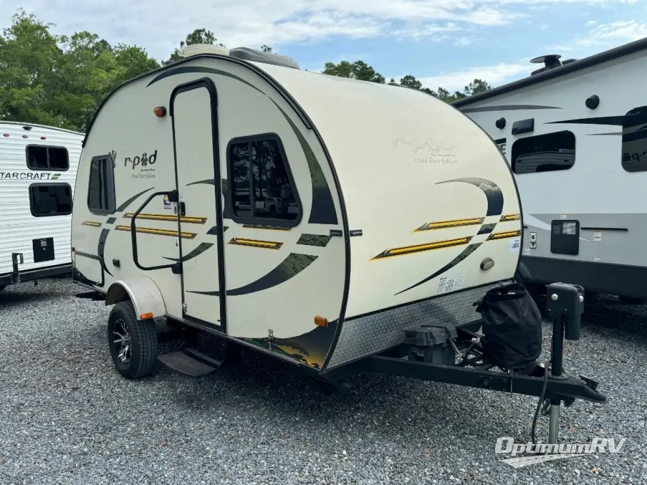

I would get a WD hitch for the R-Pod. The Jeep is not great at towing, at all. The WD hitch will make it much safer
That's relative.
Weight distribution hitches help spread the load from trailer ball to further up the frame towards the front of the jeep and the rear of the trailer.
In a perfect world.
On the jeep, the hitch is mounted to a cross member and not to the frame rails themselves. This is why our vehicles are only rated as low as they are. Even the mighty 392 is rated for 350/3500 (non floating axle).
In our case, a WD hitch just literally adds another 30lbs to the tongue load and doesn't spread the additional load forward on our frame. What it does do is enhance the twisting forces on the rear cross member.
Admittedly, it does add some additional contact points between the jeep and the trailer, but that's about it.
