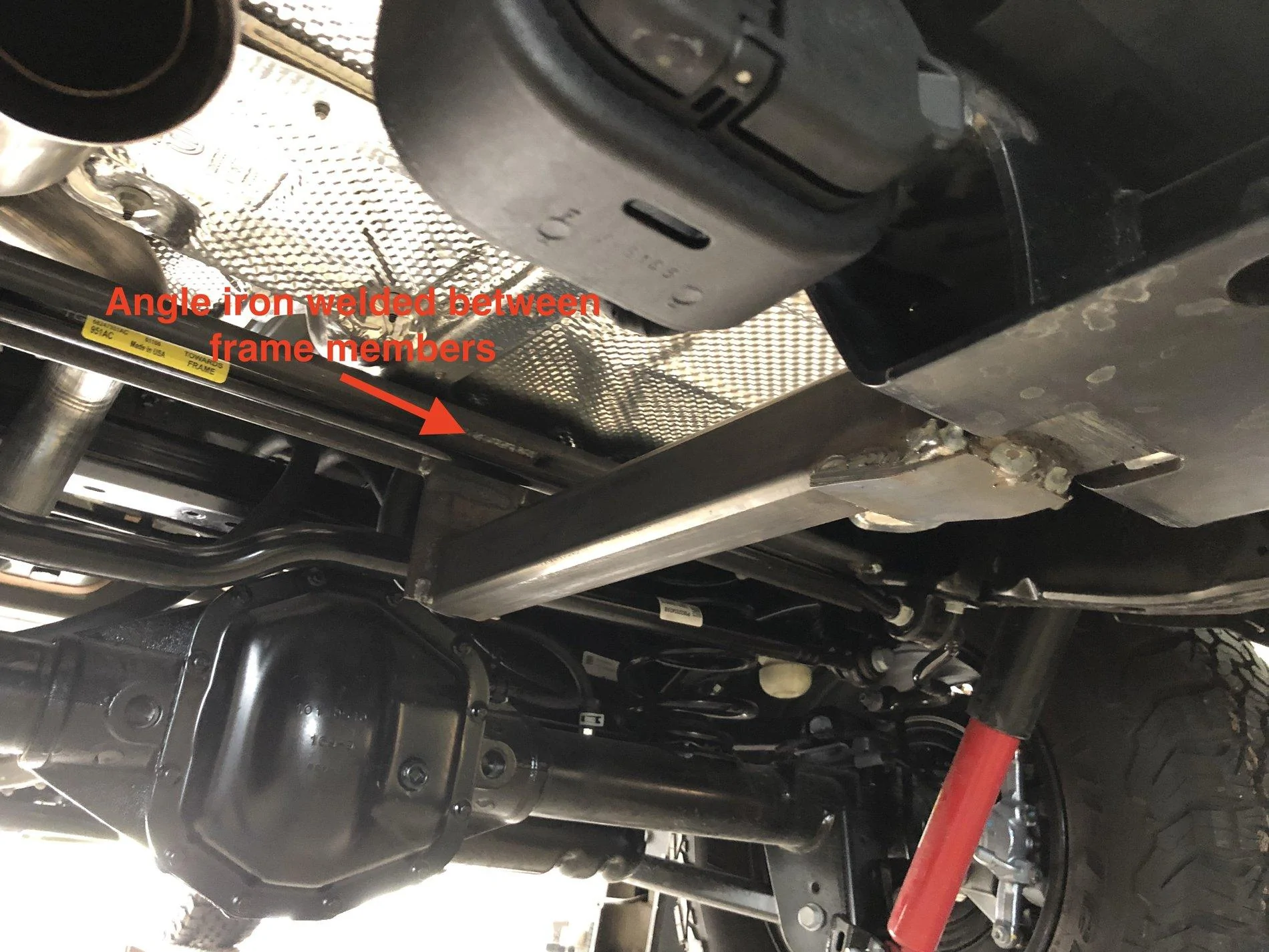

I use an Eaz-Lift WD hitch. It has a separate anti-sway bar that can be used even if you don't use the WD bars. (My hitch as two anti-sway bars.) A properly set up WD hitch will level the rig and put some weight back onto the steering axle where it is needed to avoid understeer. I would recommend having a professional install the hitch, although it can be done DIY.
A WD hitch adds fore/aft torque to the receiver. This is the weak point of the Jeep stock receiver. I have had my hitch receiver strengthened to allow the WD aspect of the hitch to work without twisting the stock receiver. On my JK the hitch shop bent the strengthening steel tubing around the muffler, but in my JL I used a muffler delete from Magnaflow to provide more clearance from the ground. Either way works fine.
