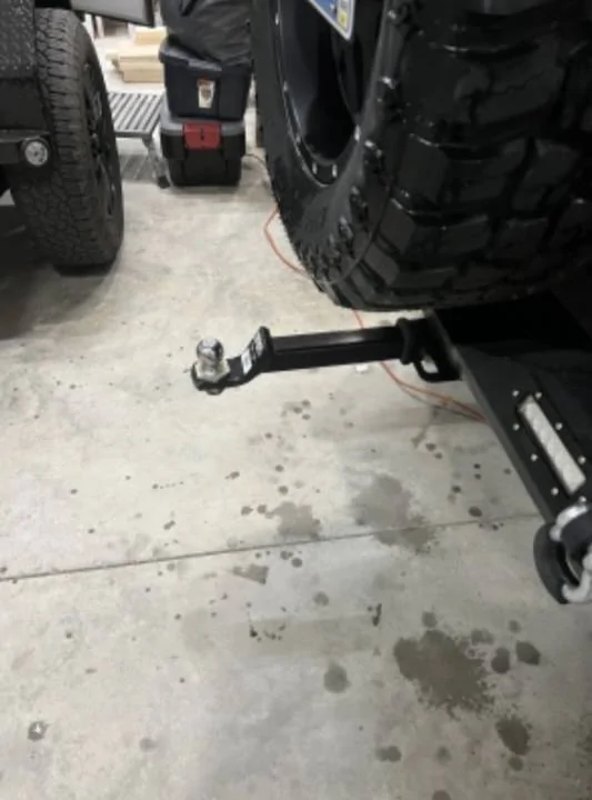

I tried attaching a standard hitch ball to my tow hitch to determine if I need a new one in addition to the wiring harness, and I quickly realized that a standard length ball arm does not fit under the spare.
Maybe it's the phrasing, but there's oodles of space under my spare tire for an adjustable ball hitch.
Jeep Wrangler JL Spare Tire & Tow Hitches Adj-ball-hitch

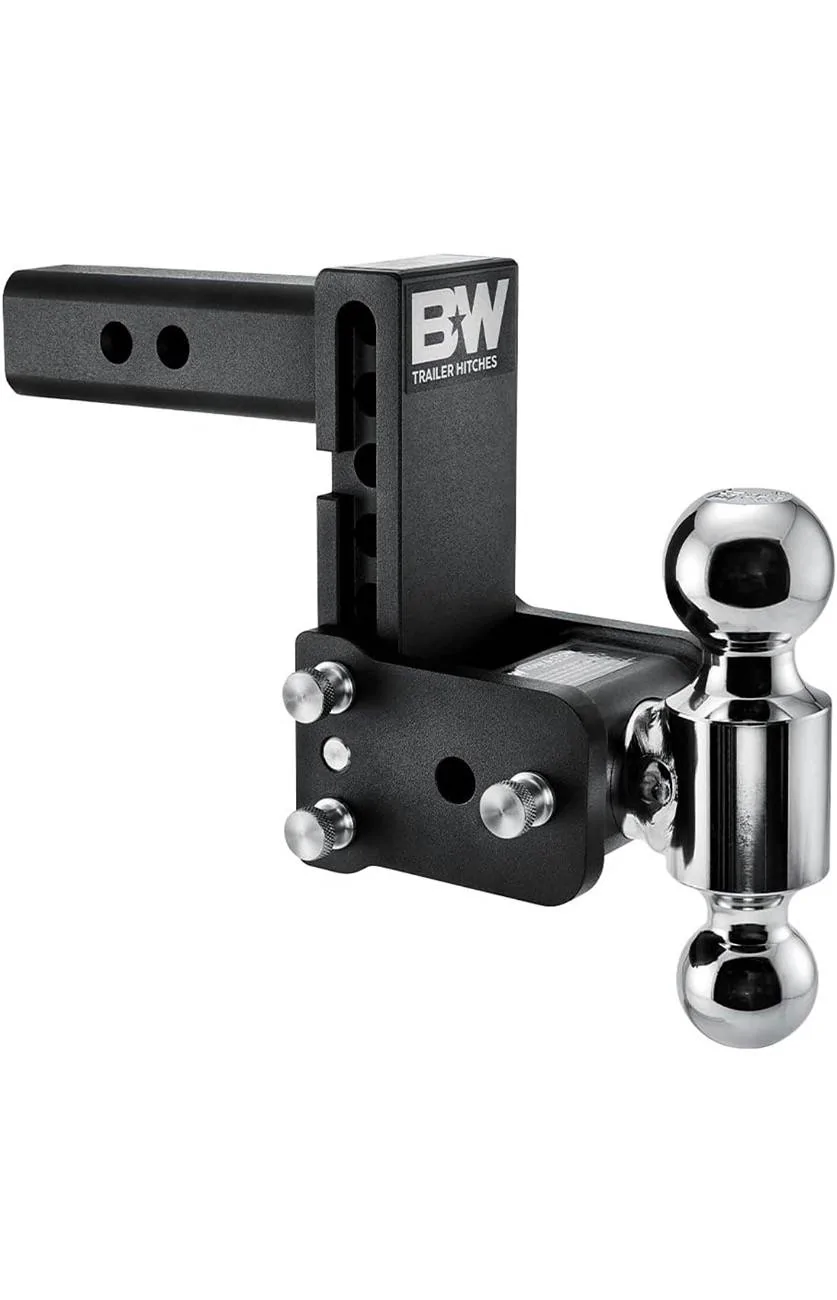

MaybeRubi
Dec 1, 2023
171
185
Wyoming USA
'24 JLU Willys 3.6 Auto Anvil
And with the height adjustability pictured above, you have the ability to use different trailers with differing heights (and still have them flat).

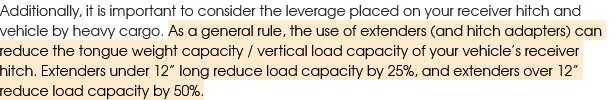

I’ve been towing trailers for a few decades now and no way would I run a hitch extension like that on a Wrangler. It will put a tremendous amount of rotational stress on the hitch.
Vince, even with the relatively low weights she stated in her post?

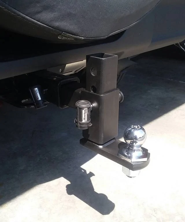

What brand hitch do you have? My '21 JLUR came with a towing package. I use this 2" drop, 2" ball in my hitch without trouble
Jeep Wrangler JL Spare Tire & Tow Hitches IMG_4923

I've cleared Rubicon tires without trouble. You will want at least a couple inches of drop, which should allow you to clear easily. Measure what you're towing and compare with your hitch height.
You halve the rating on a 12" extension. From Curt mfg-

Wick, it’s always a good day when I learn something new. Thank you!🙂
