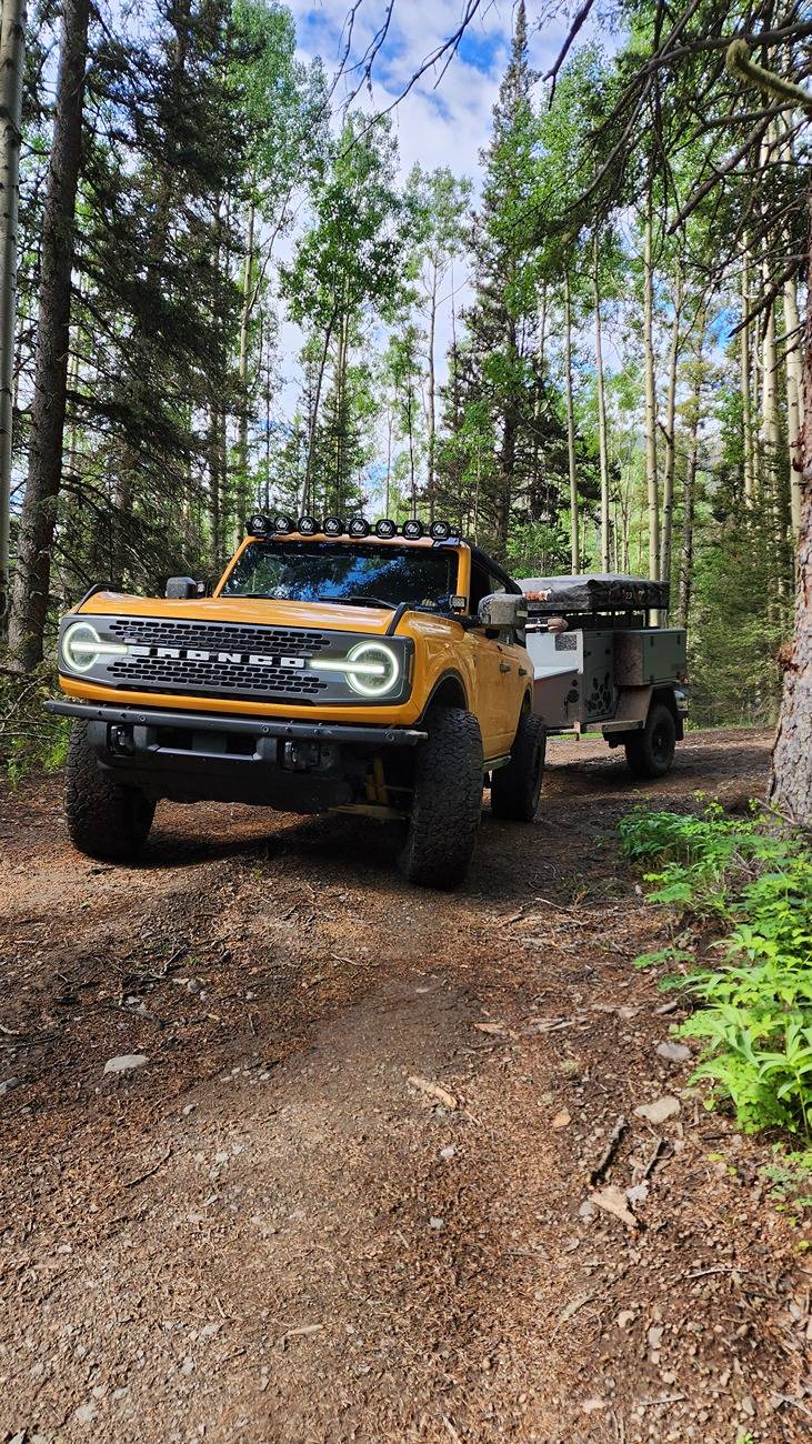

Now I realize my trailer is meant for this, but I've been at some pretty extreme angles and find it hard to believe you'd have to worry about the spare tire being in the way before you have to worry about the trailer hitch popping off the ball, assuming you don't have a fully articulating hitch. I will say that I have to have a 2 inch drop in order to be able to get the hitch attached, because of the spare.
Pic is of the bronco towing, but we have zero issues with either vehicle.

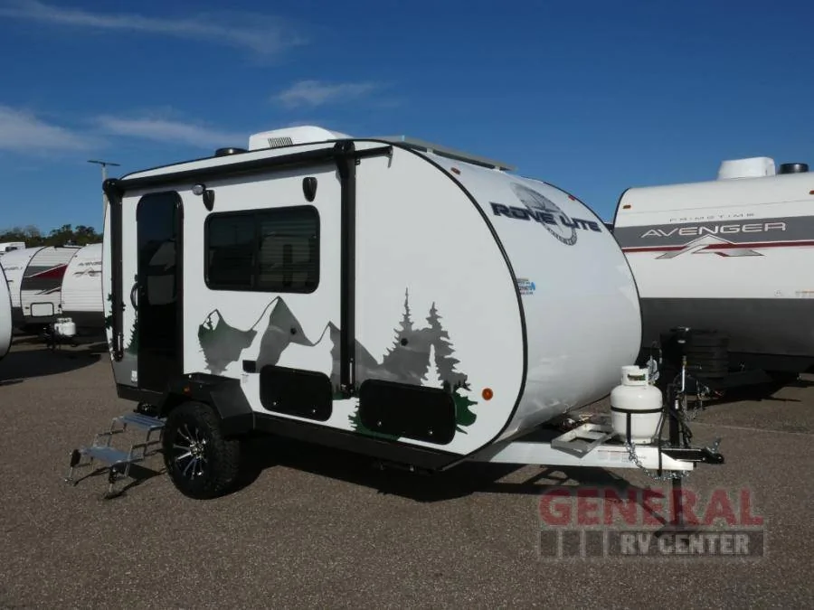

From my experience/observation, the most likely occurrence of this issue is trailers with a very shallow a-frame coupler installed and a shallow (wide angle) front A-frame tongue. This forces all tongue mounted equipment very close to the coupler. This severly limits both turning and "V" style maneuvers. For example the Rove Lite here:
Jeep Wrangler JL Do you remove your Jeep's spare tire while towing? 1723759212435-6
Either swapping to a coupler which is longer (maybe a collar lock style?), or retrofitting a single beam tongue may be options.

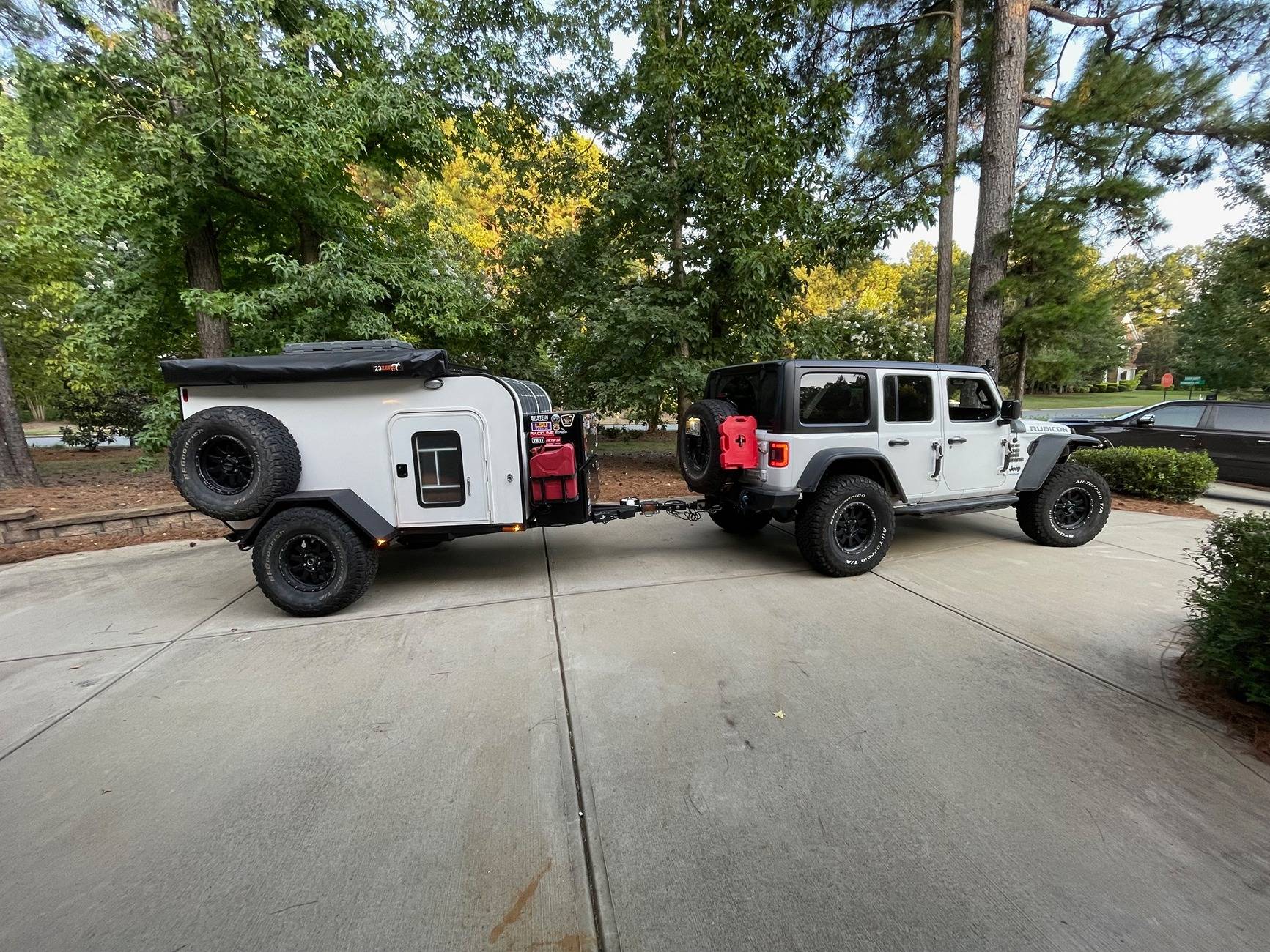

Well, since we're showing off trailers. :)
Obviously any manufactured trailer would need several modifications to gain this much, but here's my home build. I've since raised the spare, but I'd assume at least a 45 degree incline would clear. I can 90 degree jack knife it as well.

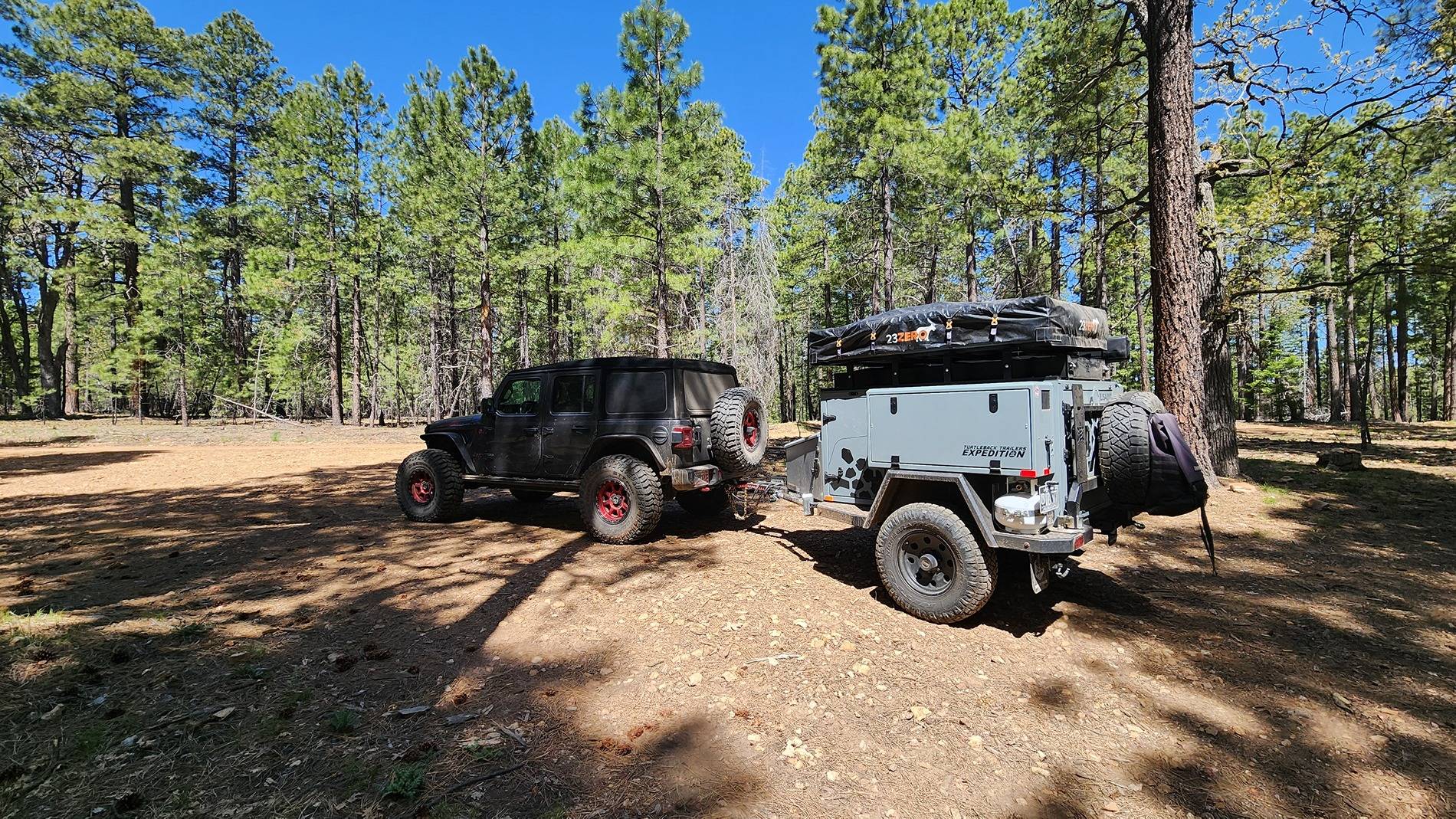

I guess the side profile really is the best view for this discussion. Here's my closest photo for that angle. I have way less space than you between my spare and the tongue box on the trailer, but I hand to admit its just not a concern for me. I'm assuming I'm doing some pretty intense stuff to have to worry about that.
