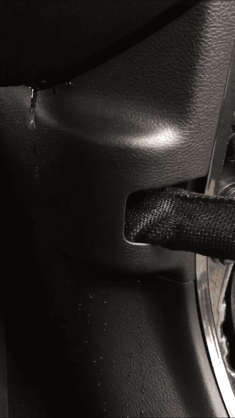

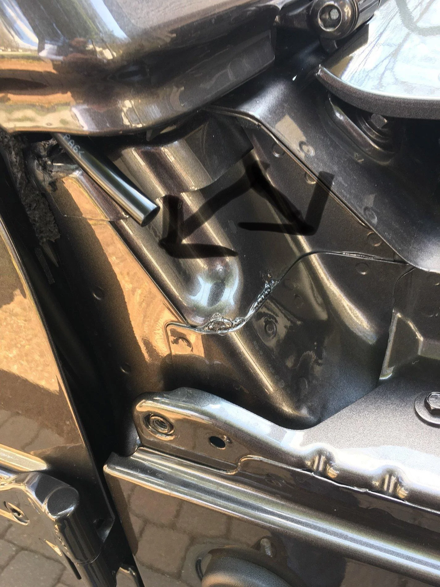

Just to report back. After several all day rains, my Jeep is still bone dry. Siliconing the areas I marked below has indeed stopped the leak that was causing my passenger floor to be wet after rains.
Hope it helps someone else.
