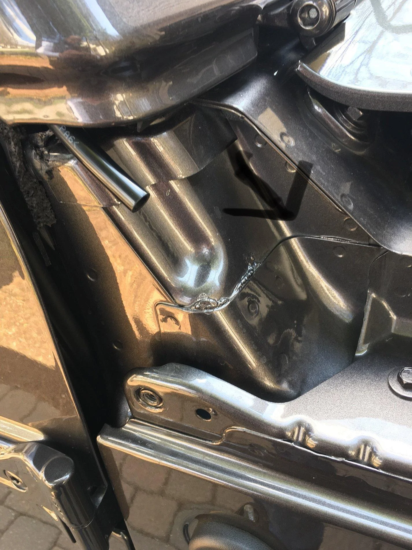

So this is where the gutter ends. It doesn’t run to the vehicle bottom. Seems like a stupid place to drain. A few more cents and they coulda run a hose all the way down, which is what I might do.
Is it possible to replace it with a clear tube so you an see when there's a blockage eventually?
I guess you probably could if you folded the windshield down. The drain tube is tucked into the a-pillar and is visible if u look for it

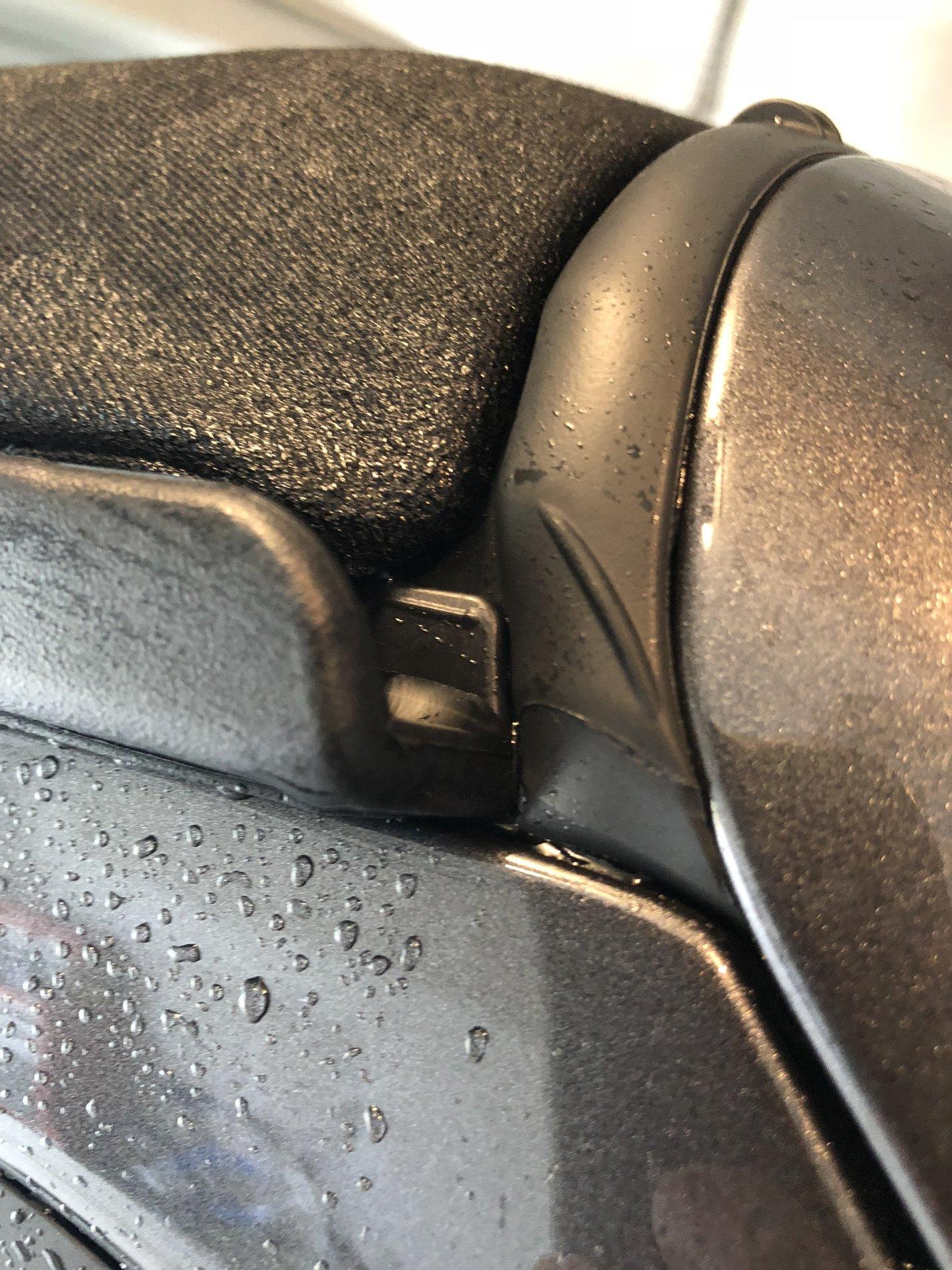

Today was the first time my 2018 Jeep Wrangler Sahara JLU has been driven in the rain. I pulled into my garage and opened the door and a small stream of water came pouring down into the Jeep and all over me. I had this issue with my 2013 JKU. I thought with new premium soft top this would be resolved. If they would have just extended the track above the door it would have fix it. Any one else notice this?
Mine does the same thing. Its a wrangler....It is what it is !

Is the drivers side drain the same? I will probably silicon both sides, even if I don't have the leak...preventive maintenance!
How do you remove the side cowl to get to the drain (as shown)?
I would imagine they’re the same, but I have no issue with my driver side so I didn’t check. The side cowl is super easy. Just remove the two bolts on the piece itself and then the two on the piece under the windshield on the hood. The cowl then just slides out.

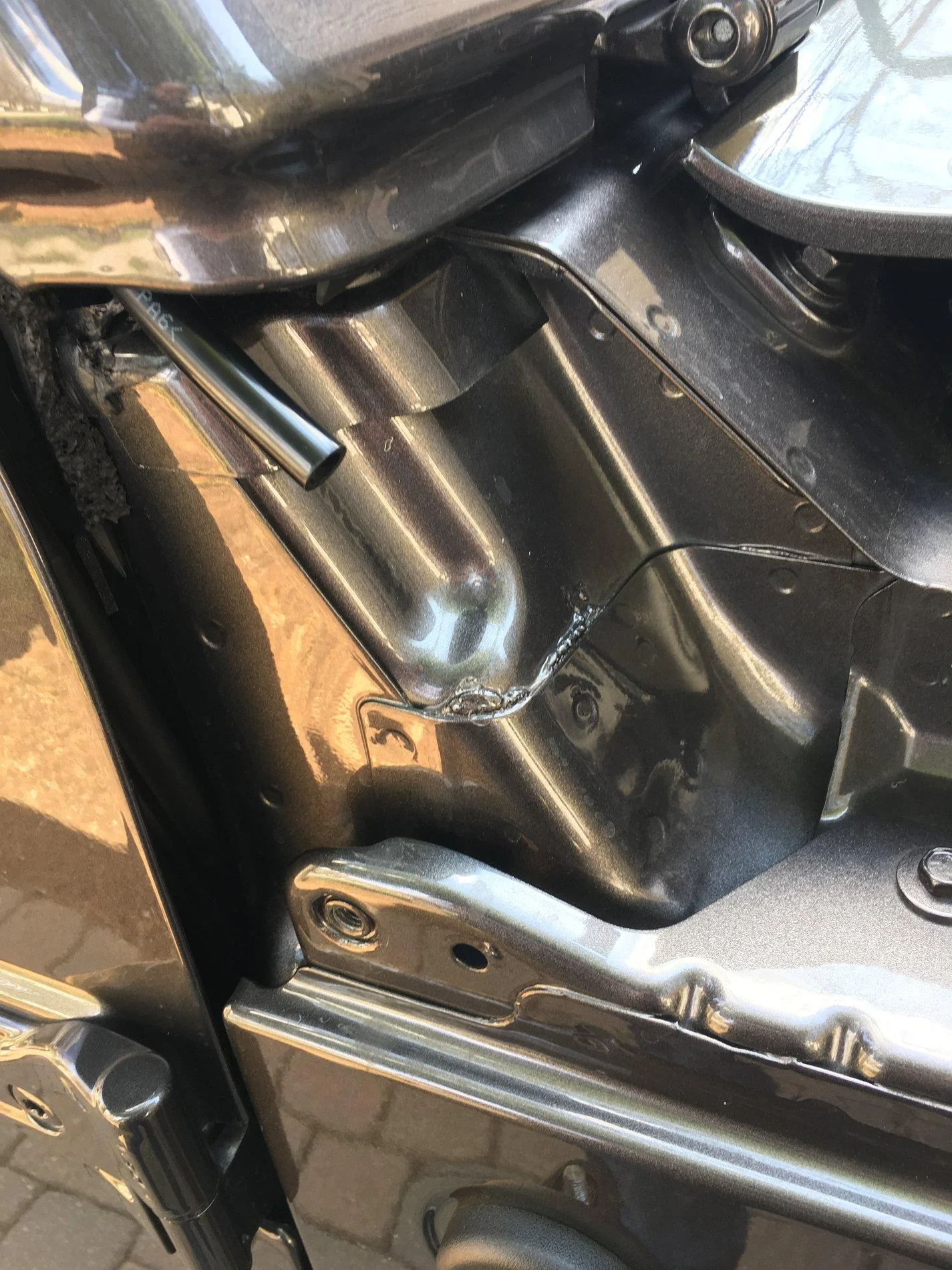

Fixed my issue. Used silicone to seal the area shown in the below image at the arrow. Rained all last night and it’s bone dry this morning :rock:

I don’t think so. I think OP was commenting about the short gutter when u open the door. I was getting a streaming leak inside the jeep on the passenger side under the dash that was making my floor wet.
