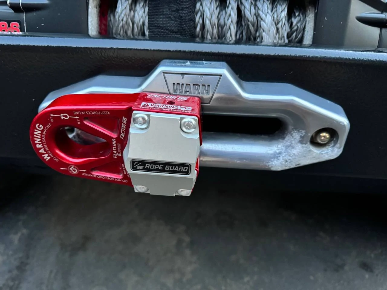

I realize this is an aging thread. @Il Commandante my corrosion isn’t as bad as yours but here is mine after two years in the moist NW USA. I think I will contact Warn. I’m running a Zeon 8S (Synthetic line). Extremely happy with the winch itself. I have used it multiple times (practice and for real) and no issues. This is the only blemish.
I'm done with Warn altogether. The EVO VR is expensive in Germany (1200USD delivered), so I expect at least a little bit of longevity.

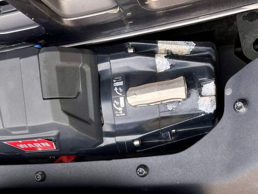

The fairlead lasted one winter. This is the winch after three mild winters:

Mine had some corrosion after 3 years or so, similar to this but a bit worse:
Jeep Wrangler JL WARN fairlead worn after just one winter 1723303922583-l2

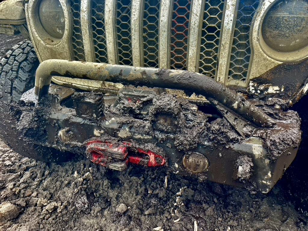

The bigger issue is that if you're getting that (likely meaning road salt exposure) you need to be on the lookout for this:
Jeep Wrangler JL WARN fairlead worn after just one winter 1723304011530-ch
That's not a pic of my winch but I had something similar (though not as bad).

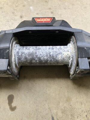

I cleaned the winch line and drum, then liberally applied some of this to the drum:
Jeep Wrangler JL WARN fairlead worn after just one winter 1723304211272-qj
And I'm now keeping an eye on it.

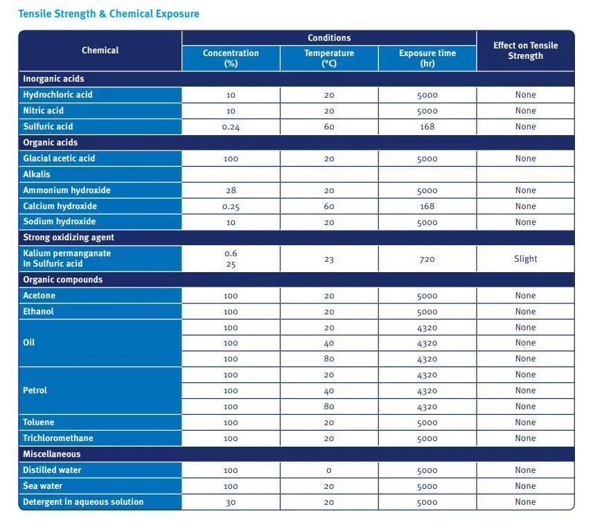

I believe that if a stronger inhibitor is needed there should be other options that don't degrade the synthetic winch line, here's some things tests have said about the chemical resistance of synthetic line:
Jeep Wrangler JL WARN fairlead worn after just one winter 1723304426904-m0
I find it amazing it can be exposed to acetone for thousands of hours with zero effect on strength.
I've also heard of some people removing the drum and getting it powder coated

Is your winch drum made of steel of aluminum?
Wow I knew UHMWPE was pretty inert but that is darn impressive. Also an important PSA for the jeeping community to keep their <checks notes> "Kallium Permagnate in Sulfiric Acid" away from their winch lines -- I know we all have a few drums of that stuff sitting in the garage! :LOL:
