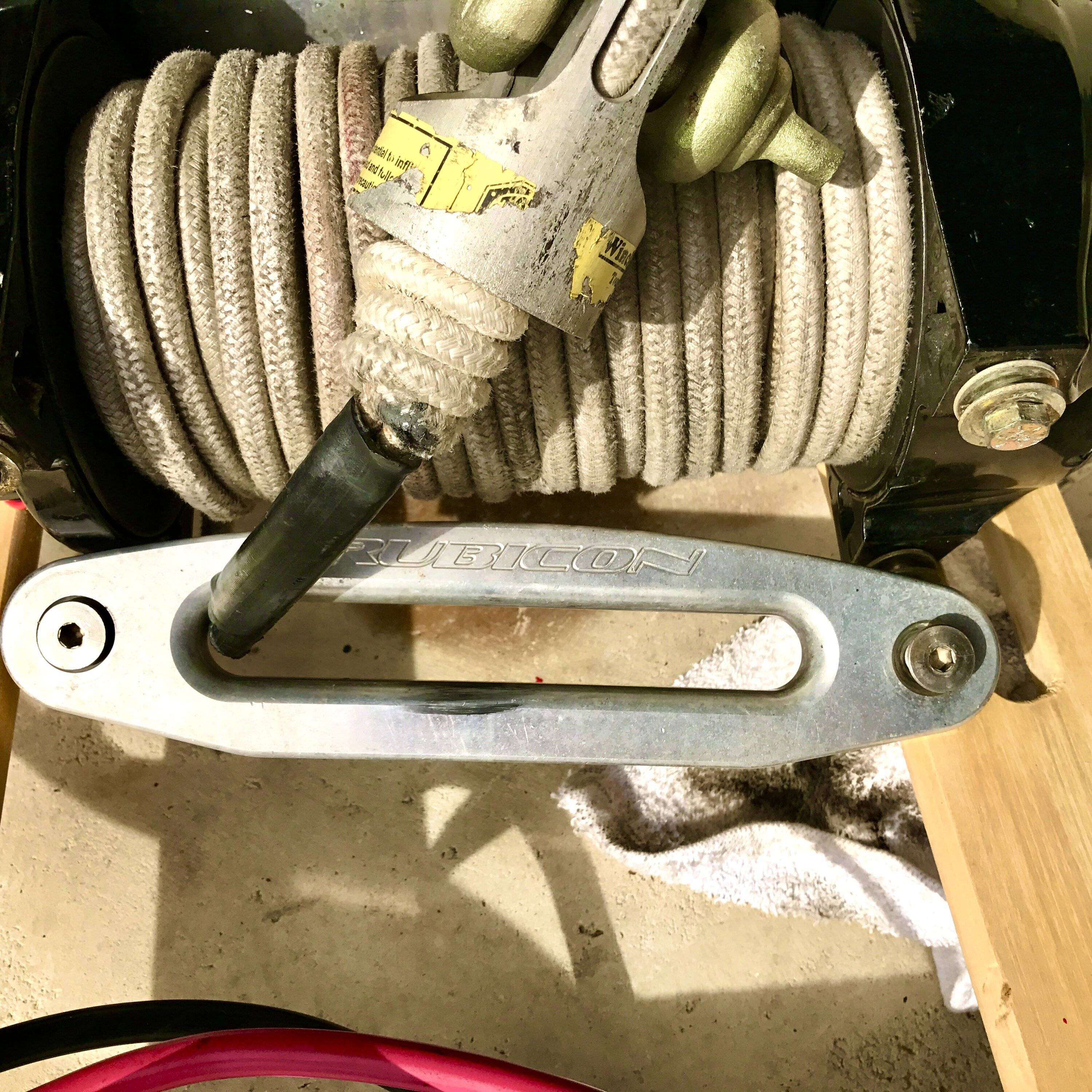

I use the Alum fairleads as shown. This is my rope that is 20+ years old. What you see is the Sheath, silver color. Inside of that is the actual rope, 26,000 lbs rated. Yes, you pay to get the outer sheath on there, but if you do as much winching as I do it's
a bargain and every year I send my rope to Masterpull for a refresh and a clean-up, cut off the working end and reaffix the thimble. NO CHARGE. That is standing behind you product.

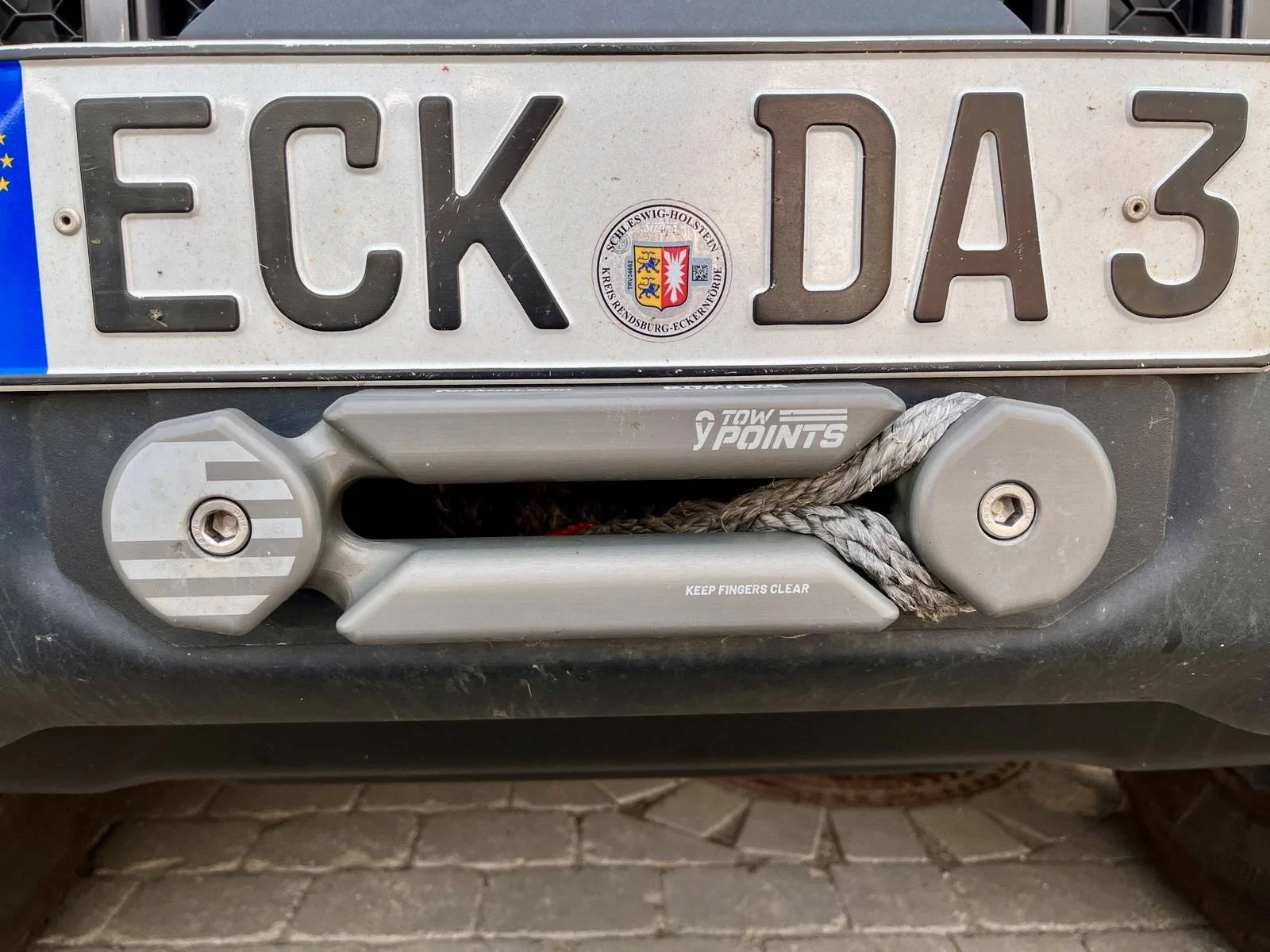

The Factor 55 fairlead is good quality.

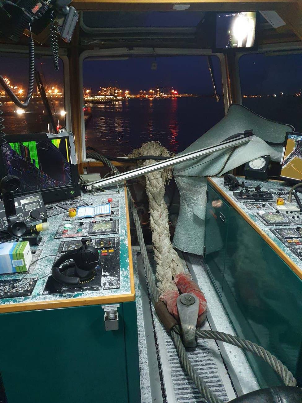

Working with much bigger lines - and occasionally breaking them - in my job I decided to ban all metal parts from my winch line setup. So I spliced a loop in the end of the line and switched to the Yankum Ropes fairlead. A good solution for me.
Jeep Wrangler JL WARN fairlead worn after just one winter Threema_2024-08-10_08-19-07
This is the reason why:
Jeep Wrangler JL WARN fairlead worn after just one winter ab7e910c-0f51-414a-8986-51adc3638ffa
