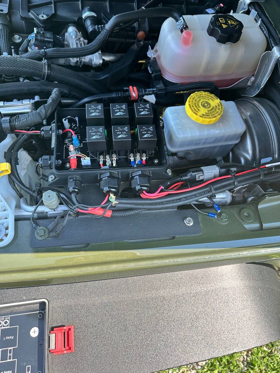

I want to wire up a few accessories mounted in the rear exterior and cargo area of the vehicle to my Voswitch VL400. Do I really need to run both positive and ground wires up to the engine compartment or can I save some wiring and ground those accessories in the back?
This is how I do it. I run the ground wires to the screws right in front of the vos switch. However I only do this to keep track of all my wires. This is completely not needed. You can just find any ground close to the device your hooking up.
Jeep Wrangler JL Voswitch wiring question? IMG_6438
Steemax
Mar 6, 2022
528
951
Los Angeles
2022 Rubicon 4xE, 2025 Outback Wilderness
I'm about to switch mine and do this as well. There's next to no room in the Voswitch panel to wire anything up. It was a nightmare getting two sets of wires in let alone if I decide to wire anything else up. At least moving the ground wires out of there will make life a tad easier.
