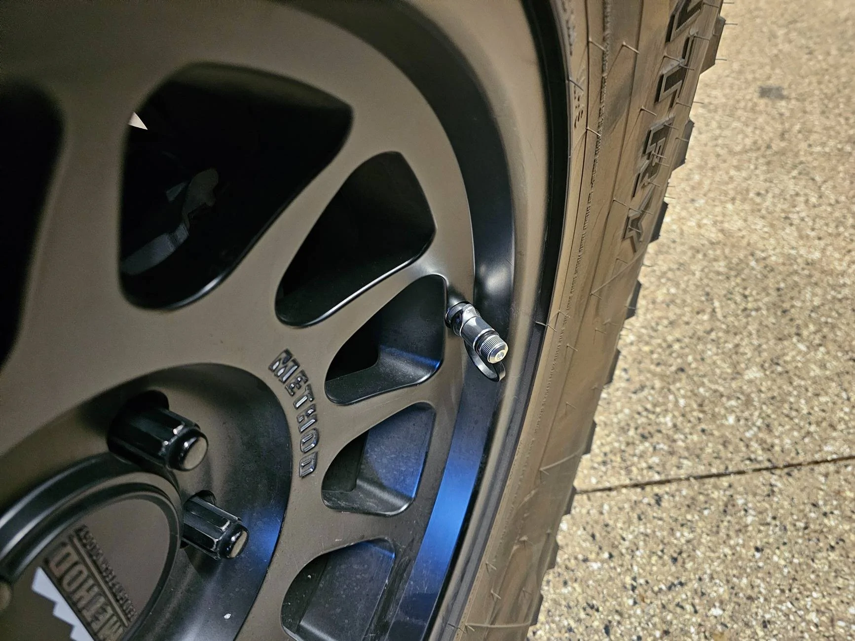

Thanks, Roanie. You always find the cool stuff. I have the Apex rapid tire deflators on my Method Bead Grip wheels, and I think they are too long. The Method wheels have the valve stems pointing out to the side of the wheel instead of to the center of the wheel like the ICON Rebound Pro wheels do. If someone is trying to decide between the Method and the ICON wheel for bead retention and wants to use a rapid tire deflator valve stem, they would be better off choosing the ICON wheel with the Apex deflator or the KMC Monster deflator, or the Method wheel with the KMC Monster deflator. The Monster deflator looks like it is quite a bit shorter than the Apex deflator. Here is a picture of an Apex deflator valve stem on one of my Method wheels. I think I'm just waiting to lose a valve stem with these, so I'll change to the KMC Monster deflators instead. Hopefully that will save you having to help me put a 40" spare tire on my Jeep this year on the Rubicon.

All is not lost. If that was my predicament, I might be tempted to machine a new port for a stem in one of the slots, angled as necessary for filling and protection. Simple job for a machine shop.
