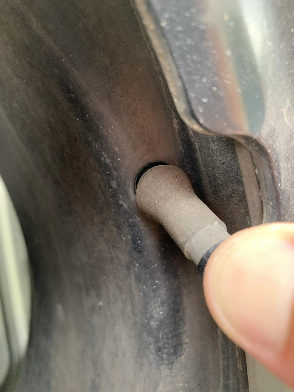

Has anyone replaced their factory valve stem? Mine has a leak and I’m not sure if I can replace the rubber valve stem myself without touching the tpms sensor. Shop says $30 for just a stem replacement and that seems outrageous for something I can do myself.

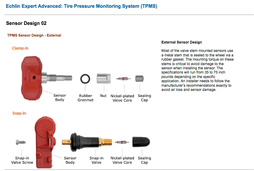

There are also a few videos on replacing valve stem ..google!
