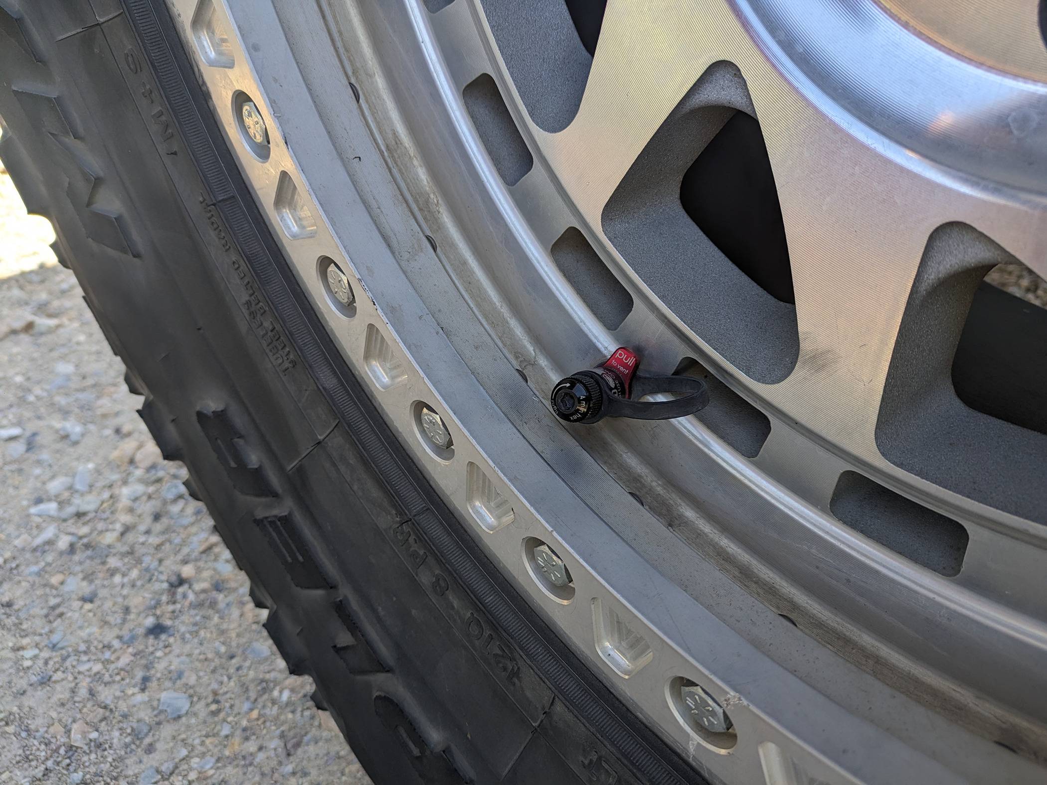

I disagree about ripping valve stems out without beadlocks. I wheeled for a couple of years on stock Rubi wheels aired down to 12 psi and never once damaged my stems. And that was on East Coast jagged rocks and loose rock as well as out west.
I've also have beadlocks where there are marks in the wheel from where rocks have fallen or rubbed in and could have easily damaged a stem. In the pics below you can see my beadlock ring does nothing to protect the stem. The best advice is a short rubber stem or a short rock solid stem like Apex or Powertank.
Honestly I have never met someone who has damaged a stem and everyone I know does a ton of crawling.

I don't believe there are better valve stems to protect from rocks. I have run apex quick deflators on 3 rigs with no issues but they were on beadlocks and completely protected. I don't doubt with certain wheels where the apex is exposed, that someone will snap one off rubbing along a rock, there is no flex and will break if unprotected.
For rubber valvestems, there is a bit more flex but in my group, still have seen one get torn off on the trail. This was on a stock wheel.
Its all in the design of the wheel whether its exposed or not, even certain wheels will have the valve stems at an angle which can help protect it.
