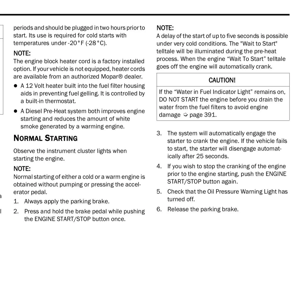

Good luck, I wasn’t able to find it in the manual. This is the best I could come up with:
Jeep Wrangler JL Use glow plugs at every start? 1733059849484-cm
It's almost like we they've designed it explicitly so we don't have think about it?
