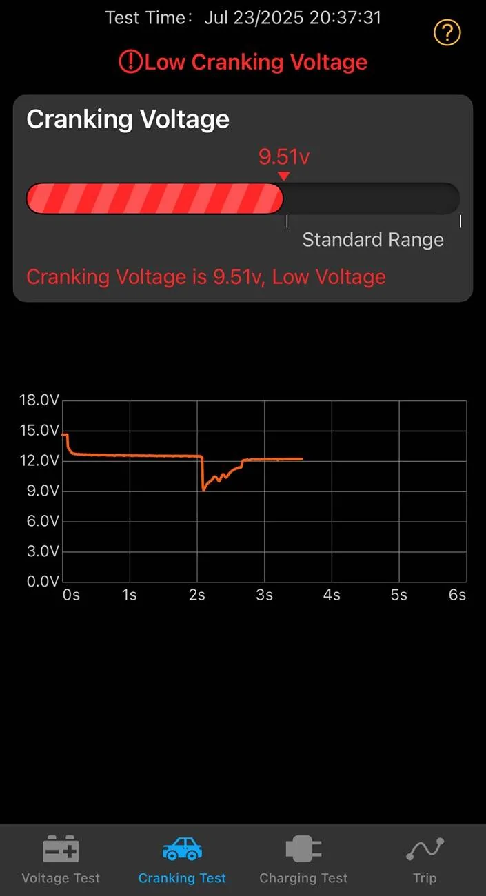

2025 battery monitor reporting battery bad, cranking voltage dropping to 9.51v
