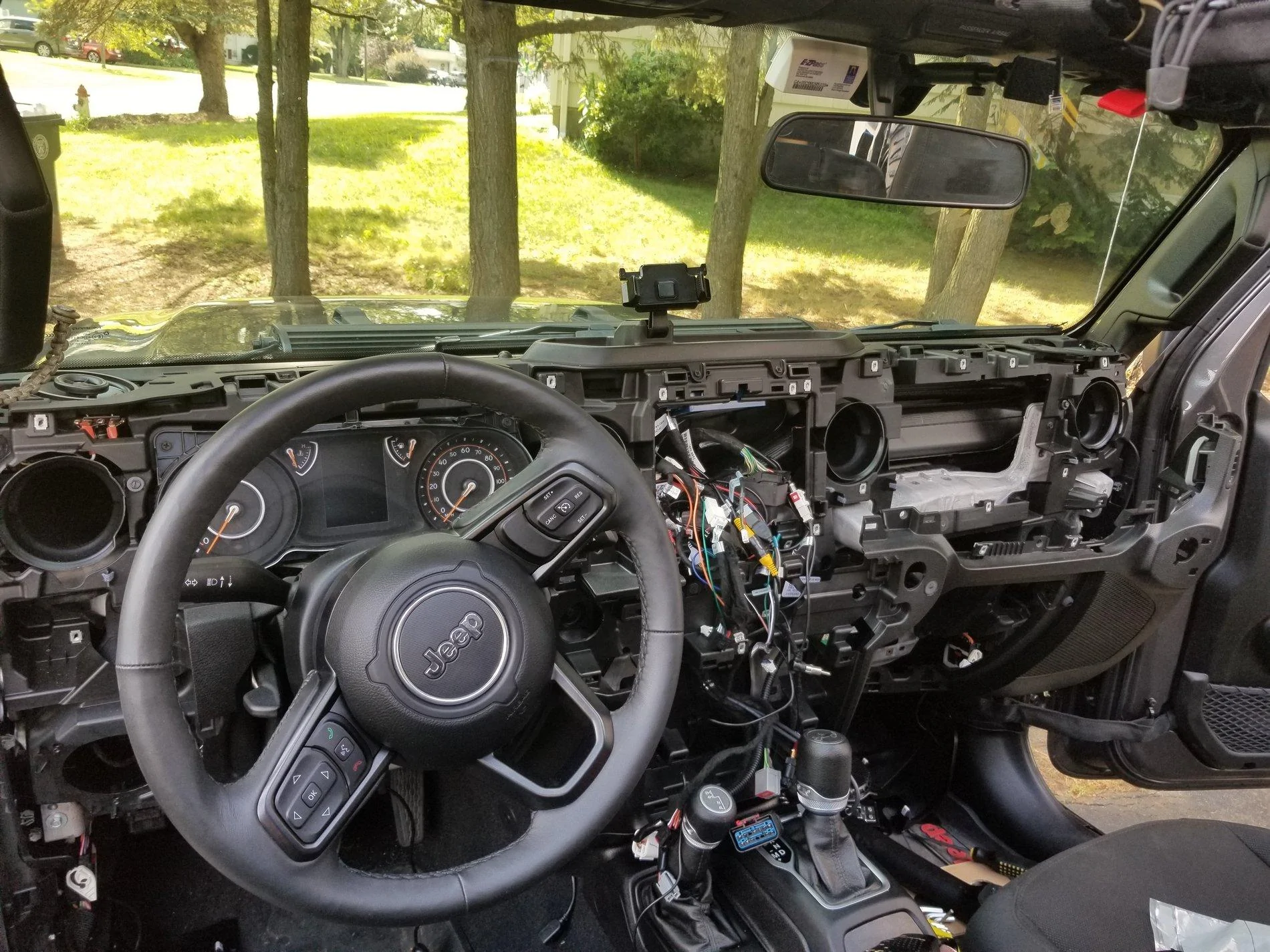

I replaced the knee speakers with the Metra pods and 6.5” not to long ago. There’s a handheld of threads dedicated to it and I still had this one bookmarked,
https://www.jlwranglerforums.com/fo...ass-blocker-d-i-y-wiring-harness.12738/page-2
Post #16 is a solid description of the process. While it is doable to install the pods without removing the dash, I highly recommend sucking it up and taking it all apart. If you leave it on, there are a few tight doors where you’ll be need to bend some trim pieces. I got to the point where I felt like if I bent them anymore they would break so I ended up pulling it all apart.
I’ve never worked on a vehicle before but taking the dash off, while time consuming, wasn’t bad at all. There are a few “hidden” screws to watch out for and having a 7mm wrench helped in a few tight spots.

It’s a lot of work. Some hidden screws. Good videos out there. Crutchfield will send instructions. So will Metra if you buy the boxes. They are slightly different. It’s a few hour process.
By far the best bang for the buck is replacing the speakers on the top of the dash.

It’s not so bad.

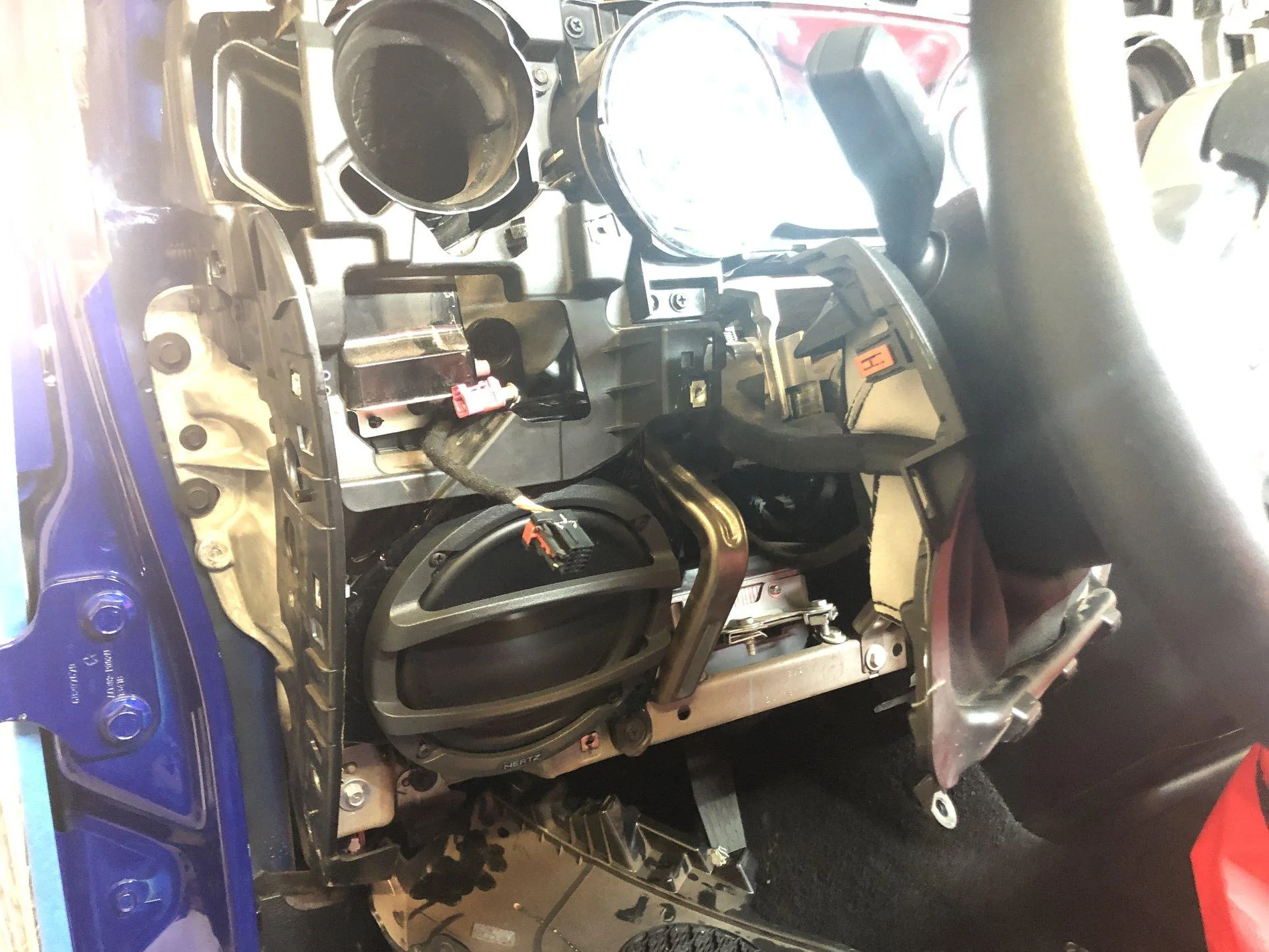

Hey thanks for the pic. Did you mount a tweeter with the hertz woofer or just toss it? Does the OEM grill fit over the woofer with the Hertz cover?

I installed these:
https://www.crutchfield.com/p_091165AS3/Focal-Performance-165AS3.html?tp=106
I have a neighbor who has a laser cutter who was able to make a bracket for the 3" in the dash. Jeep thought they would be cute and make a random "bracket" with an odd shape. I mounted the crossover on the side close to where your left foot would rest against the sidewall. Pretty easy other than the dash removal. ?
I also bought these: https://www.crutchfield.com/p_327JTSA065/SSV-Works-JJT-SA065.html?tp=110 and replaced the overhead bar speakers with 2-way 6.5's.
I ran a single 12" in the back: https://www.crutchfield.com/p_136112TGW3/JL-Audio-CS112TG-TW3.html
I also used a 1000W amp for the front speakers.
If you run an amp I would HIGHLY recommend running power around to the driver's side to reduce noise. A lot of people have issues with a slight buzz because of interference. It's simple to be honest. There is a rubber stopper that you can pop out, cut a hole through and feed the power cable through. I ran it under the carpet. I mounted the amp under the passenger seat. It was all completely hidden.
Good Luck!
