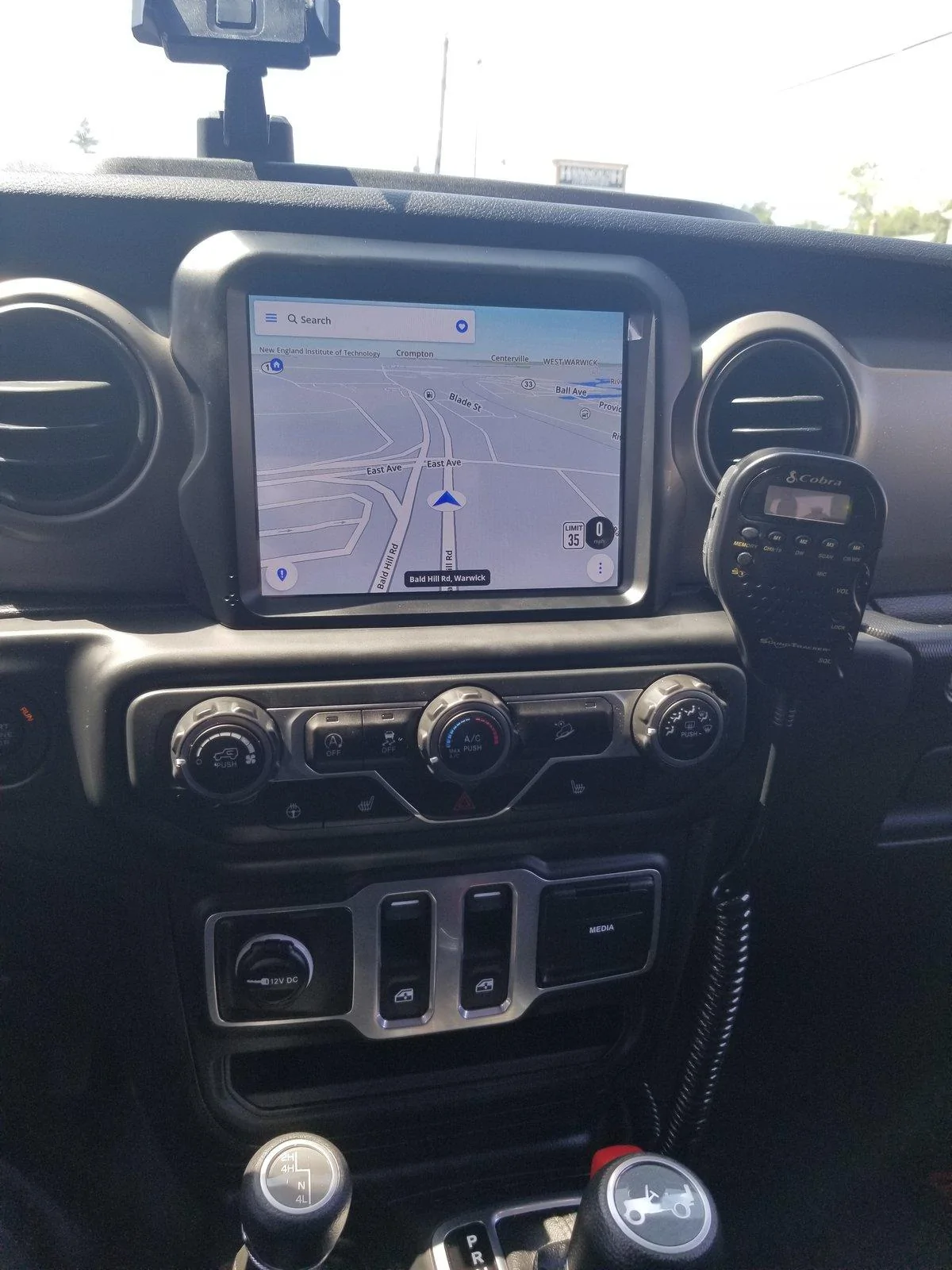

I put in an aftermarket android radio as well. Has a bundle of wires that I had to tidy up.
Wow... Looks great. If I ever do that (probably never will) I'd probably try to add the aux switches as well.

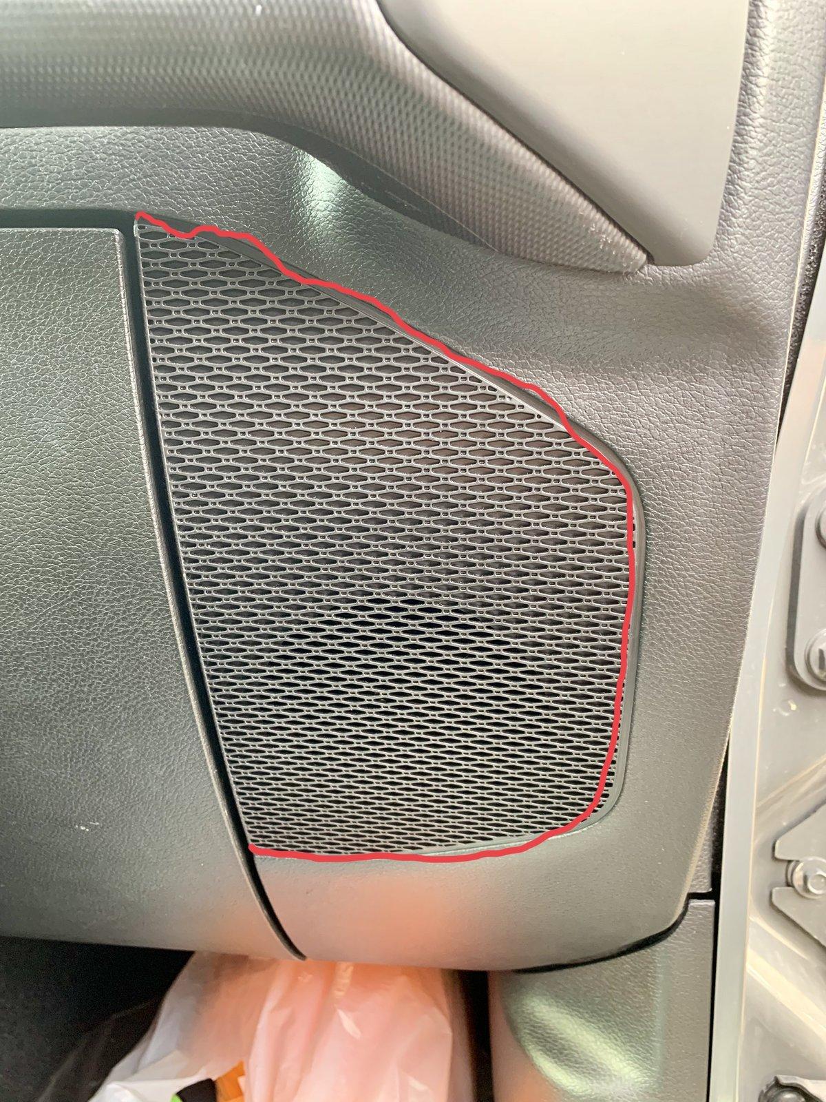

What I was tempted to do was cut this speaker grill part out LOL. Then somehow glue it LOL. I really don’t want to remove all that dash crap.
