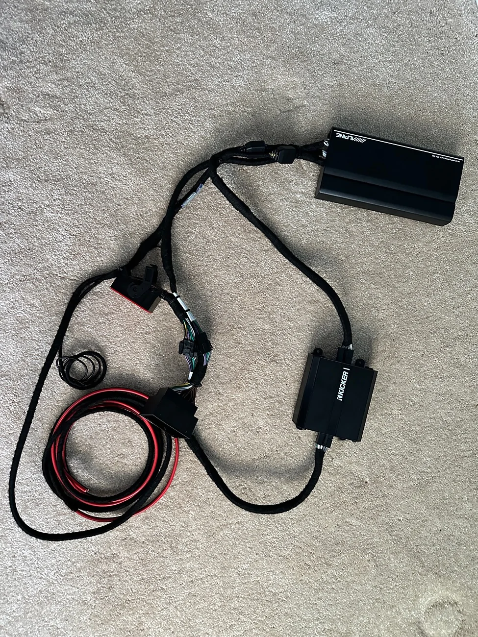

There are other amps on the market around the same price that will go to 2 ohms a channel. I just finished my sound bump upgrade kind of the same way you’re thinking. Full set of kicker KS speakers. 3.5 for the dash, 6.5 for the knee panels, and 6x9s in the roll bar. Alpine KTA-450 to power them (I went with this because it can do 2 ohms a channel, is small, and I tapped into the pre wire for the stock Alpine amp inside instead of running wires to the fuse box because it only needs 20A fuse and stock Alpine is a 25). They get pretty loud. It’s odd that a kicker amp can’t go down to 2 ohms a channel…their amps are usually beefy enough, but I guess all that auto EQ they built in has to take space and money from other things to keep the price comparable.
it won’t be simple plug and play though. You’ll need resistors or an interface on the radio output to keep the audio going through an amp, find a place to put it, connect all the wiring and all that jazz.
edit: it could be “almost” plug and play with some pre-wiring. I made this for my install.

600W is max theoretical RMS for the whole set of speakers. Only pair that's "underpowered" is the 6x9s because they can take up to 150W RMS, but they're well in RMS range for those speakers at the power they're getting.
Jeep radios have protection mode. If the radio doesn't see enough resistance (Which is 4ohms a channel in non-amplified setup) it will shut the audio off. As I was typing that, an idea popped up in my head whether this can be avoided by using JSCAN to trick the radio into thinking it's factory amplified and it doesn't do the speaker check similar to when halogen lights get replaced with LEDs...or they thought of all that with the stock Alpine amp).
Kicker box is the inline resistor pack that I went with to prevent the radio from going into protection mode. I prefer to run speaker level input into amps if they support it because it cuts down on need for RCA wires, and I'm convinced that it reduces additional noise being introduced into the sound from the gain being set up pretty high for RCA level input.
At the end of the day you will need some kind of interface for the stock radio on the Jeep to run a speaker amp. Whether it's home rigging resistors (cheapest) to something like this Kicker KISLOAD4 (~$50) to PAC APP4-CH41 (~$400).
