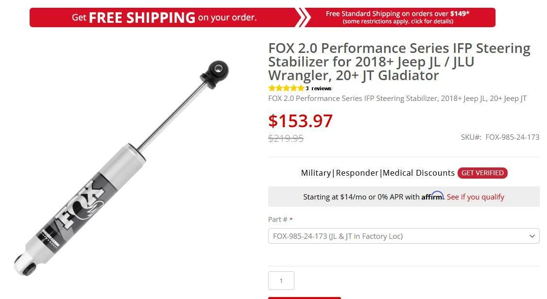

Upgrade your track bar if you haven't. The stock one is barely sufficient for 33s.
If you do upgrade the SS, the thru shaft ones are the way to go. I had right pull until i got a thru shaft one and the pull was worse with a fox ss take off (non thru shaft)

Your Fox stabilizer is totally fine. As mentioned you may want to be proactive and upgrade your track bar as mentioned. I went with the SteerSmarts and also their Sector Shaft brace. My OEM track bar bushings prematurely wallowed out not too long after going to 35s (315s).

Check your local jeep shops for those fox ones. The one near me had several take offs and i got one thrown on for free when i did some other work. But like i said, when i put it on, it caused a stronger right pull than i had before. It was really nice in getting the steering wheel to"stay" where i put it, though. I went with the non adjustable falcon through shaft and it has been great. If i had the money at the time i prob would've gone w the adjustable one but the non has been a huge improvement over anything else I've run.

I don't have a pull to the right problem with mine but when I'm in the left lane I have to keep pressure on the wheel to keep it from pulling left. In the right lane I can take my hands off the wheel and it tracks straight. That's been my experience so far with it.
