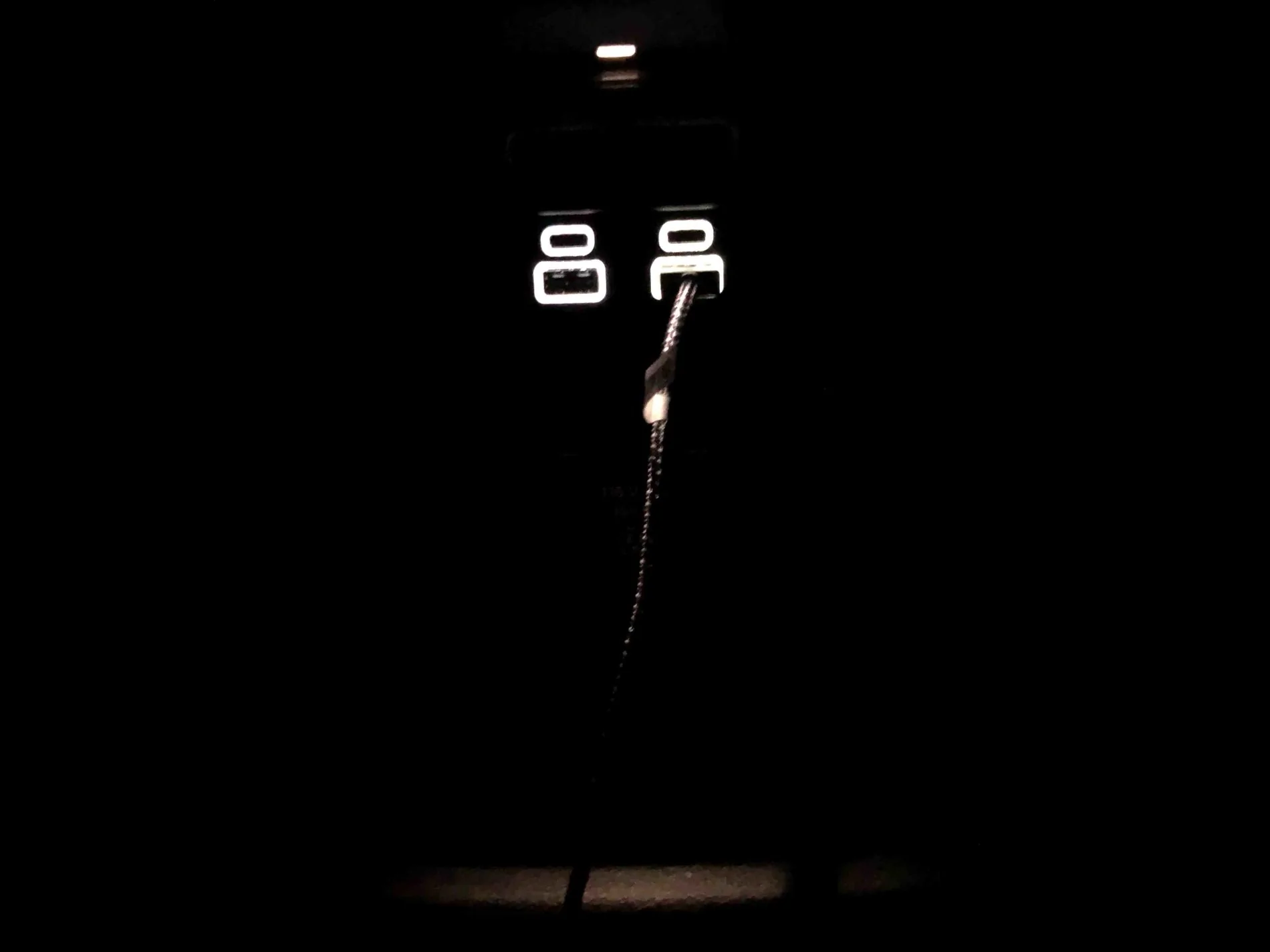

Does anyone know if the rear USB's are supposed to light up? Mine work, but no light.
I figured it out. I was in the vehicle earlier checking out some UConnect things and looked at those rear console USB's and back light. I was in a acc. mode. I came in the house when it hit me that the vehicle has to be running! I went out, started up, and there they are back light rear console USB's. Smh. I'm a goof.
