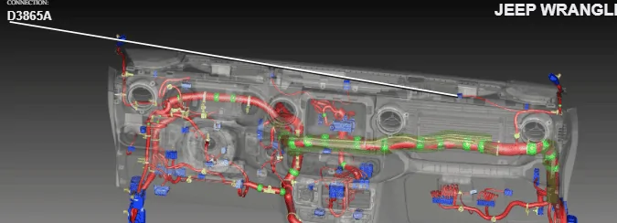

I just recently had to do a major repair to my air ducting system had a tear everything out and put it back now my Compass isn’t working. I think I may have forgotten to plug it in maybe anybody know where it’s located so I don’t have to tear everything down and look I can just go to one specific area.

This is a Wrangler forum.

Oh thank God it’s at the top easy to check. I’ll do it after work. Thank you.
Glad that's easy. I haven't torn the dash down and that looked like a pain.

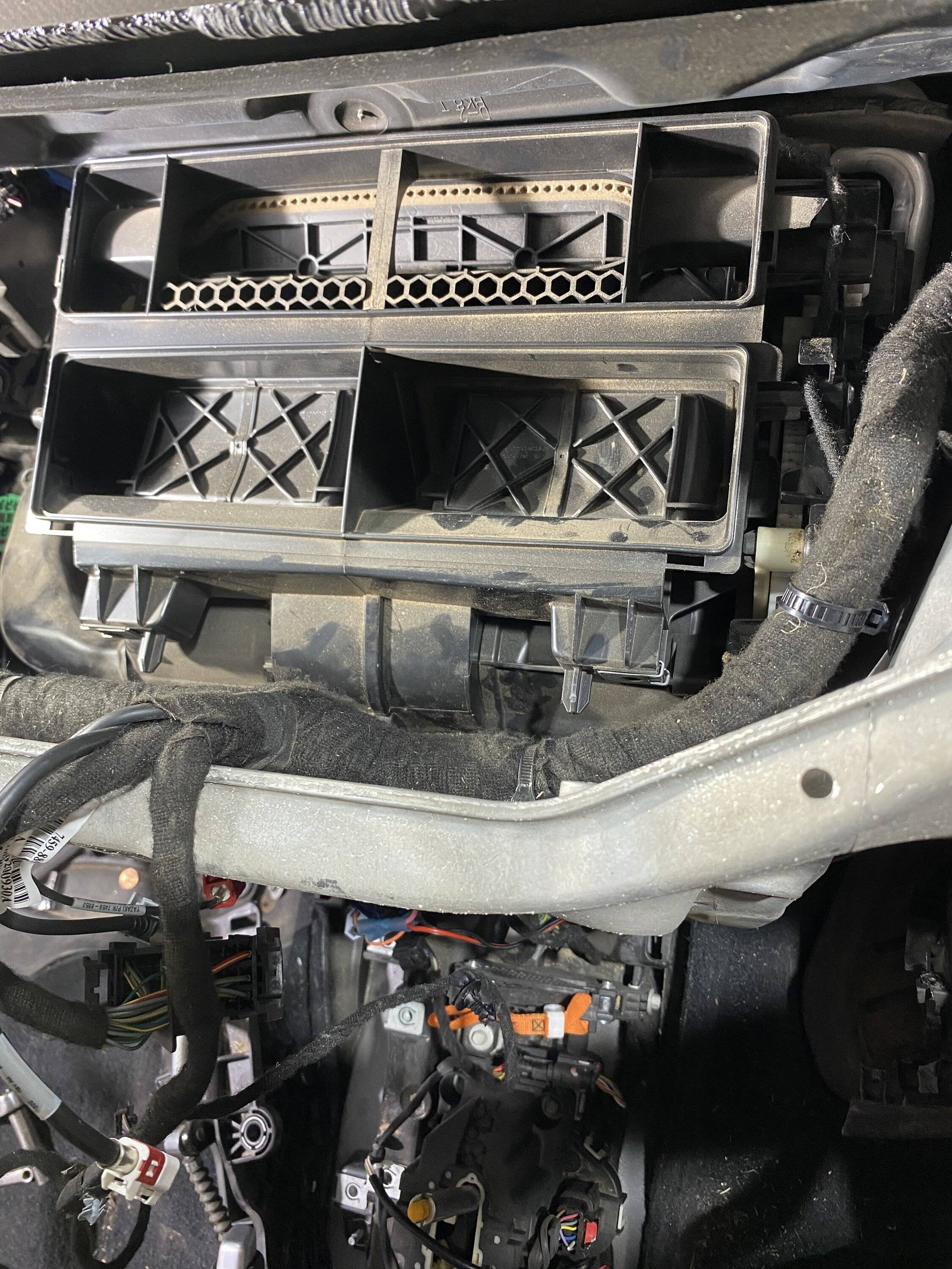

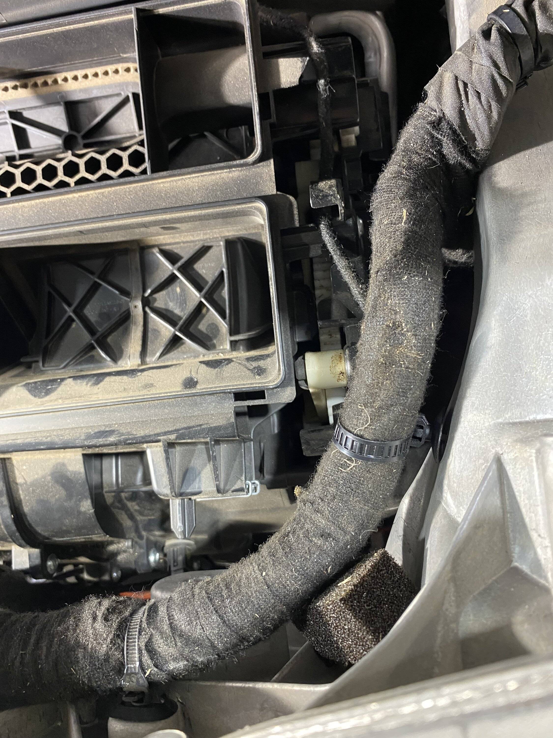

Yes, it’s a very big pain a few hundred screws hold it all together in a couple bolts took me almost 9 hours to take apart and about eight hours to put it back. The ventilation had a wiring harness through it. My wife told me that the radio would get overheated during the winter, and it seemed like her air conditioner was barely working during the summer. And since it’s been over a year, and the dealership would not fix it so I had to do it, now the air conditioner works great. I had to modify and do my own thing to make it work. It is just sad that the dealership wouldn’t fix something that they messed up during in the build and I wish my wife when you told me sooner I could’ve taken care of it a lot quicker .
Here’s a picture of the wiring harness I had to move over I and put a zip tied a hold it out of the way. If you know of anybody else having this issue. It’s this wiring harness is the problem. It has a hole to put a zip tie for wiring harness to move it out of the way, but I did not have a zip tie.
I got it plugged in and it’s working fine now. Thank you for your help.
