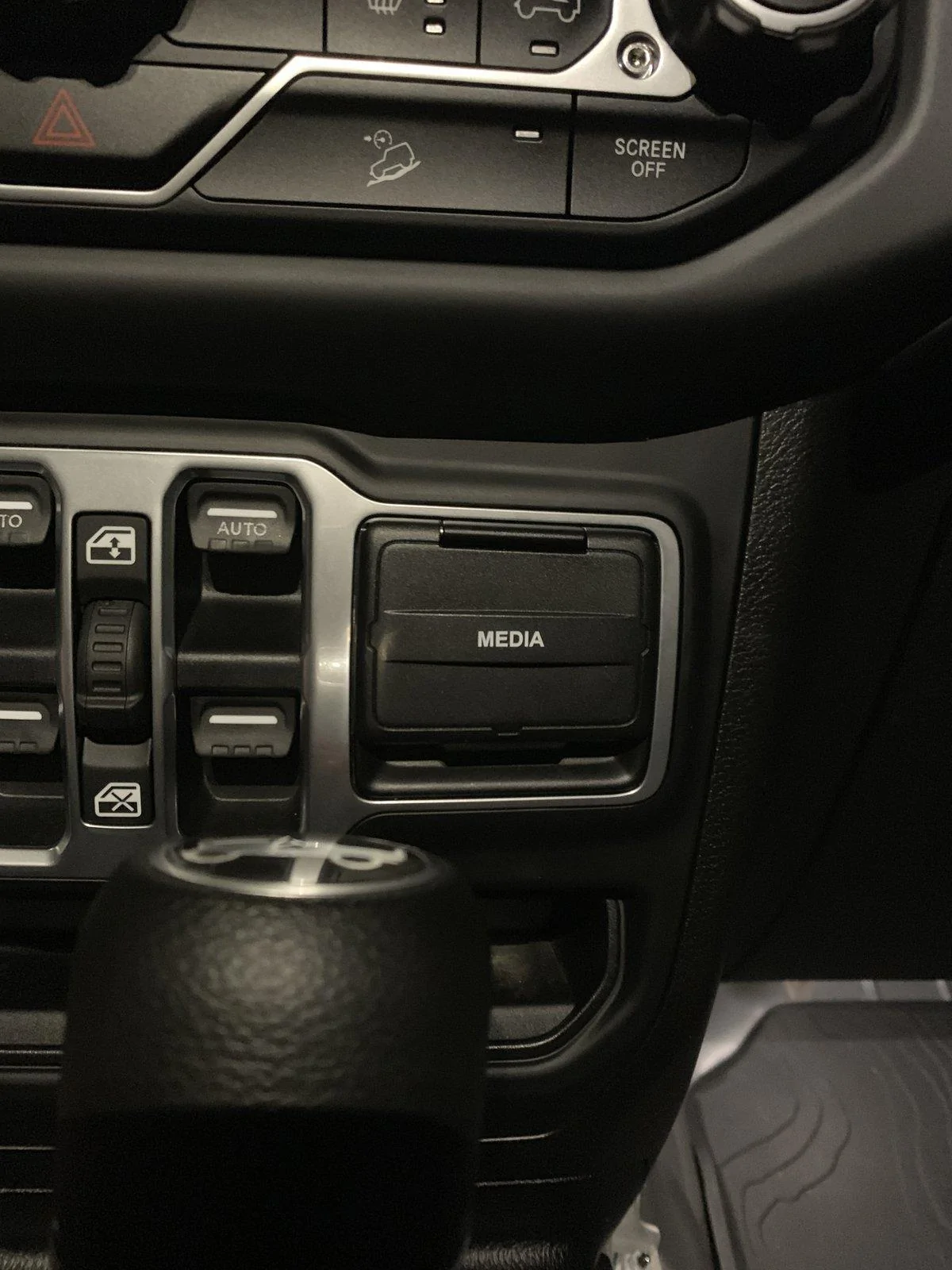

Hi all, first post, think this is where it goes? Anyway, I went off-roading, splashed in some mud, got home and started cleaning my JL. I sprayed the inside and everything down (as I did last year). Once I was done cleaning the mud off everything, checked to make sure everything worked but the all 4 USB's and the power outlet in the back weren't working.

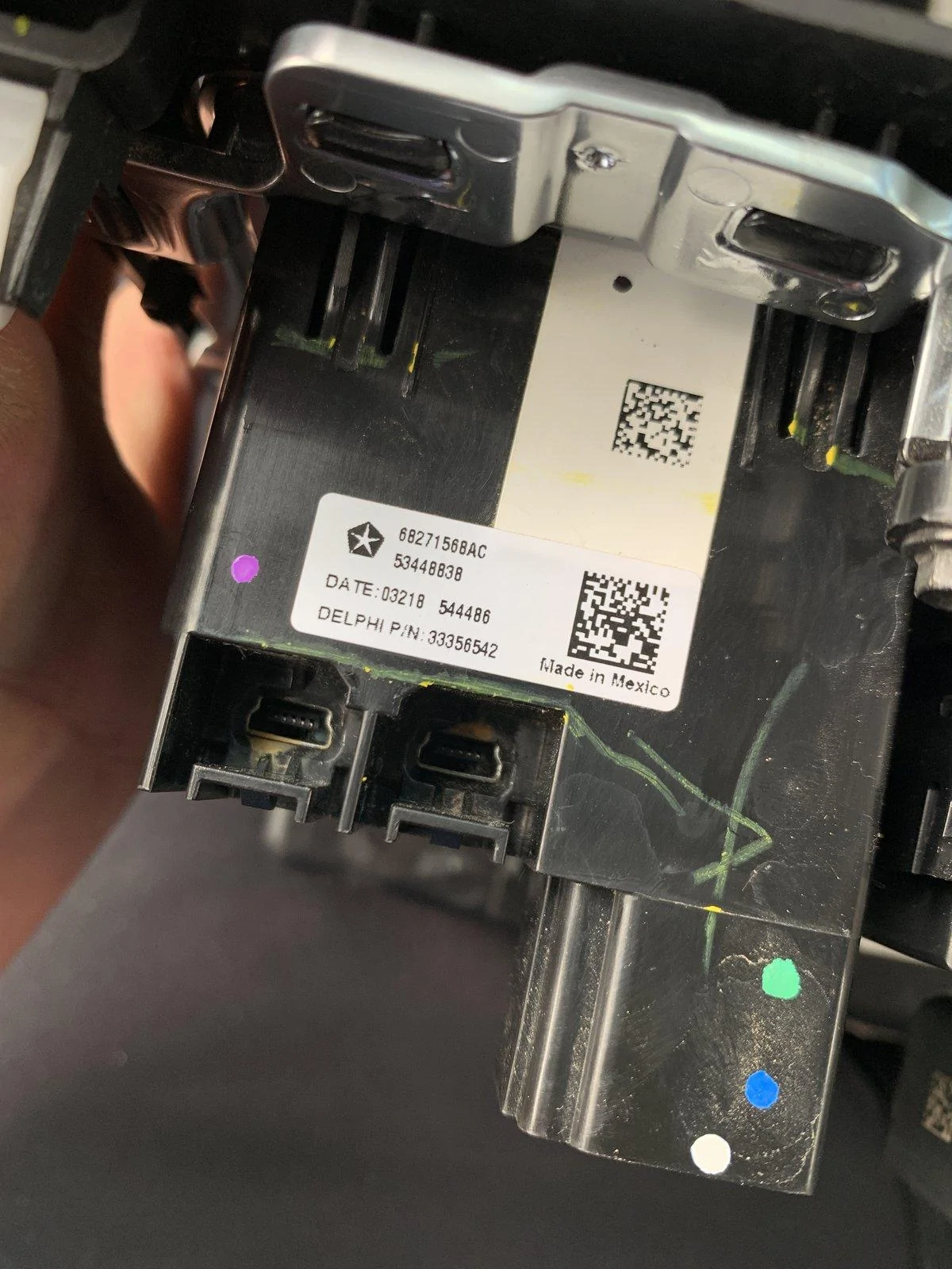

Took it to the dealer, they ran diagnostics and told me which parts needed replaced $1,300 total. I'm a very handy dude and like to fix things myself and install everything myself. So the only problem I have is I can't not find the replacement in-dash media hub for my wrangler.

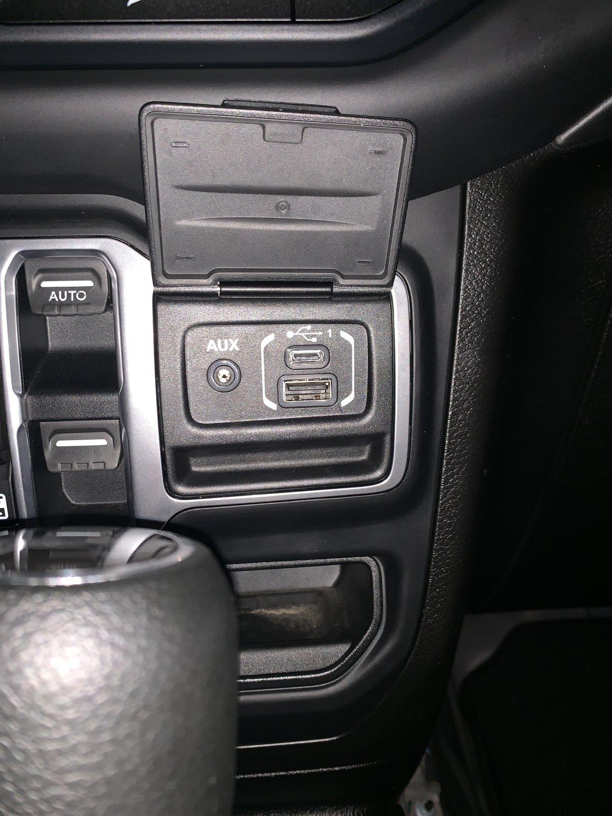

They told me it was part 68271568ac. I even opened up the dash and found this number on the media hub I'm looking for. Whenever i look for this part online though it doesn't look like the part in my wrangler. The one in my wrangler has a USB, USB-C and an AUX input. The others I've found online only have the USB port (with the provided part number?). Any help?
Also, I'm supposed to replace the power inverter module and center console USB input. Both of these I have, any online diagrams and such so I can figure out how to take the center apart to replace these?
All in all for parts+ diagnostics and then reprogramming the module through the dealer I'm looking at about $400. Much cheaper than what the dealer was asking me to pay.
Thanks for any help!

When I replaced my media hub I purchased part number 68505684AA.
