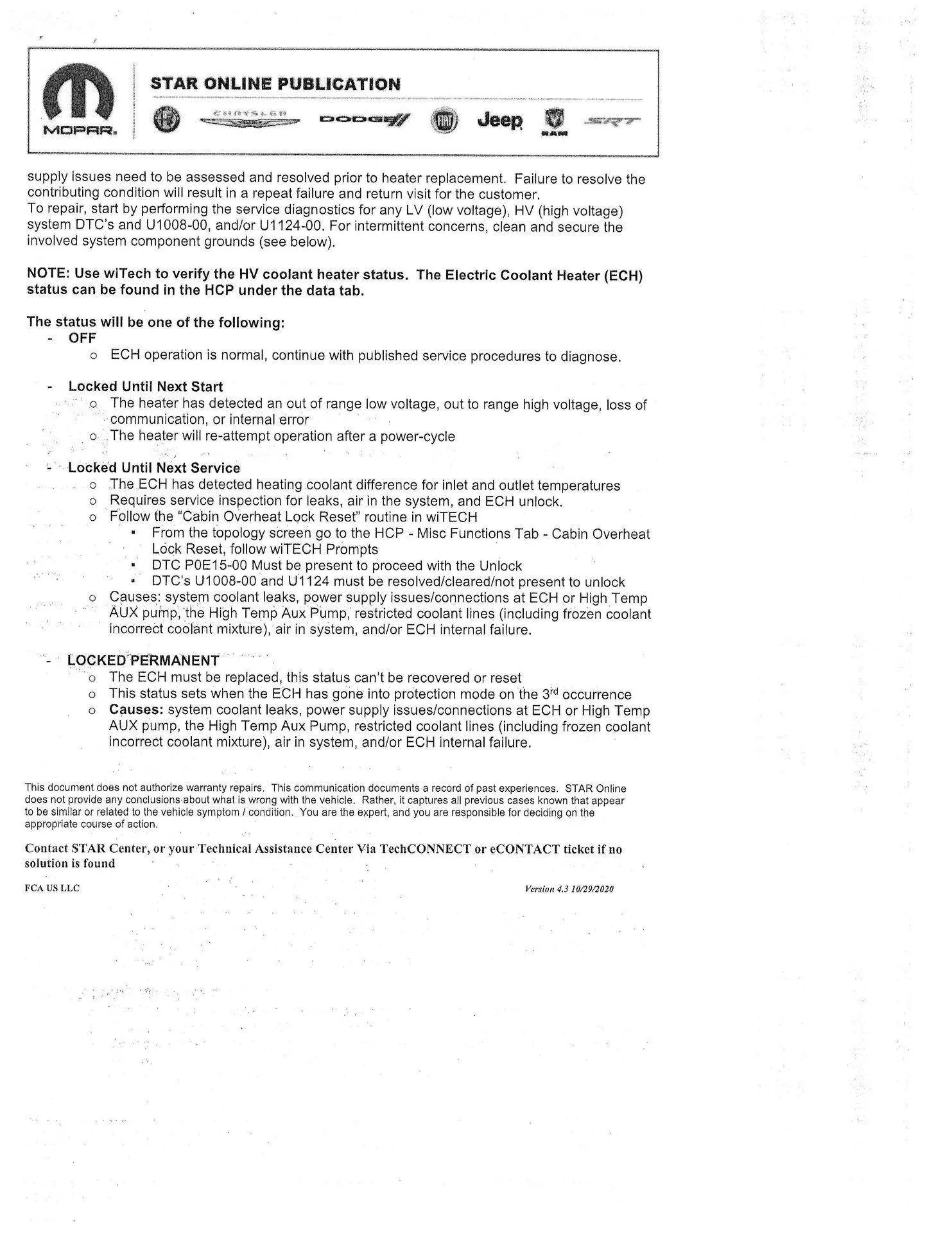

Had this same issue. Took three attempts to get it fixed and two separate dealers. About 3 weeks without the Jeep. I told them what the issue was the first day I walked in but also made the mistake of telling them I figured it out on the internet. Two electric car "experts" (their words) tried to tell me it was normal. Basically got kicked out of the first dealer.
The second dealer would at least work with me so I have to give them some credit. I know they wished I would of never walked in the door. In the end I had to get a copy of the troubleshooting/repair procedure online and a photo copy of the owners manual. I highlighted both and put it in a binder to give to their techs. Low and behold the heater needed to be replaced. On the plus side it fixed the issue.

Do you have a link to the trouble shooting procedure? Might be helpful to someone reading this in the future. Also could help trouble shoot other issues.
Think I have posted this before but here is one of the better ones. I have some more information somewhere too. It actually tells the techs what to do. I was just amazed that they could not find this information. At least at my last dealer the tech was nice about it. He told me he would not of found it if I had not given them this information. The owners manual I photocopied had to do with what temps the ICE comes on. It is something like 15f. They were trying to tell me it was normal for the ICE to run anytime the heater was running
