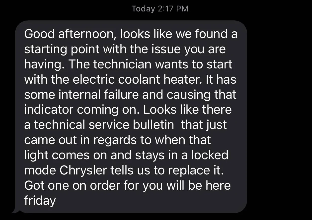

We’ll after 21 days they finally think it’s the problem I showed them on day 1

Day 29 just got the call to come get it - I hope as this becomes more prevalent they don’t take so long… this doesn’t account for the 6 days in the shop for a total of 35 days for this one issue.
they said since replacing the battery coolant pump they haven’t replicated the problem. I can better detail what was done when I get the papers

I finally got my Jeep back last week with the same issue. Took about 2 months to get resolved I took it to the dealer closest to me and they told me it was normal operation. I assured them it was not and needed the heater replaced. Tech came out to talk to me and kept saying the 4xe was looking at "lots" of things and was normal. I kept asking what "specifically" was causing it to run and he could only say "lots".
I called Jeep Cares and they were kind enough to "dial" another dealer so I could make an appointment. This time I took them in some more paperwork along with a Star case number but was again told it was normal and the Star case did not apply. (They were wrong on both accounts) They did reset it so it worked normally for one day. On the plus side for the dealer was they were at least willing to work with me.
Finally I got online and found the procedure for testing the heater, made a photocopy of the owners manual saying when the ICE is supposed to run. I wrote down exactly what the Jeep was doing and why their original conclusion was wrong. Gave them a folder of highlighted paperwork. I don't think I made any friends but low and behold they called me back to say the heater needed replacing. The tech did say if I would not have given them (Jeep's own) paperwork they would not of found it.
Took about 2 1/2 weeks for them to diagnose and get the heater replaced. Much quicker than I thought it would be. I am a little frustrated with the situation but actually happy with the dealer in the end. They did fix it and I know I was not always the easiest to deal with. I do think Jeep needs to do much more training on the 4xe but kind of get the impression they don't really care. Jeep Cares was a little less than useless. Still love driving the Jeep but not looking forward to any other issues I may have to deal with.
