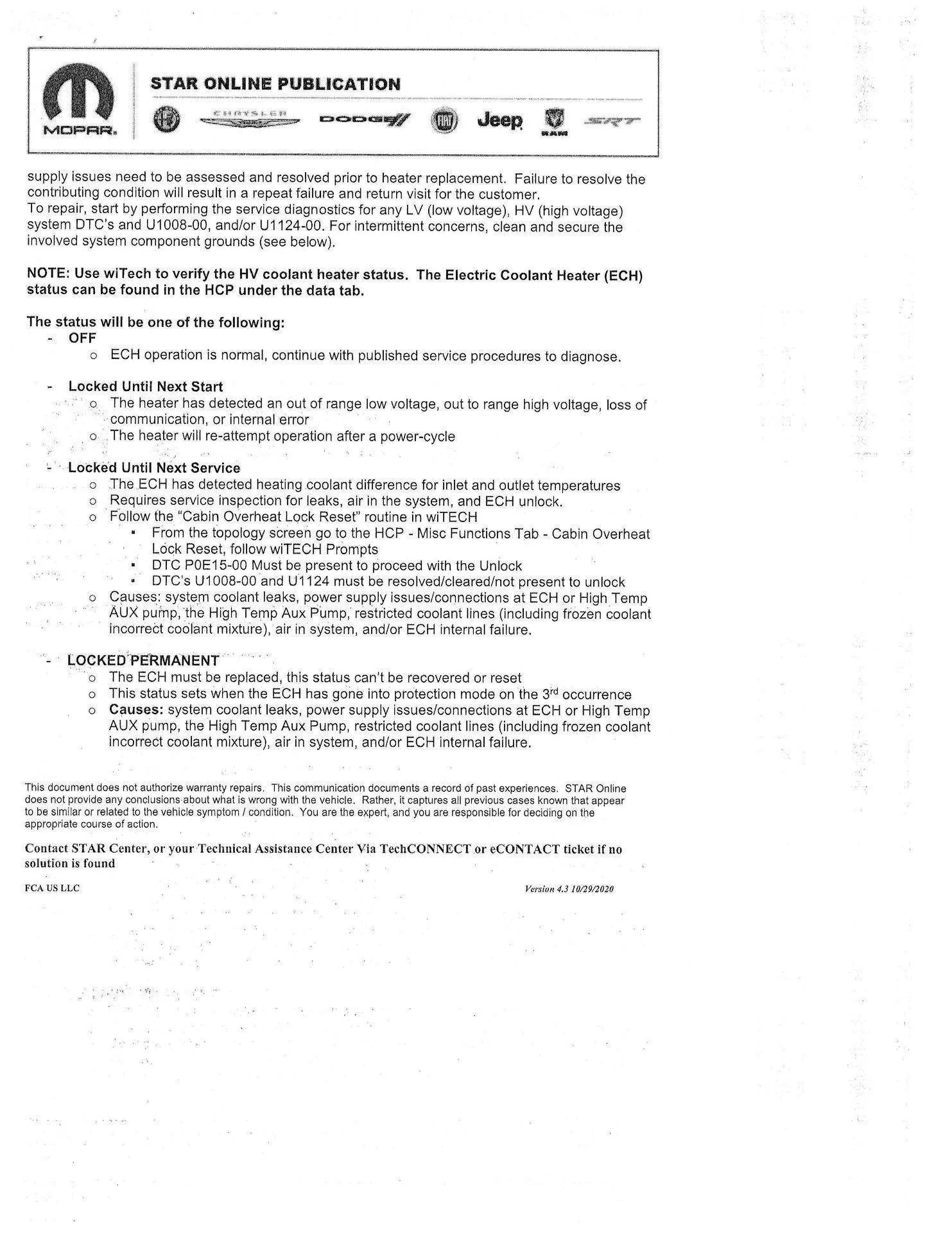

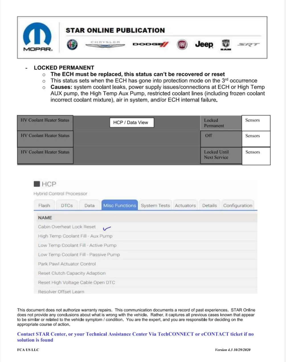

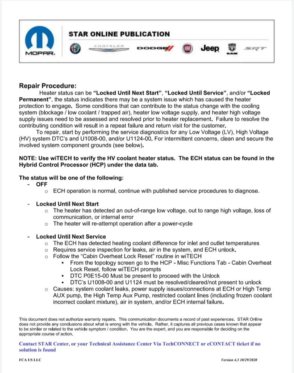

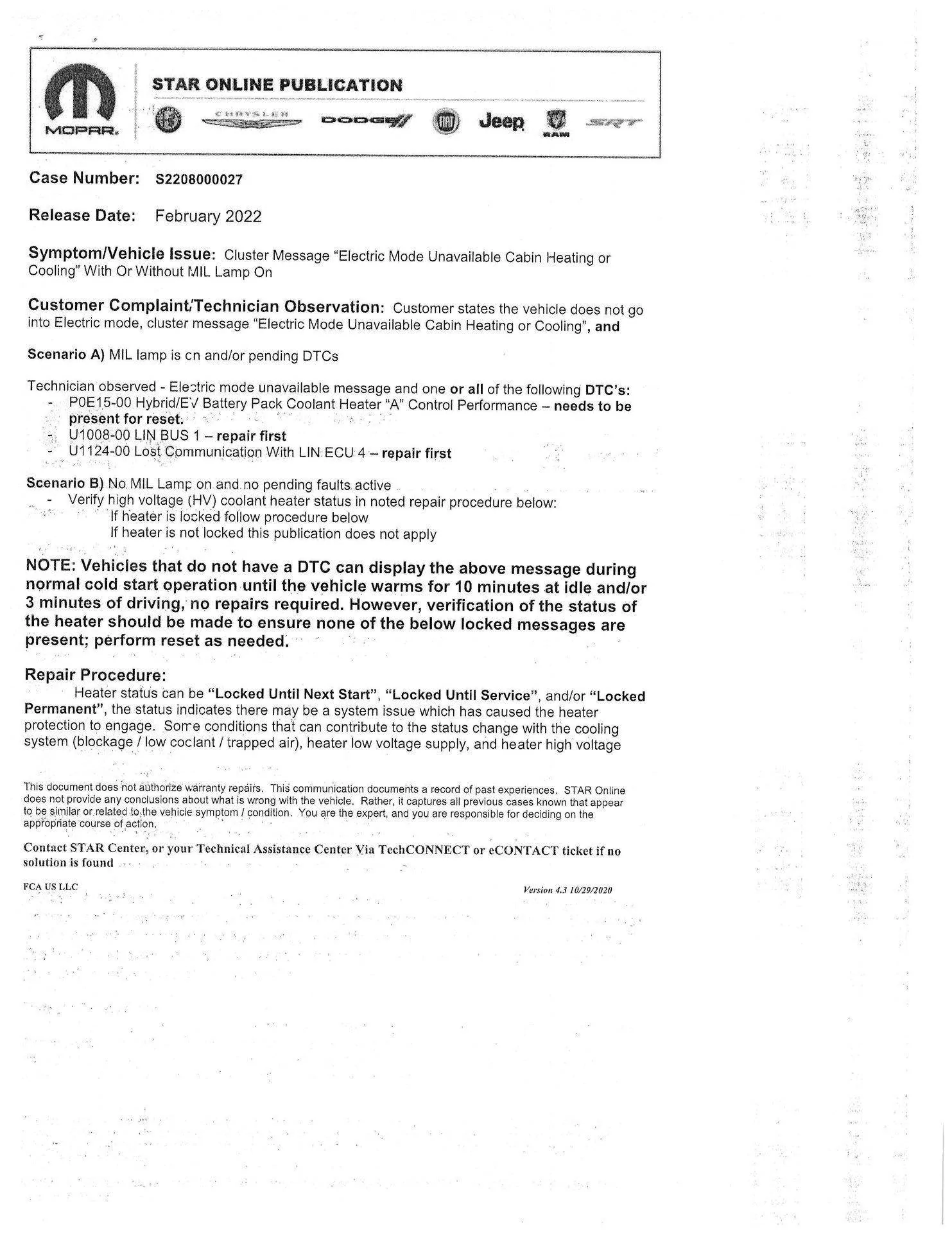

Where did you find the procedure to test the heater? I am having the same issue and would love to narrow it down to the heater or coolant pump!Finally I got online and found the procedure for testing the heater, made a photocopy of the owners manual saying when the ICE is supposed to run.
