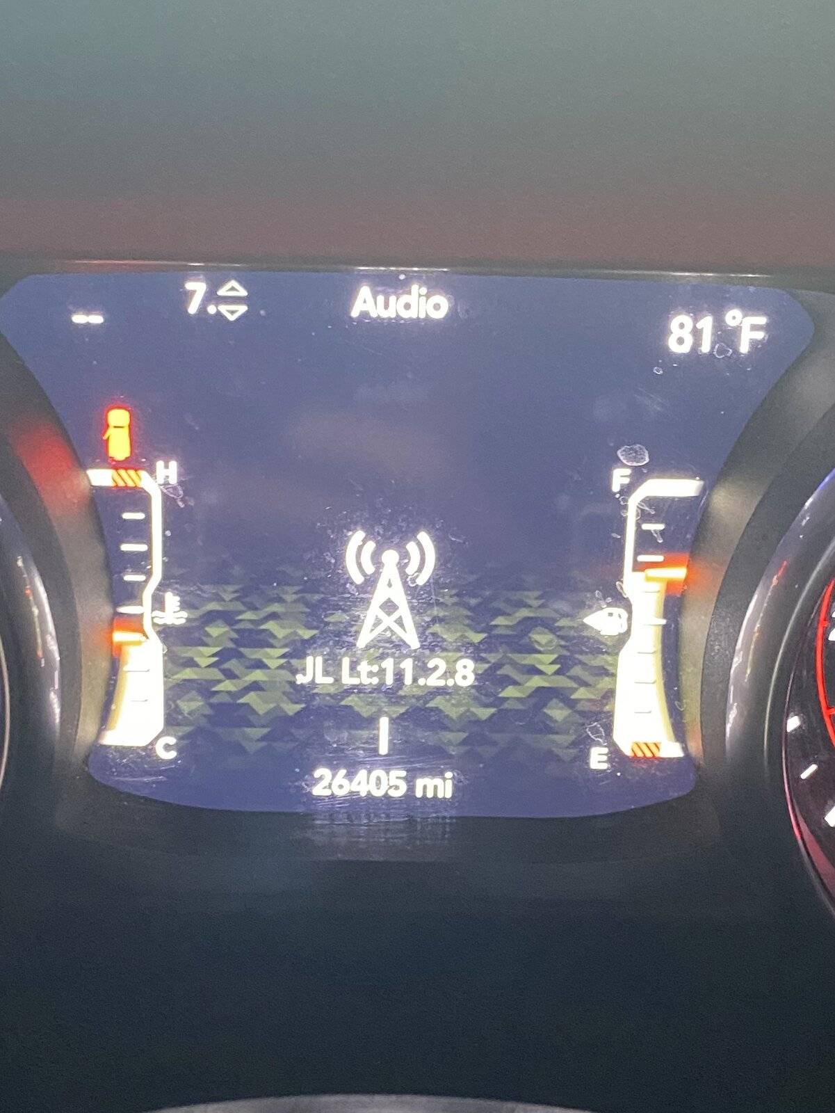

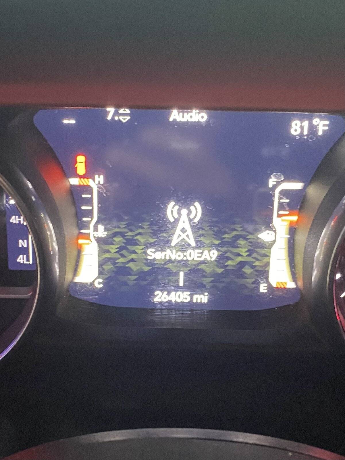

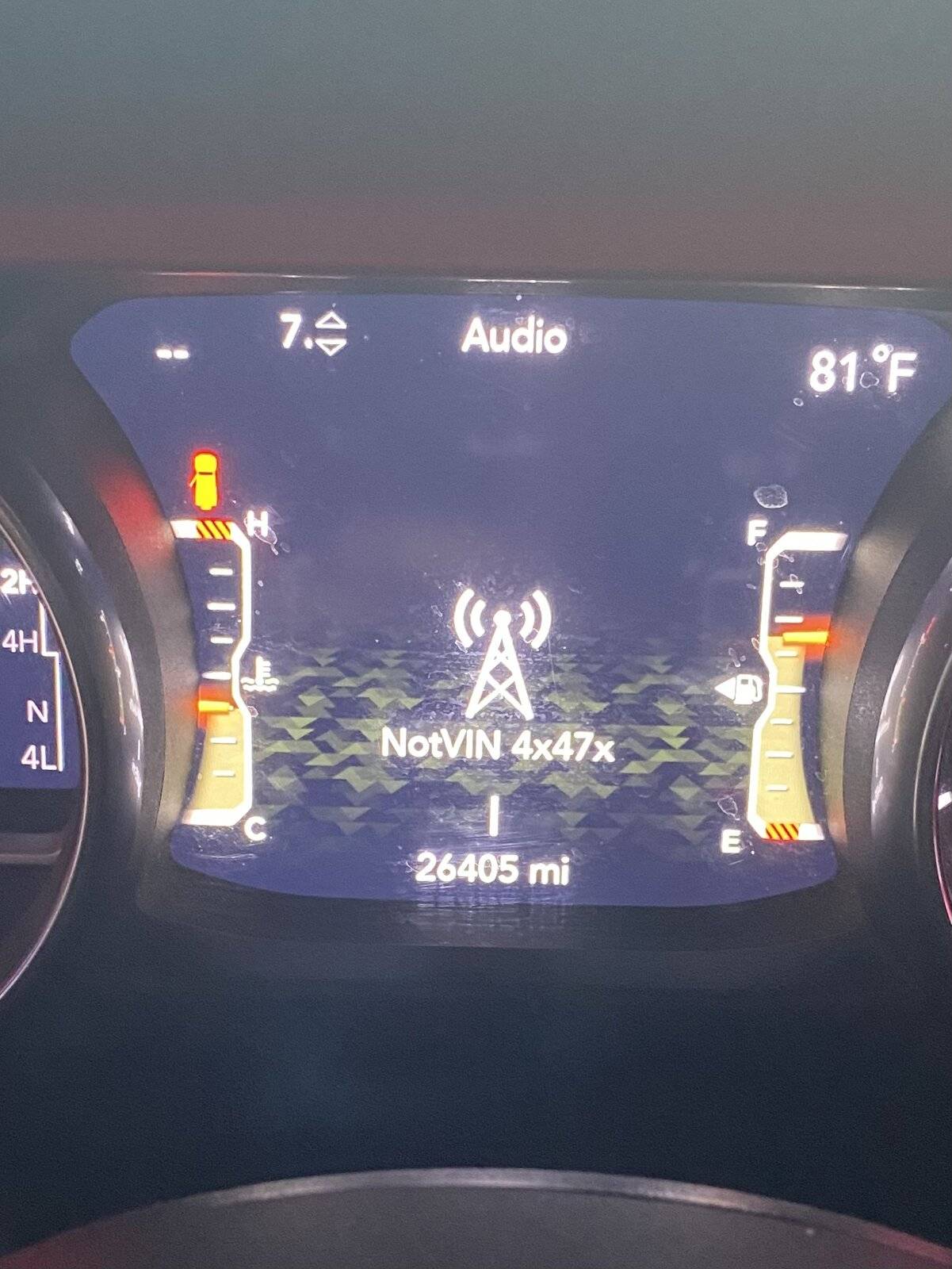

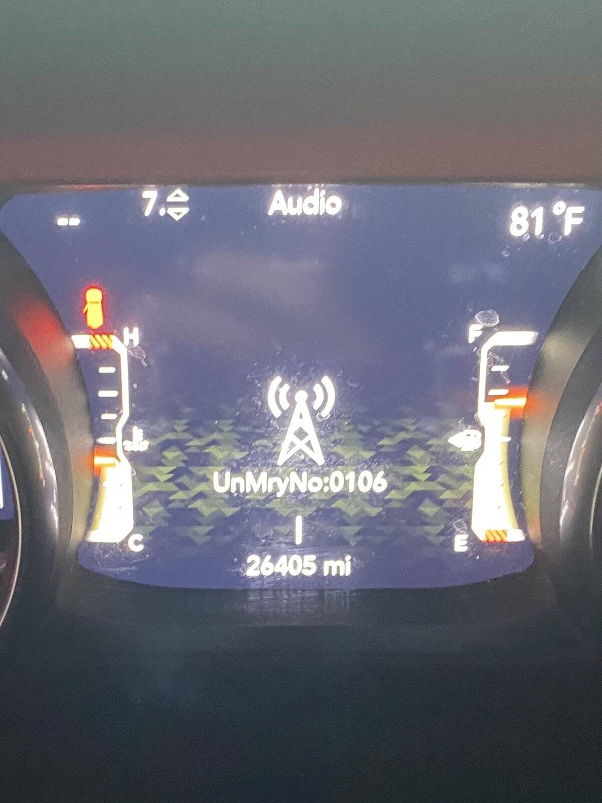

Quick overview, Ive owned this Tazer Lite since I bought my JL in 18’. Purchased new from Zautomotive. I haven’t done anything but change tire size and that’s it. Haven’t really kept up with the updates or anything either (Why fix it if it ain’t broke)
Anyway, wanted to unmarry it becuase I have to take it in and have all of the recalls done. Removed the old program from my Mac and installed the latest. then updated the Tazer to the latest, first to 11.3.0 ( Had the follow issues with both versions) and then back to 11.2.8.
The following pics are what I end up with. It doesn’t look like it recognizes the vehicle or the VIN and it doesn’t give me the option to unmarry it.
Any help would be appreciated. TIA

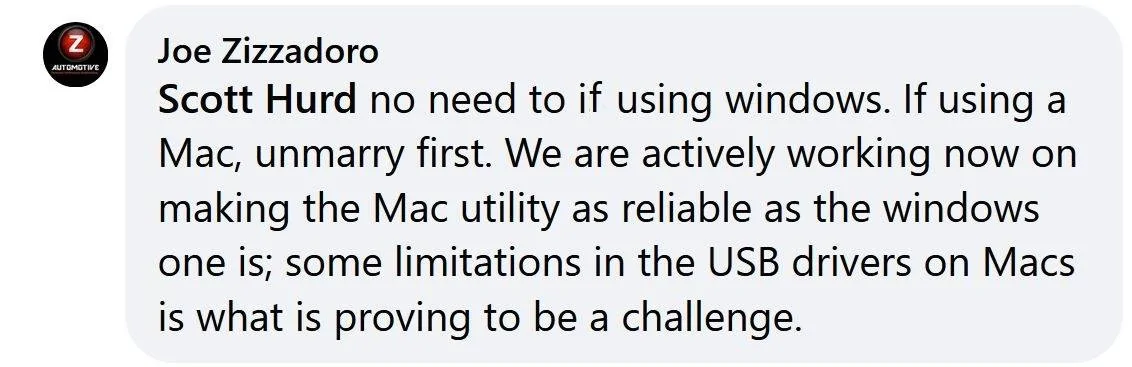

In regards to whether to unmarry before you do a firmware update... If you are using a Mac..... YES do always unmarry first. Even with a PC, I myself would unmarry...
Joe posted this and has made made similar posts in the past.
Jeep Wrangler JL Unmarry Tazer Lite unmarry
