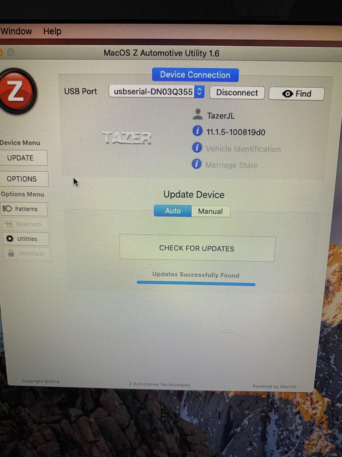

Hey folks,
Looking for some guidance or help. After about a year I decided I better update my Tazer , long story short with Zautomotive being ZERO help, I updated my Tazer but then I plug it back into the jeep I can’t get the menu to come up or anything whatsoever.....Any help would be appreciated.

Ya, it was set to Audio when I’m trying to enter the menu.
What happened was I updated it using an older version of the device utility. Then I realized the website says use the newest version. Had issues getting that installed on my MAC but finally did and then updated the Tazer......Now it doesn’t show when I plug it back into the JL

Not sure what you mean by no help, Joe normally goes out of his way to help anybody but he’s a small outfit and I’m sure he gets behind sometimes, stupid question but did you unmarry the Tazer before updating and then attempt to marry it back to the JL
Yes, unmarry it... After you update it... plug into Jeep then remarry it and go through the menu to see what version your Jeep says it is 11.1.5. But the bad news is you now have to setup all your things you did. So I printed the instruction and marked the items I wanted to change.
