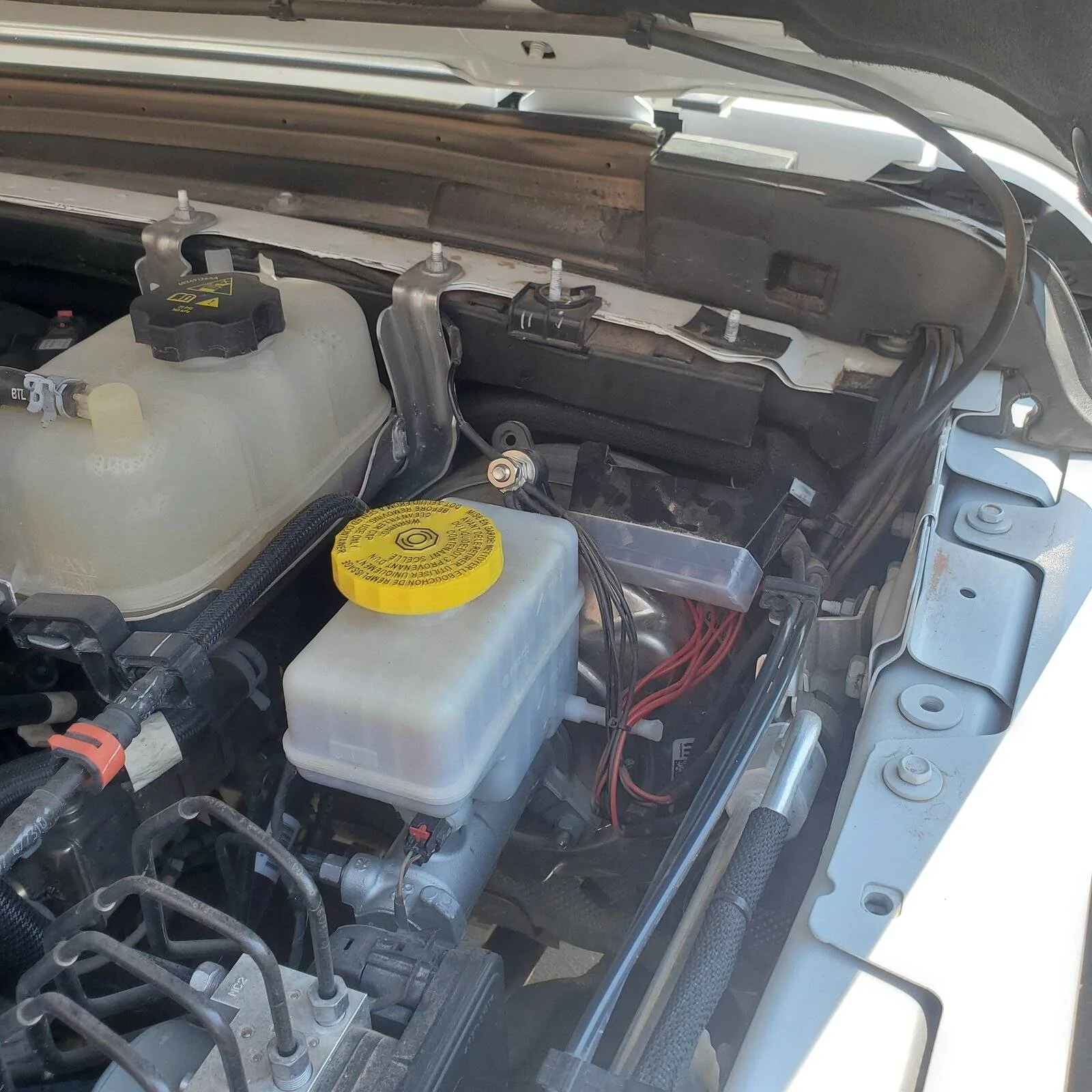

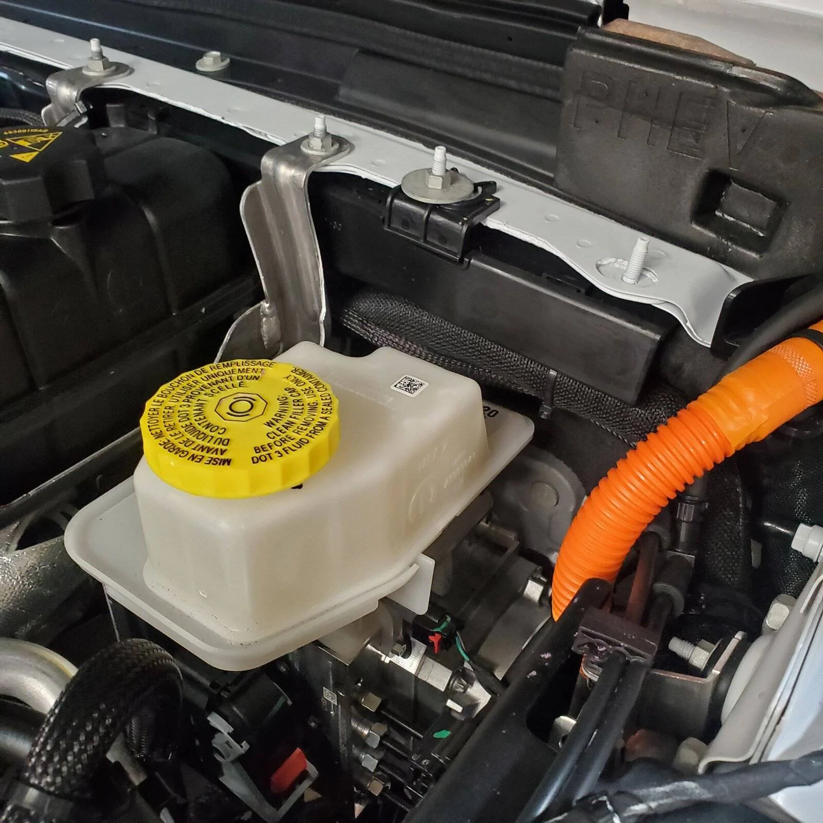

Alright, here's an update for everyone.
I met up with @Terminex today because we both live in Omaha. He just picked up a new 4XE so I wanted to do a test fit with both brackets. The ground bus bar bracket will work. The 4XE has the same holes in the passenger fender.
However the 'rock light' bracket on the driver side, does not look like it will fit. (I didn't have the brackets with me because the fabrication shop currently has them so they can draw them up, I did have the CAD drawings though) I have a 2019 3.6 (non-etorque) with a standard brake booster. Apparently the 4XE doesn't have a standard brake booster and appears to have a vacuum pump instead. The entire brake fluid reservoir, abs system, and vacuum pump all sit closer to the firewall which appears to get in the way of the bracket.
Here is my Jeep. (Ignore the loose wires because I don't have the bracket installed)
Jeep Wrangler JL Underhood Wiring Brackets - Gauging Interest 20210705_142556
Here is the 4XE. You can see the 2 differences in the brake system.
Jeep Wrangler JL Underhood Wiring Brackets - Gauging Interest 20210705_143858
I'll be able to confirm with 100% certainty once I get my brackets back from the shop this week.
Is there anyone with a different engine configuration (3.6 E-Torque, 2.0 non-etorque, 2.0 etorque, 3.0 diesel) that might have a different braking system that either of the 2 pictured above?

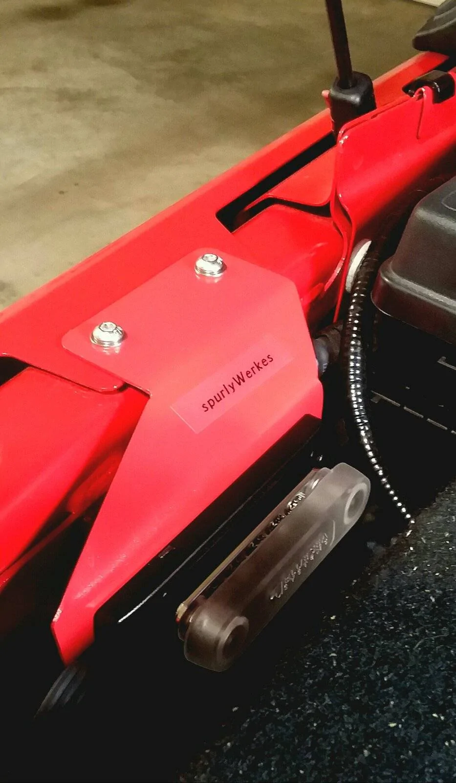

I painted and installed the ground bus bar & bracket. Thanks to @spurly for the effort. I used a Honda touch up paint that is a closer match to Firecracker Red than the lighting in the photo suggests.
The label is my own addition. ;)
The bracket doesn't make contact with the pneumatic strut when the hood is closed. There's also fair clearance between the bracket and the factory grounding studs that are now underneath the bracket.

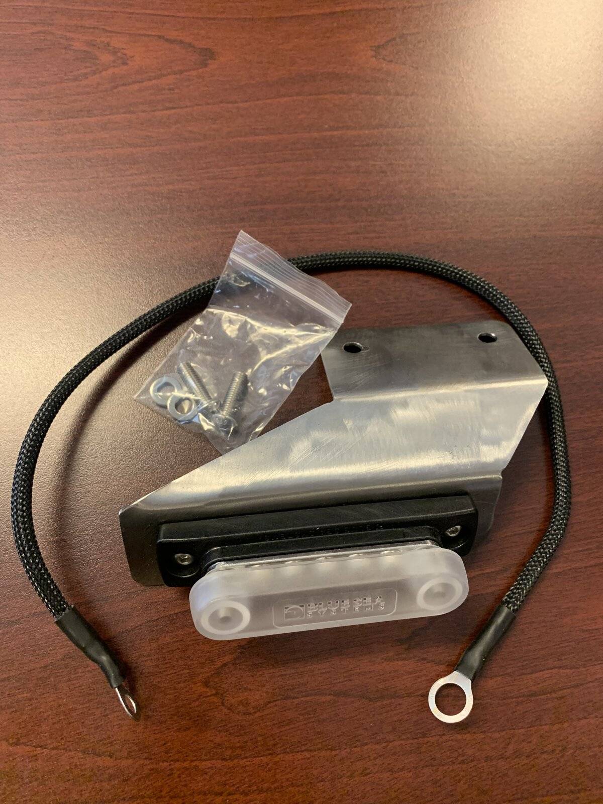

My kit came in the mail today! Holy cow this thing is seriously top notch quality. I do not have any accessories yet but i am sure glad I got this ground bar bracket!!
