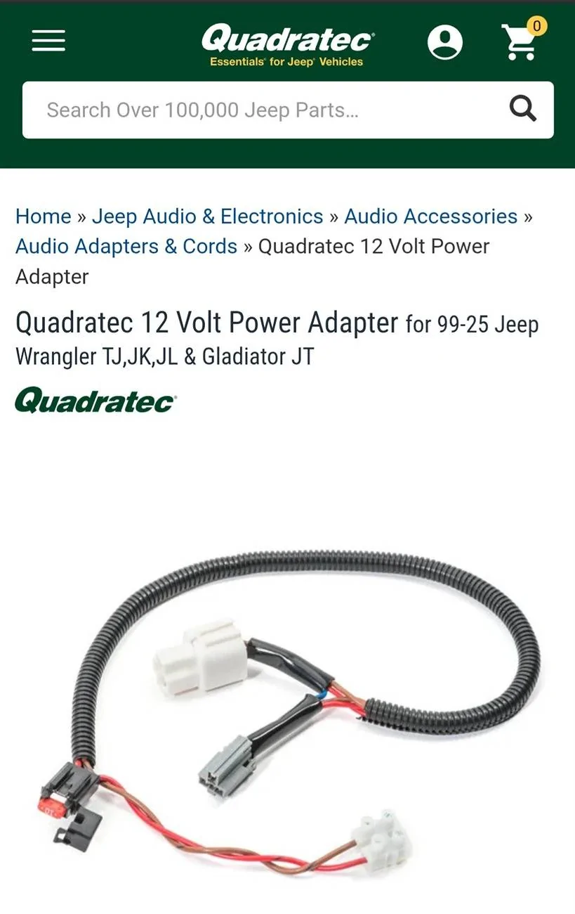

To add extra USB outlets I installed a splitter cable on the back of the cigarette lighter. Then powered a dual USB outlet under the steering wheel behind the plastic panel.

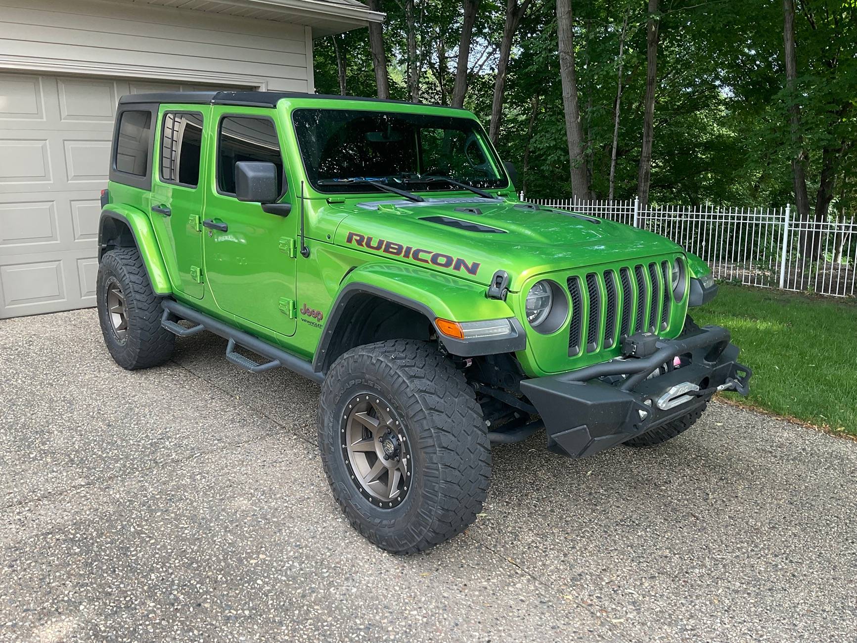

My plan is to put one of these up in the top of the dash in that little cubby. I need a USB-C outlet up there to power my tablet running GAIA when I'm traveling/off-road.
Nice looking Jeep!
A slightly cheaper alternative is This one

The splitter Cable mentioned above is the best easiest option for adding additional ports. You could then install the ports anywhere convenient, even removing the Media hub and using that area for ports. If you have Aux wires, that's another option for powering ports with control on when they are powered.
