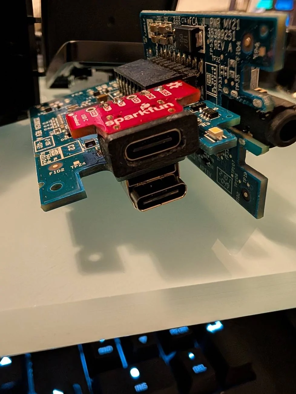

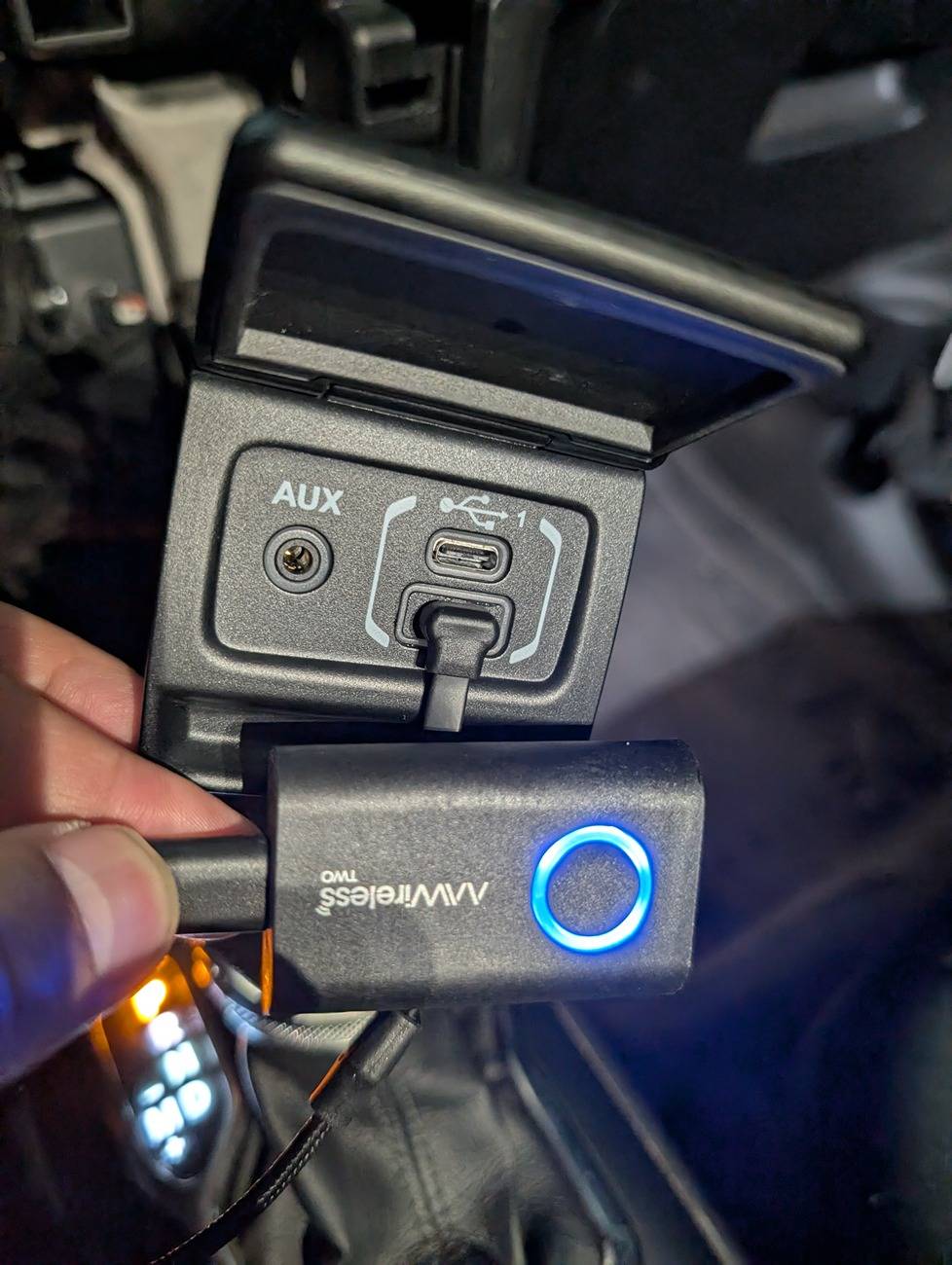

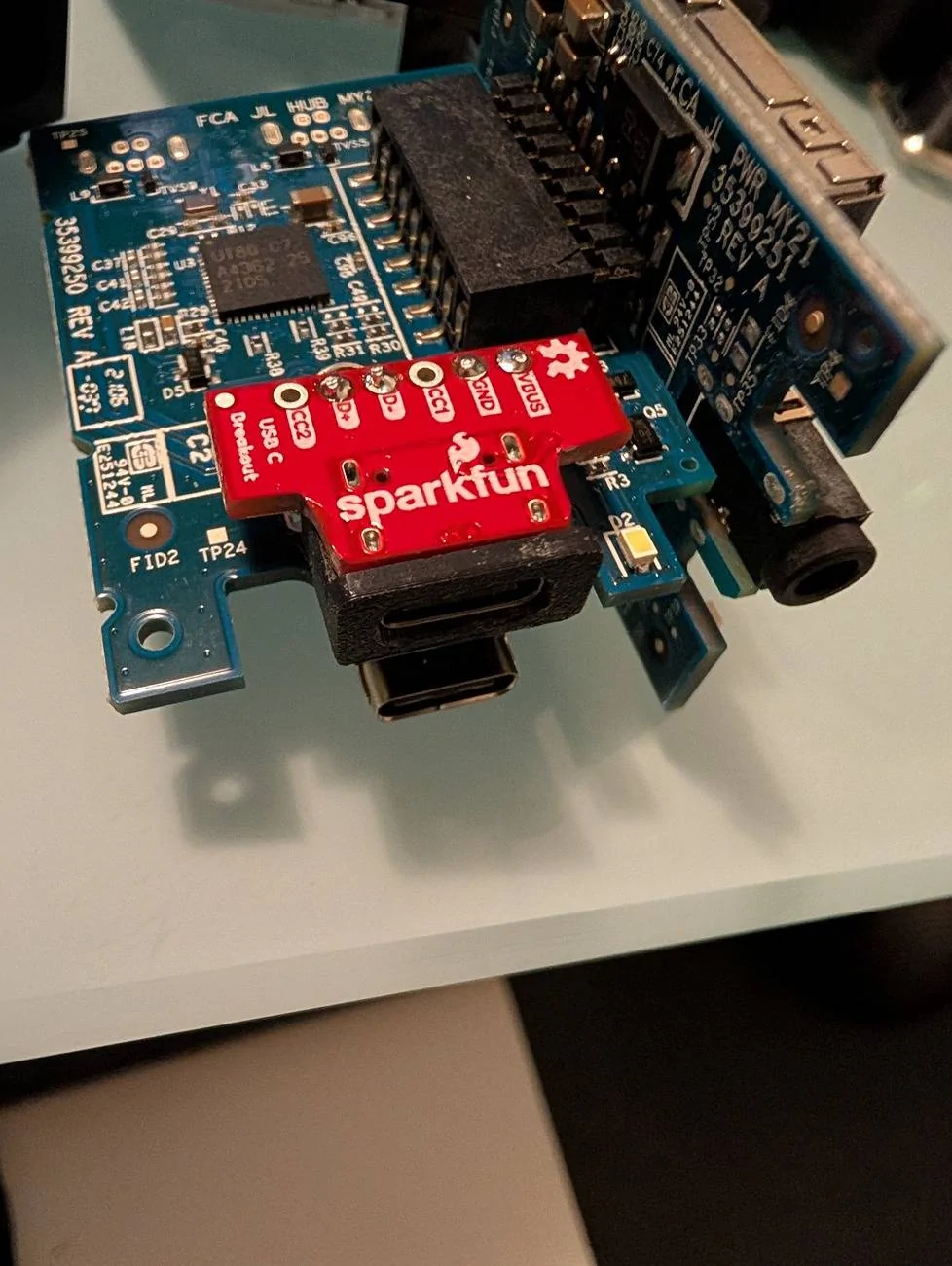

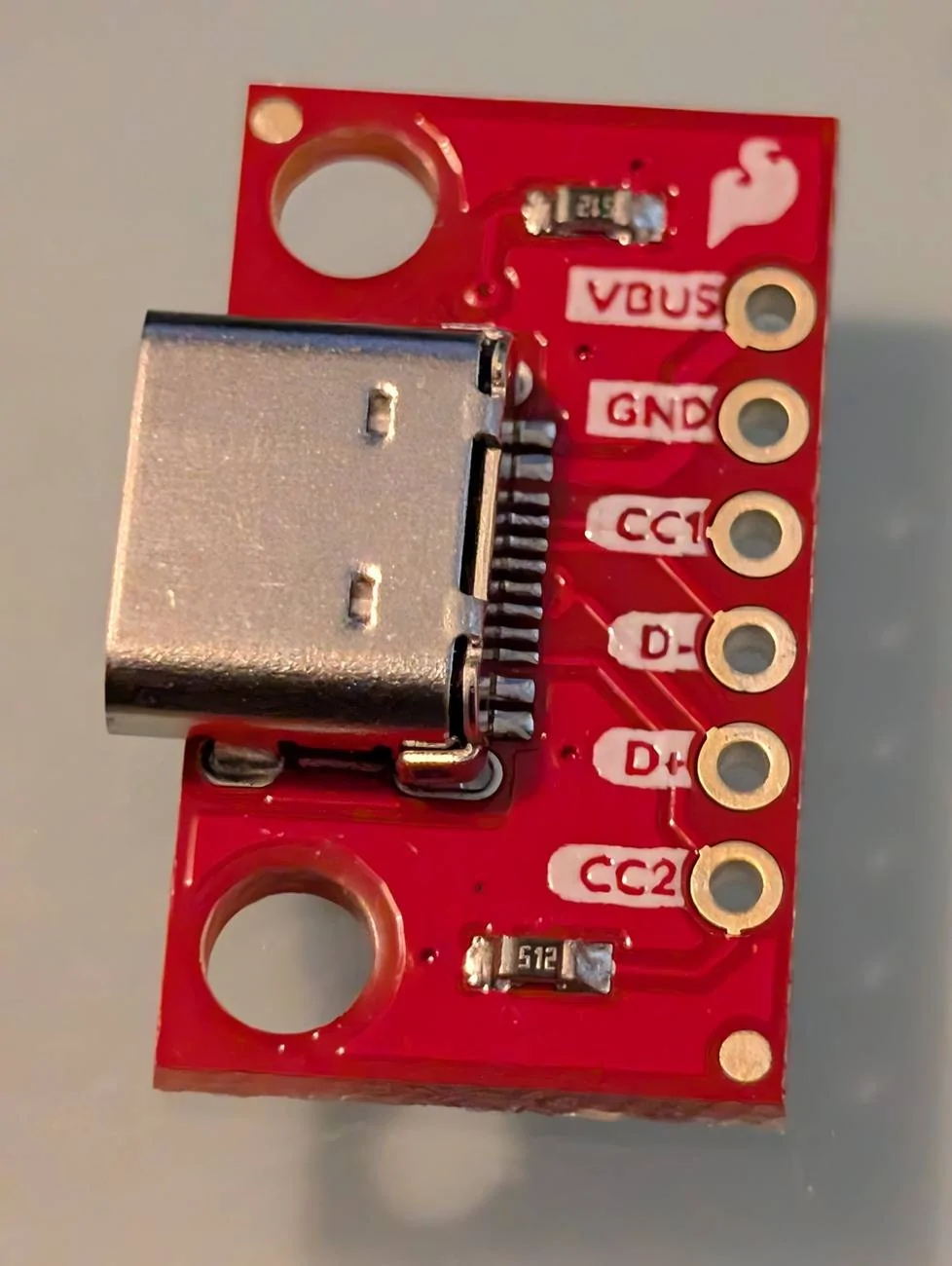

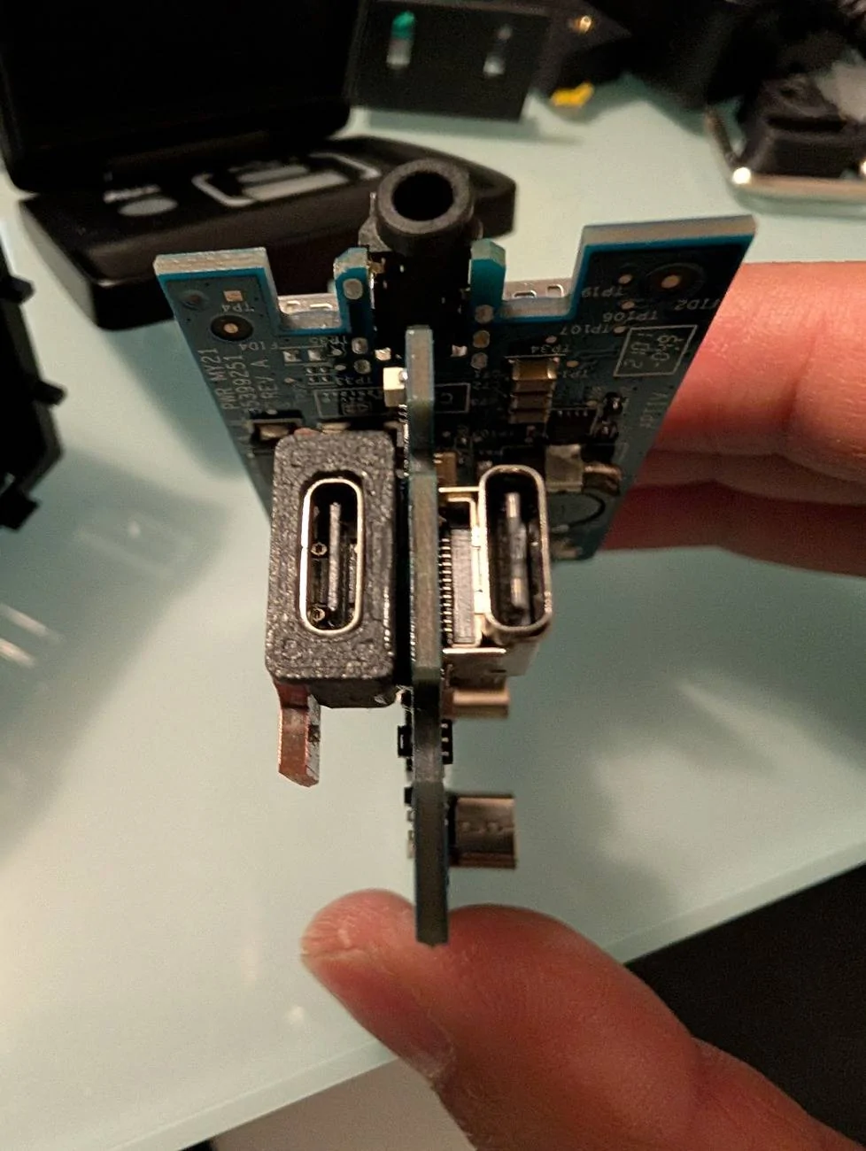

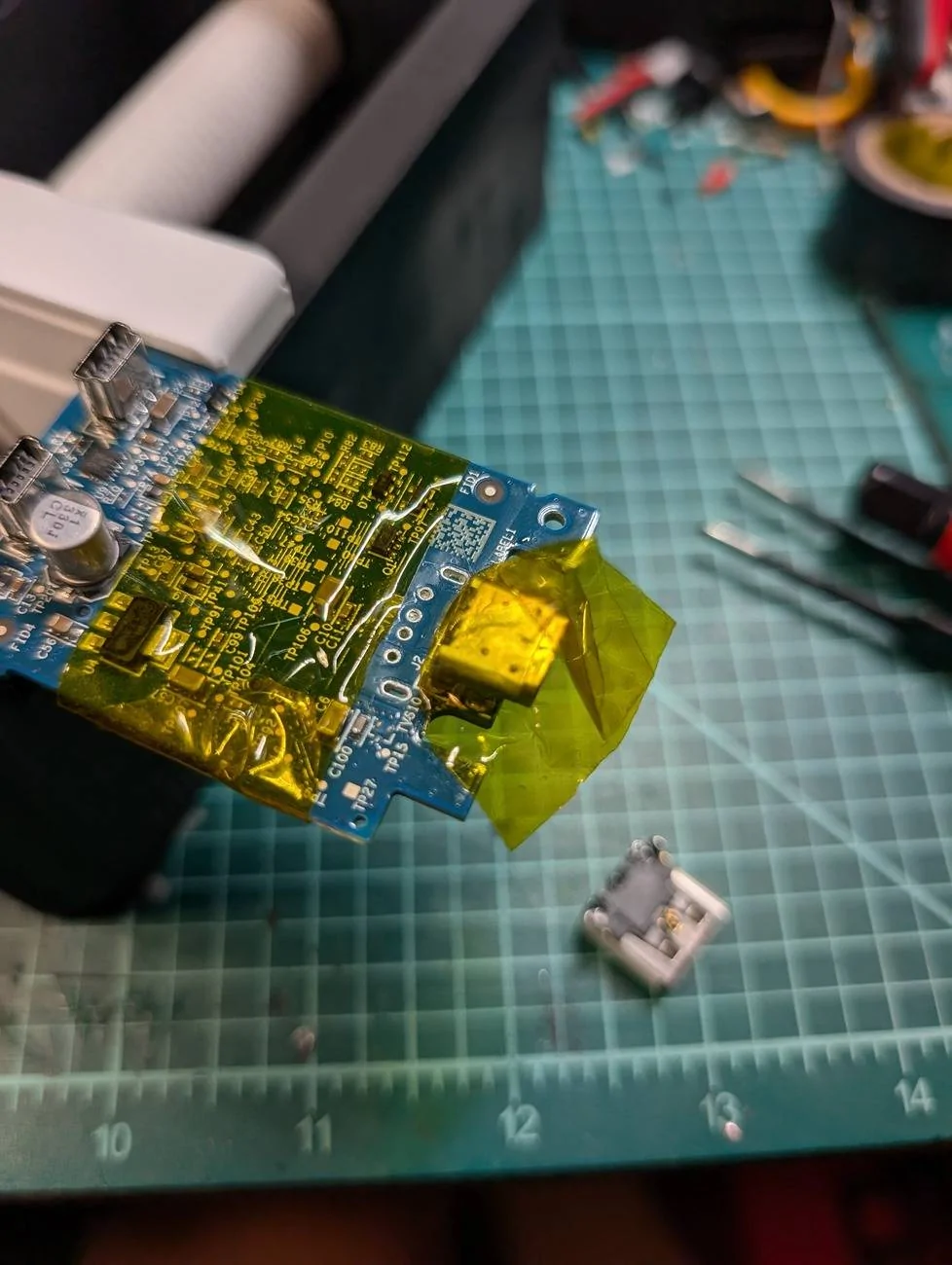

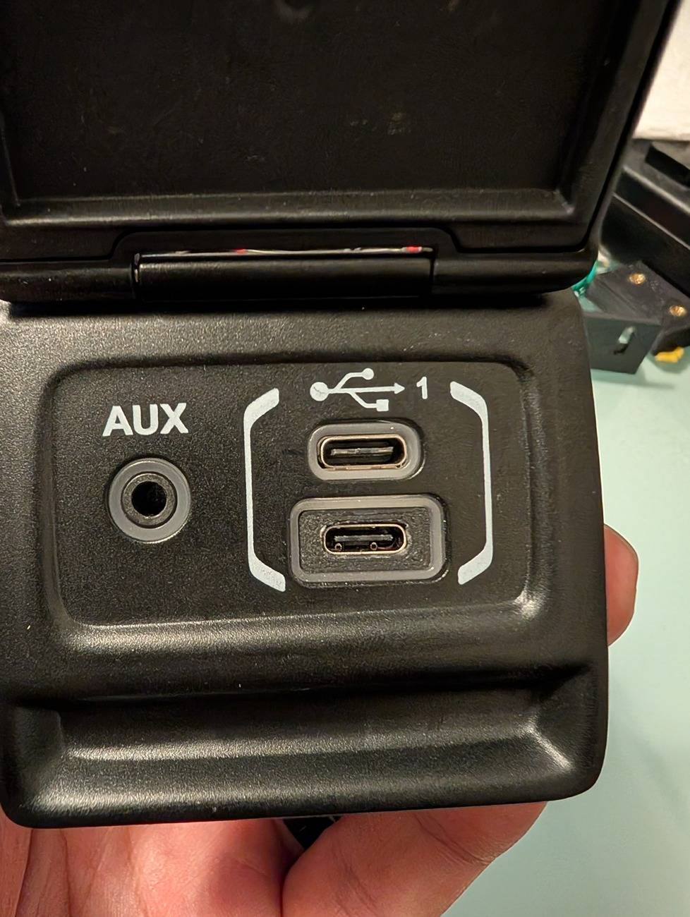

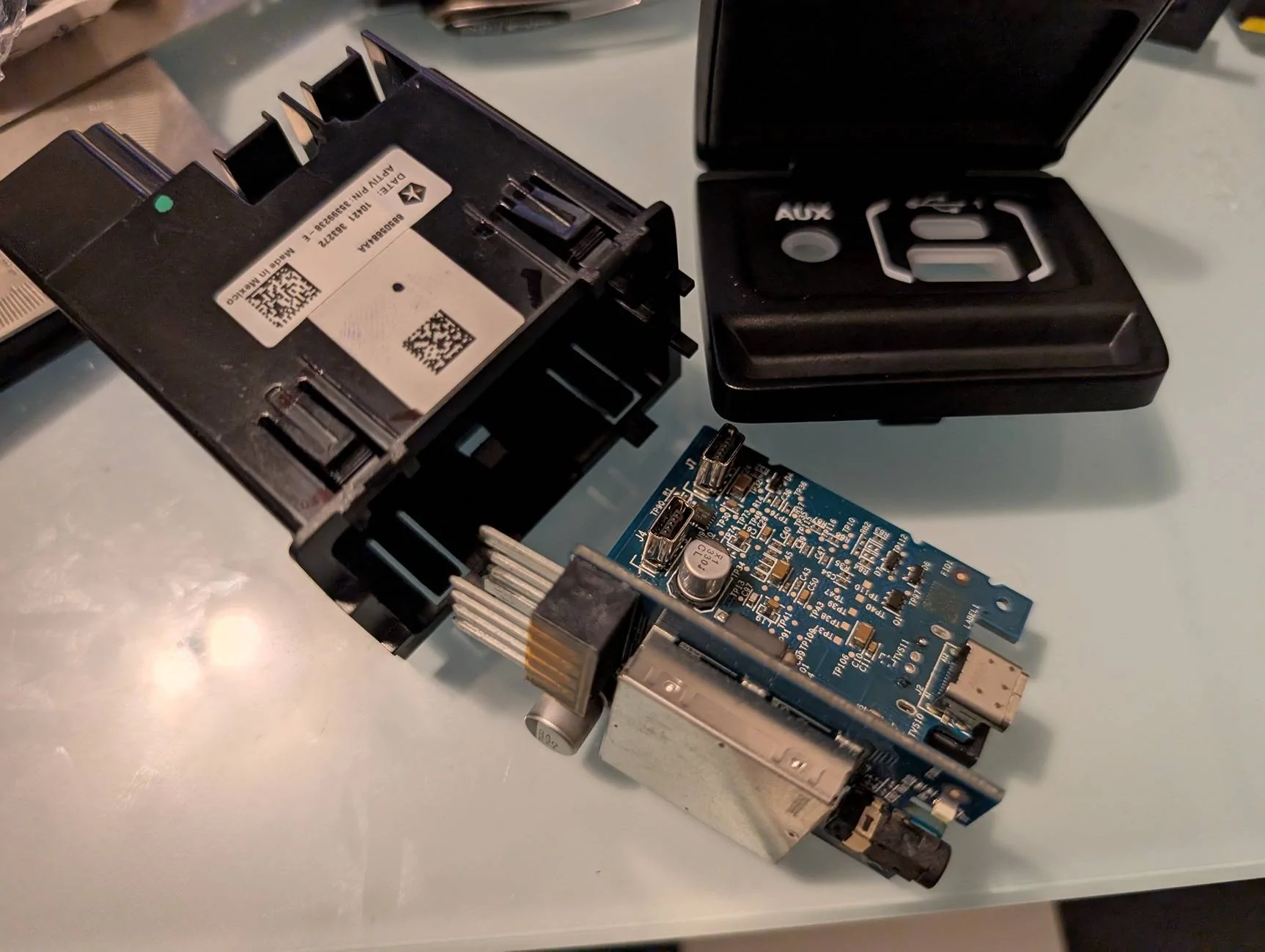

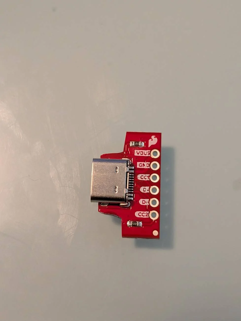

I was bored and had some spare cycles, but to answer your original question @donmontalvo, yes you can swap out the USB-A female receptacle for a USB-C female receptacle. I had a SparkFun USB-C BOB (break out board) for some other project that never got done, and modified it to fit. 3D printed a filler and soldered it up. Since USB-A only uses 4 wires, you won't get any sort of high-speed charging out of it, but the port is usable for data and basic 500mA charging.

may I ask? which one is conected to black mini usb?
agentdr8
Dave
Mar 13, 2025
182
223
CA
21 JLU Willys
I traced it, and it goes to the center console USB port.
