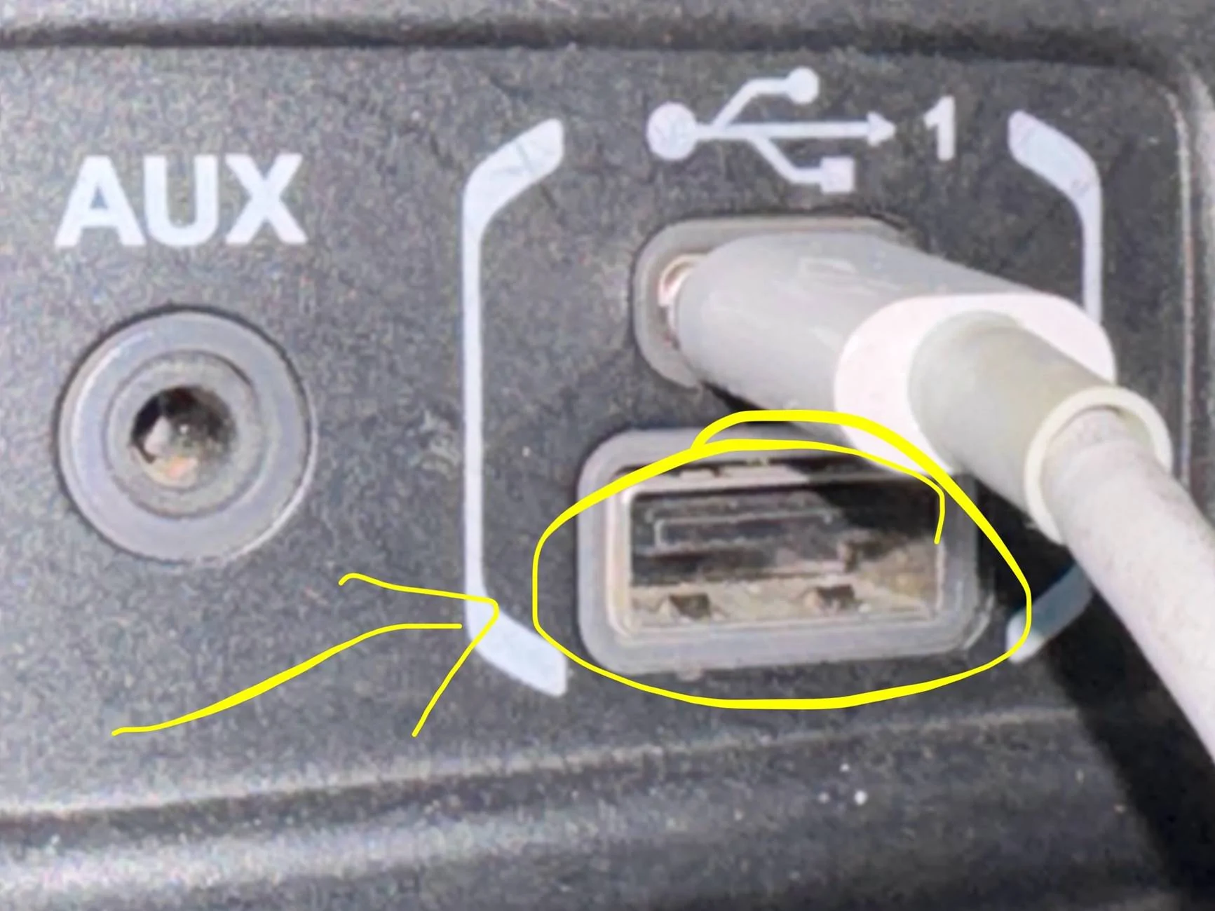

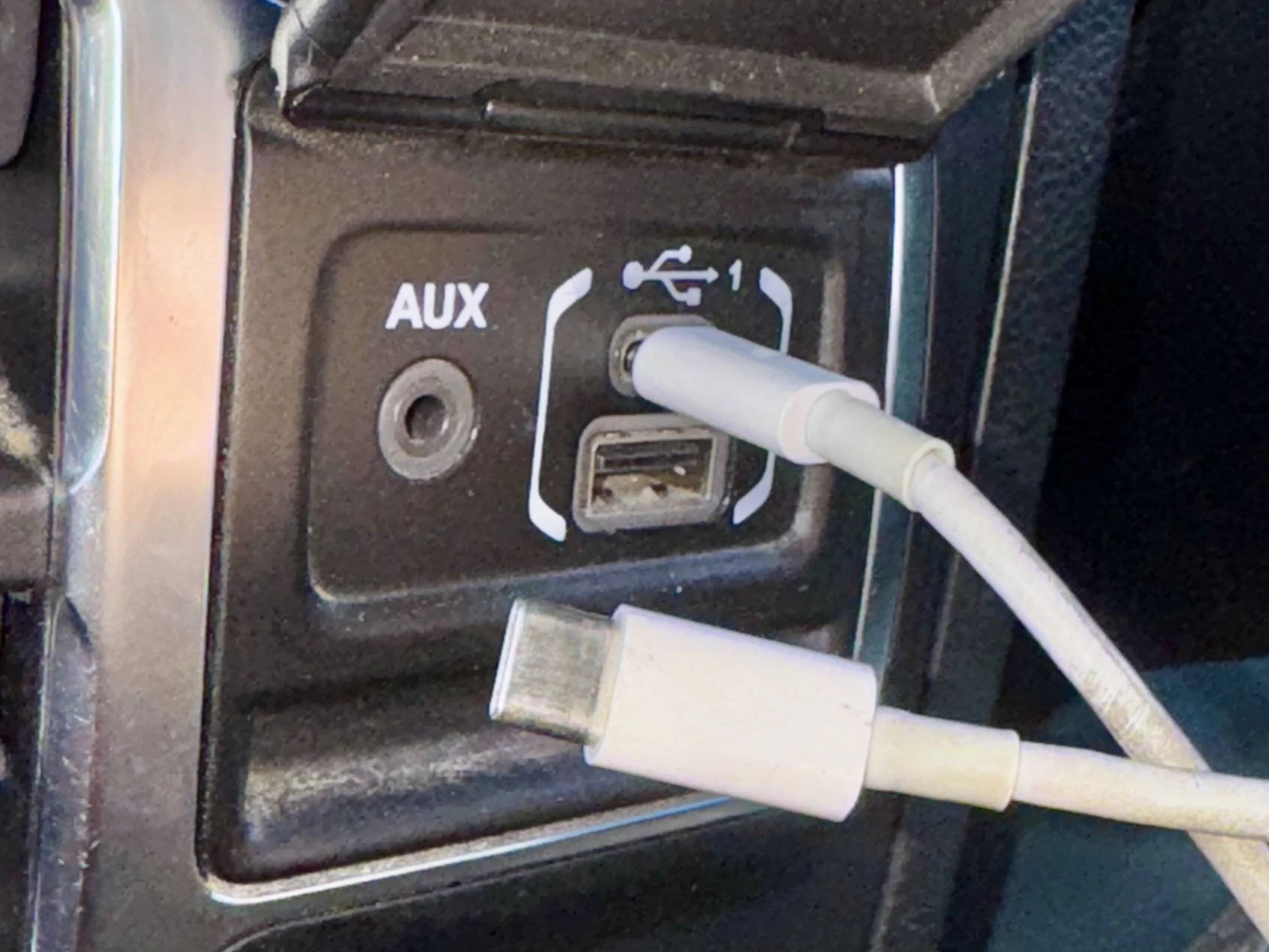

I haven’t owned a USB-A device in years. All my devices are USB-C.
Is there a mod to replace my USB-C/USB-A ports on the dash with
USC-C/USB-C ports?
I am not a fan of Accessory Port adapters, or any USB-A to USB-C adapters, etc…just checking if the USB-A port can be removed and replaced with a USB-C port.

The other easy method is to get a USB-A to USB-C cable.
AFAIK, nobody makes a replacement media panel with 2 USB-C ports. If you're handy with electronics, you could probably swap out the USB-A port with a USB-C port, but would likely require some customizations.

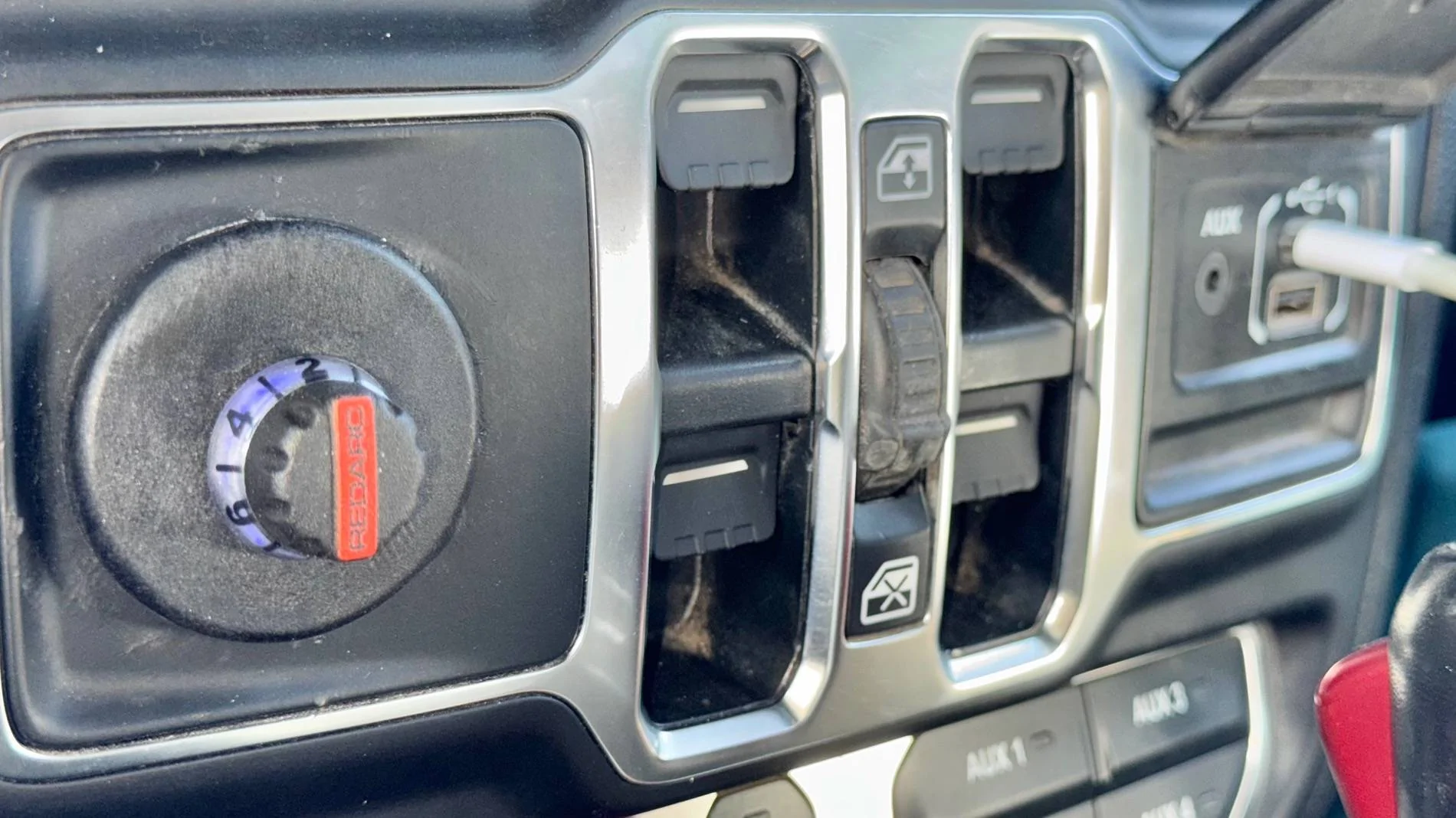

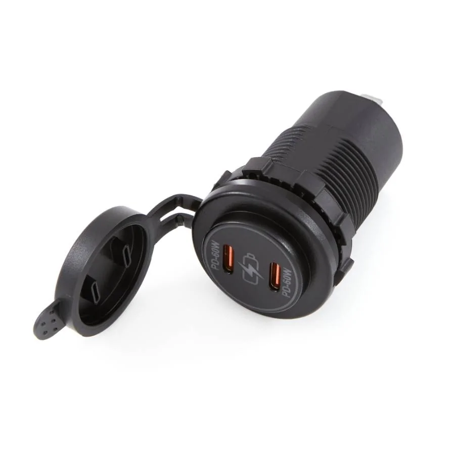

My plan is to put one of these up in the top of the dash in that little cubby. I need a USB-C outlet up there to power my tablet running GAIA when I'm traveling/off-road.
Nice, I did a similar mod to my old YJ.
@donmontalvo nobody makes a direct swap for that spot. Your only choice is adapters or to make your own hole and use the one above.

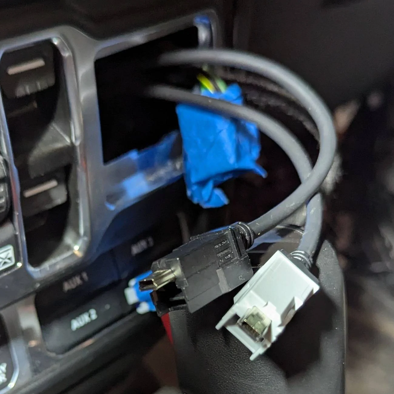

Per @THAW the connectors that plug into the back of the media hub are micro USB. And his pic in case it helps
I had my console panel removed earlier today and noticed the Mini B plugs. My goal is to swap out the USB-A port for a USB-C port, without losing CarPlay capability on the top (“#1”) USB-C port. Wireless CarPlay is a joke from what I’ve seen.
I think I will run a Powerwerx dual USB-C QC 4.0 connector to the front of the center console storage area, facing the cupholders. Will post whatever I come up with.
On a side note, funny how you seem to have your Accessory Port wire taped off with blue painters tape. I removed my Accessory Port so I could install the Redarc dial…but I used black electrical tape to isolate the same wires. :)

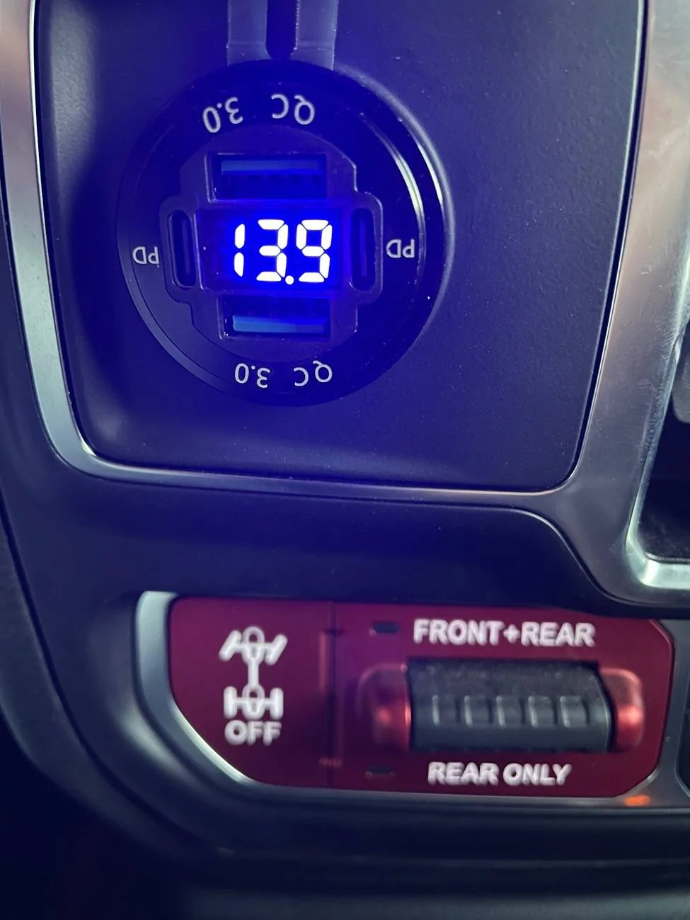

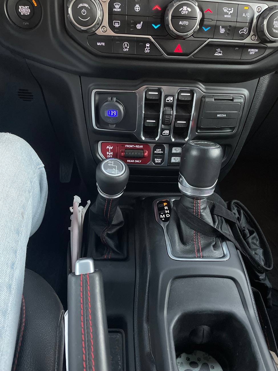

I did this.
It has 2 usb-a ports and 2 usb-c ports
Gregj
Nice, and clean! Unfortunately I have my Redarc brake controller dial there, so I can always glance at it.
