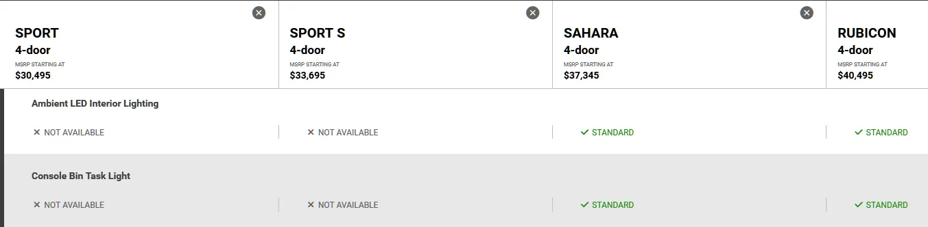

Confirmed that the left control doesn't work. Big thanks to @bam1111, we meet up yesterday and he showed me how the accent light works on his Rubi (6SP MT & 8.4''). Apparently, it only works when it gets dark outside/or maybe when the auto headlight is on.
BUT we were able to confirm that my left control doesn't turn on nor control the foot/accent light in any conditions. I have a sports with the 7'' screen & 6sp MT, not sure if it has anything to do with my options, or just some defective parts from supplier. @wranglerguyman so far we have the same issue, interesting to see if others experience the same which we might find a trend.

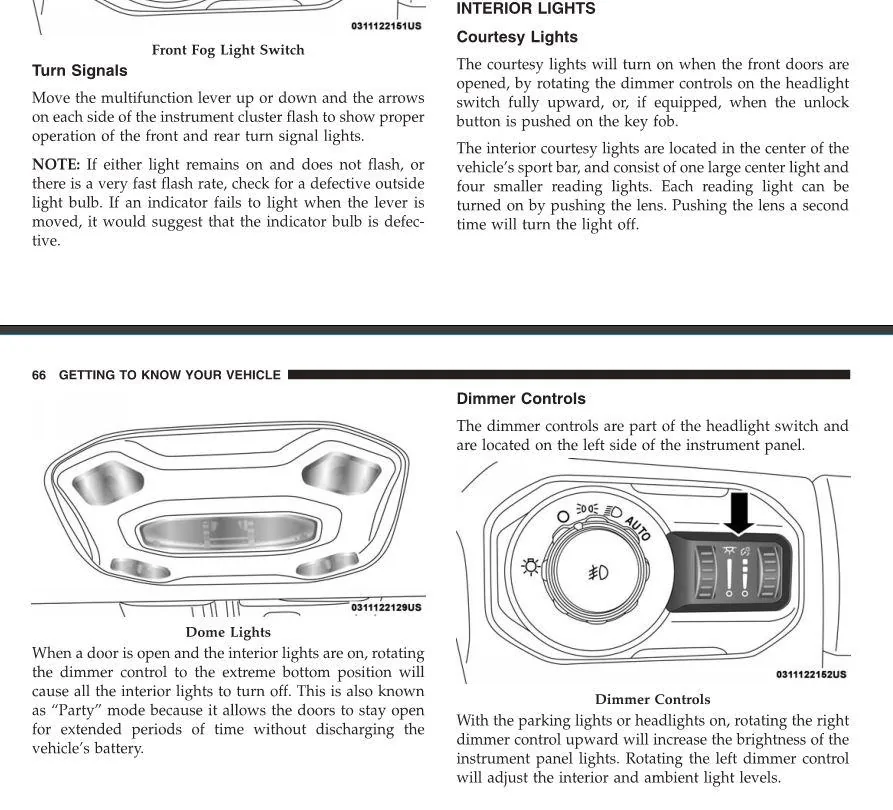

Also controls the accent light in the door handle... just figured this out...I swear the lights at the feet do not change for me though.
It’s faint. Not as bright as it would be if the right dial was clicked up. So once you get the right dial anywhere from the bottom to before the first click, you’re in night mode. That’s when you can use the left dial to control the footwell light. However if the right dial is clicked up then it won’t work as you are in day mode.
Basically we have to manually adjust the right dial depending on the time of day we’re driving. I wish Jeep could integrate that with the auto headlights. My ‘05 Infiniti does that, can’t see why an ‘18 Jeep can’t do that lol.

So the door handle isn't ambient Lighting? Or I have the package but it's super dim on the feet?
No clue on specifics. It does say LED Ambient Lighting. I would imagine the door handles are not considered ambient lighting. Foot wells would be considered ambient. Without the LED Ambient Lighting there may still be some faint light by the foot wells but not the same.

So that explains why Yutao's Sport wouldn't dim the footwell lighting.
I assume the dial on the left will dim the interior lighting in the Sports; just not ambient lighting. They need to place definitions in the manual as to what is ambient and what is interior lighting?

WOW Thanks for looking it up and sharing it. It's odd to me that FCA leaves the dial but not making it functional. It might even cost more to do it this way. But I am glad there is nothing wrong with my sports, and other sports owners can reference this to rest easy!

They have it there as it is not only for ambient lighting. From @bam1111 post it states the the left dimmer control will adjust the interior AND ambient light levels. So for Sport and Sport S this adjusts the interior light only. Somebody else said they have a light where the door handle is and I think they said this light is adjusted with that wheel as well. It does have a function.
