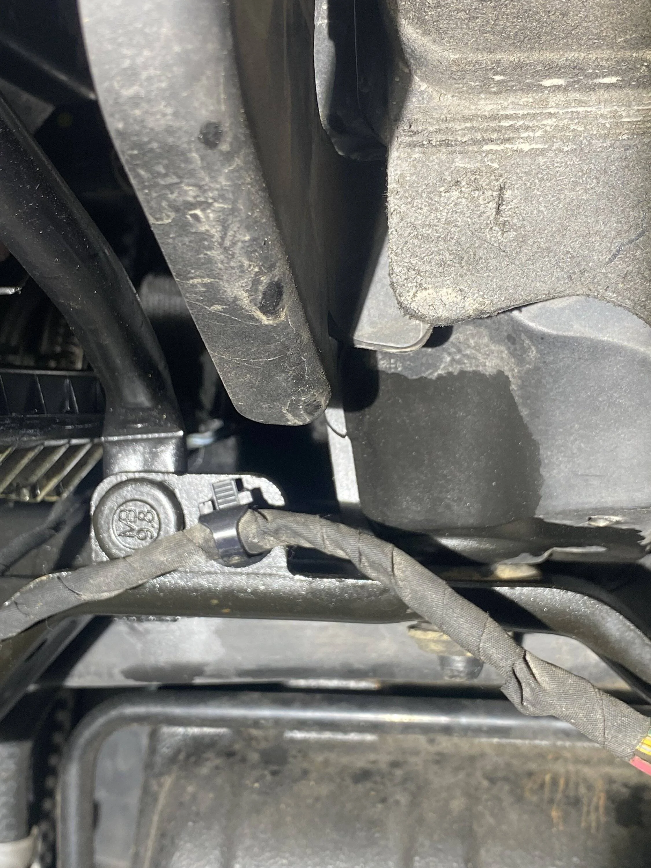

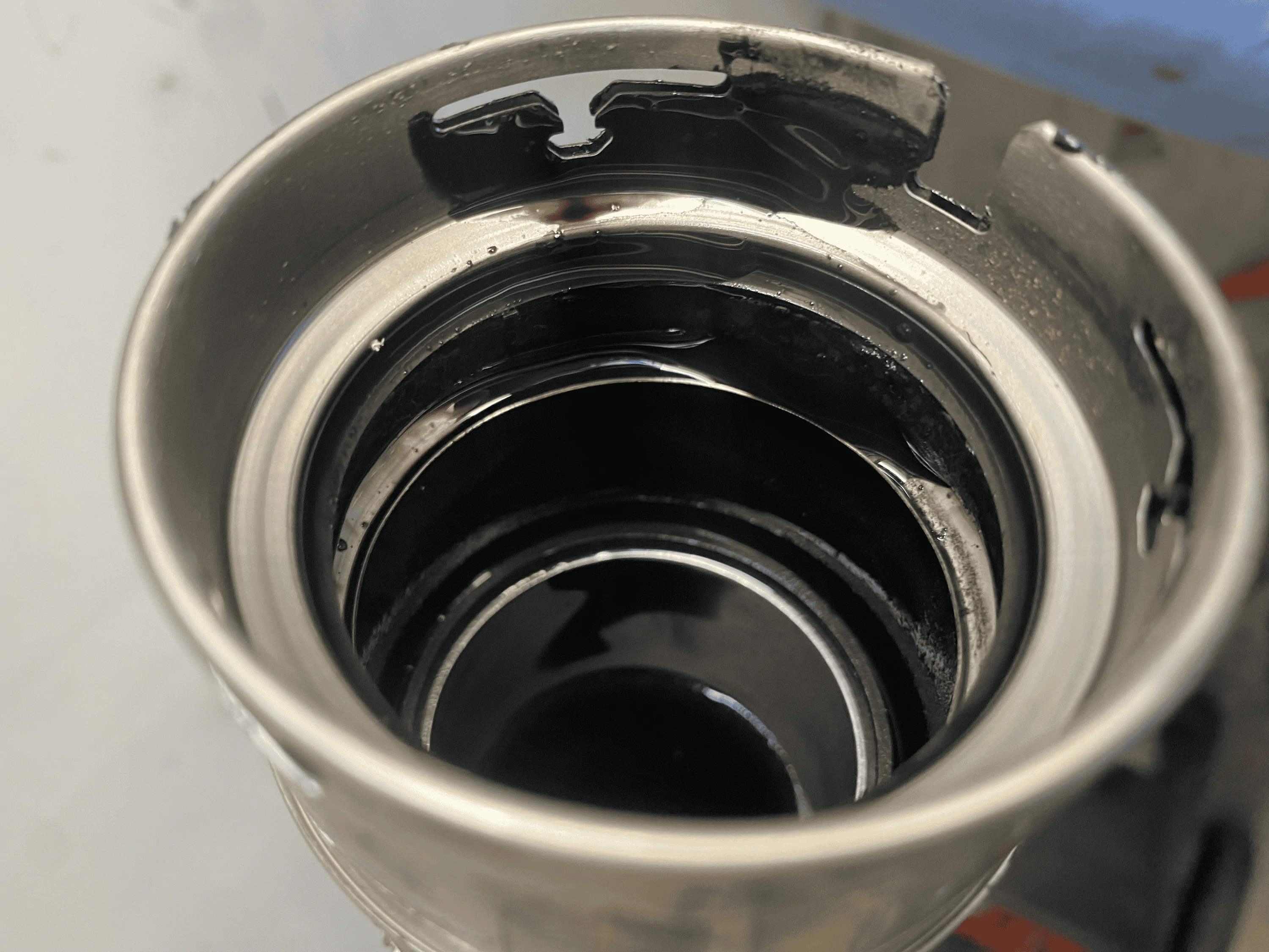

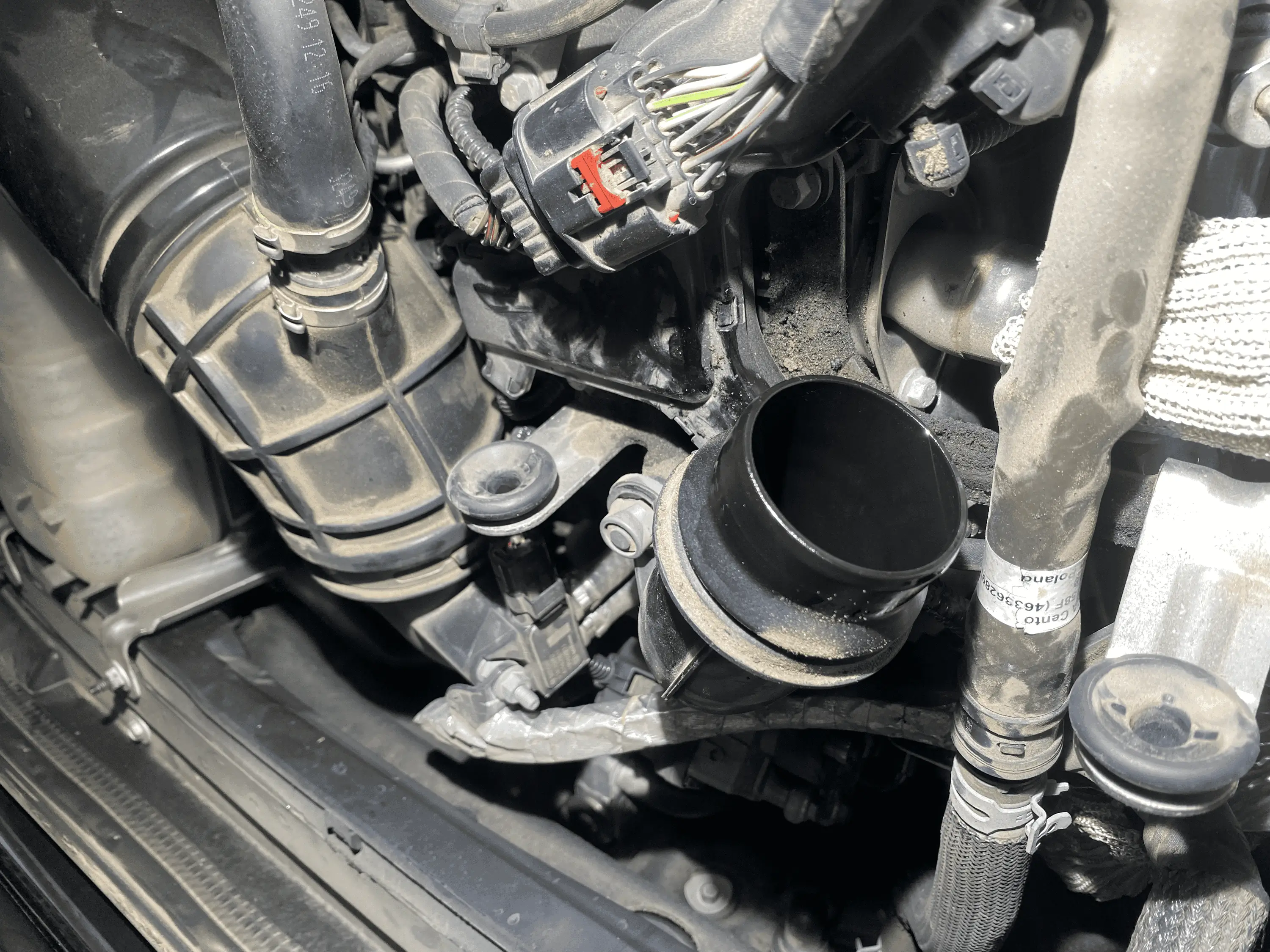

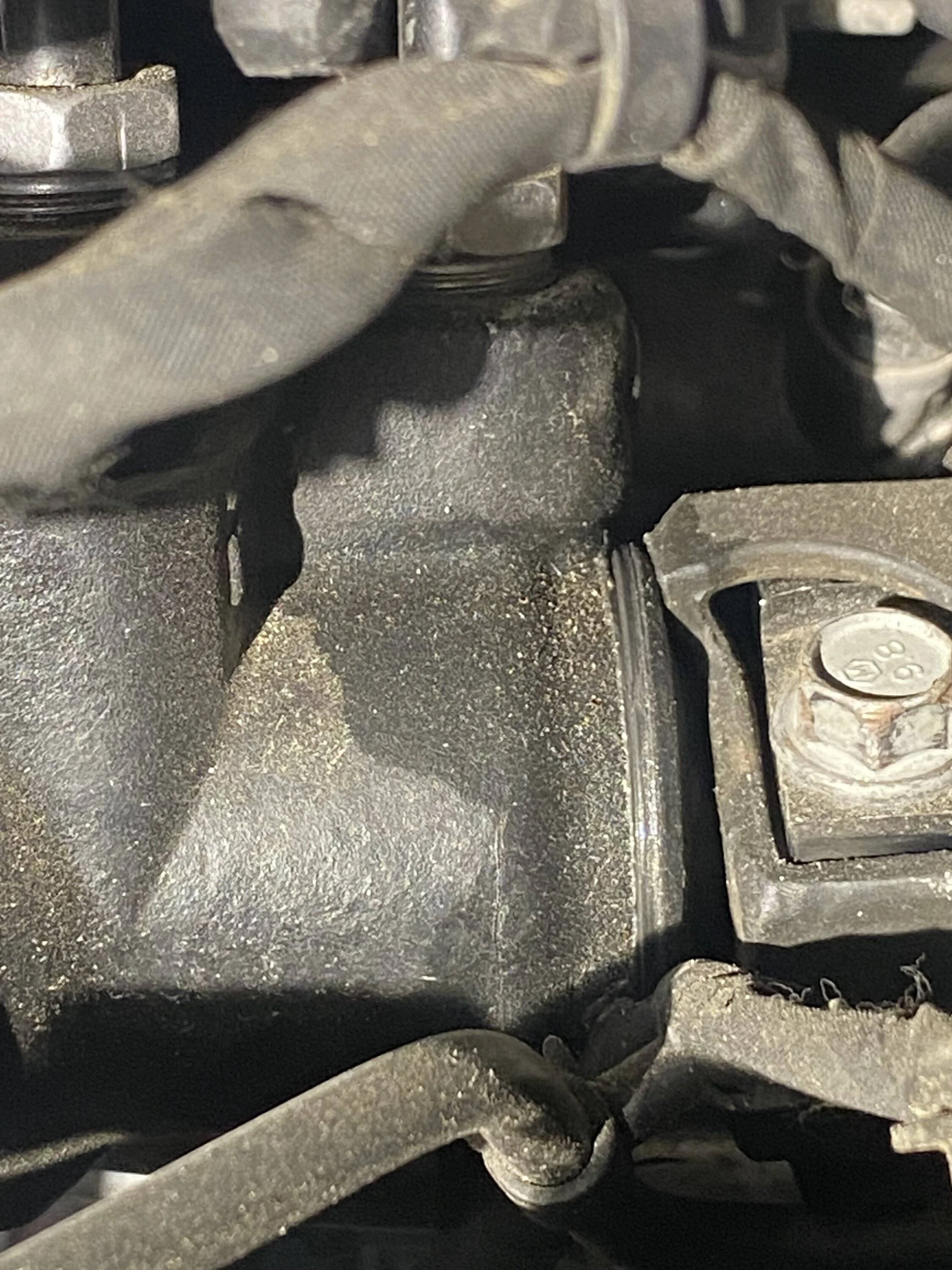

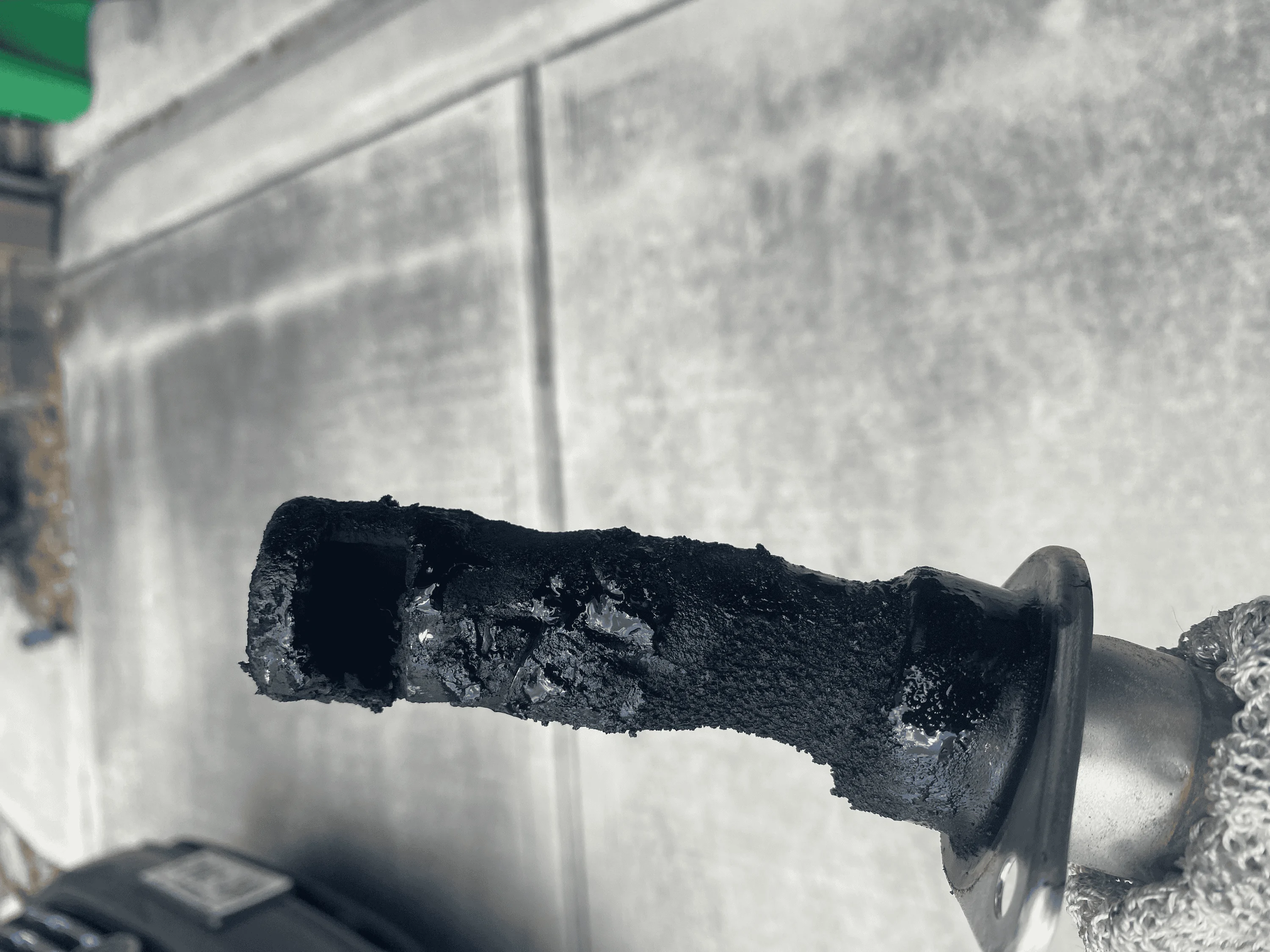

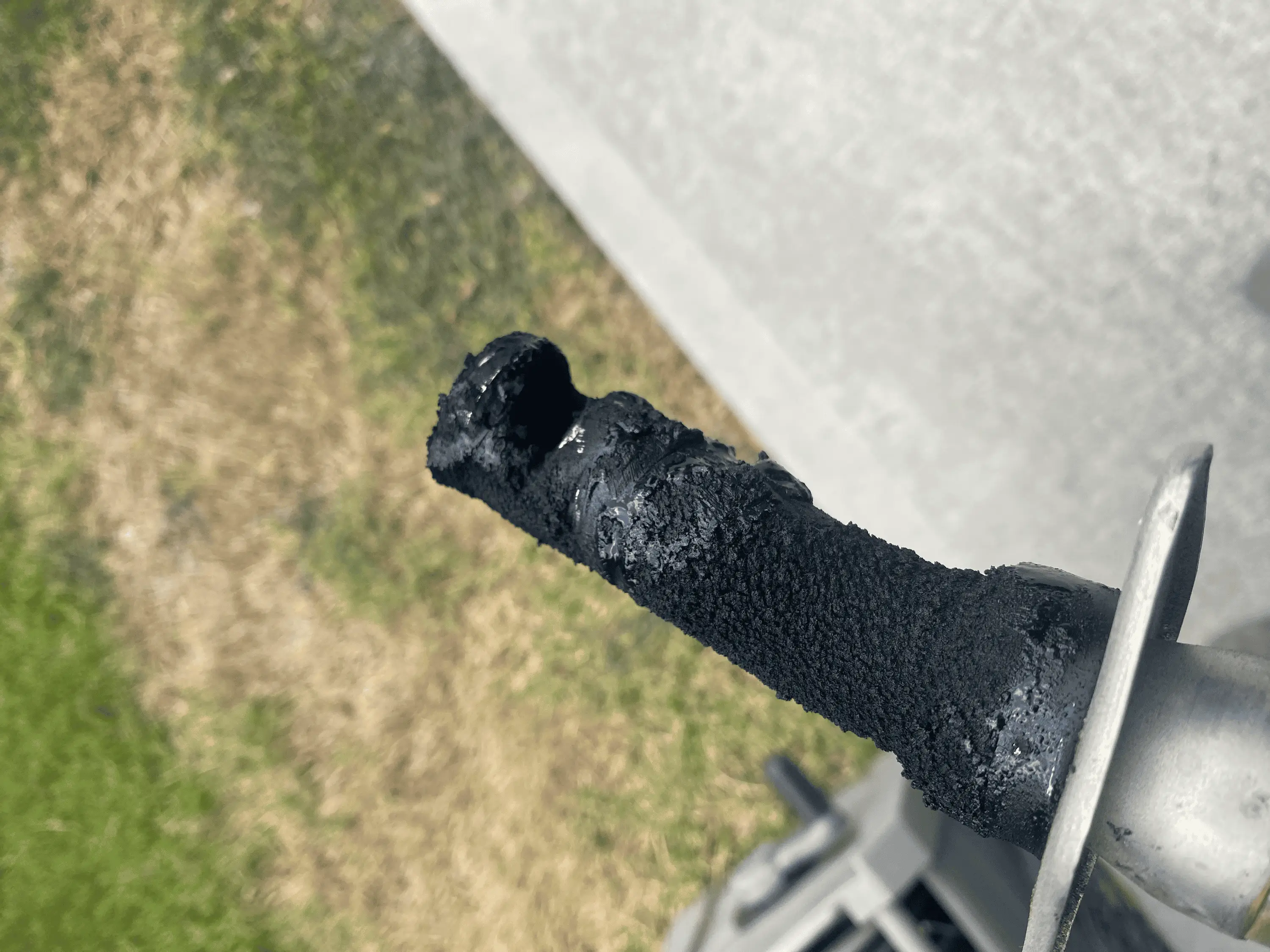

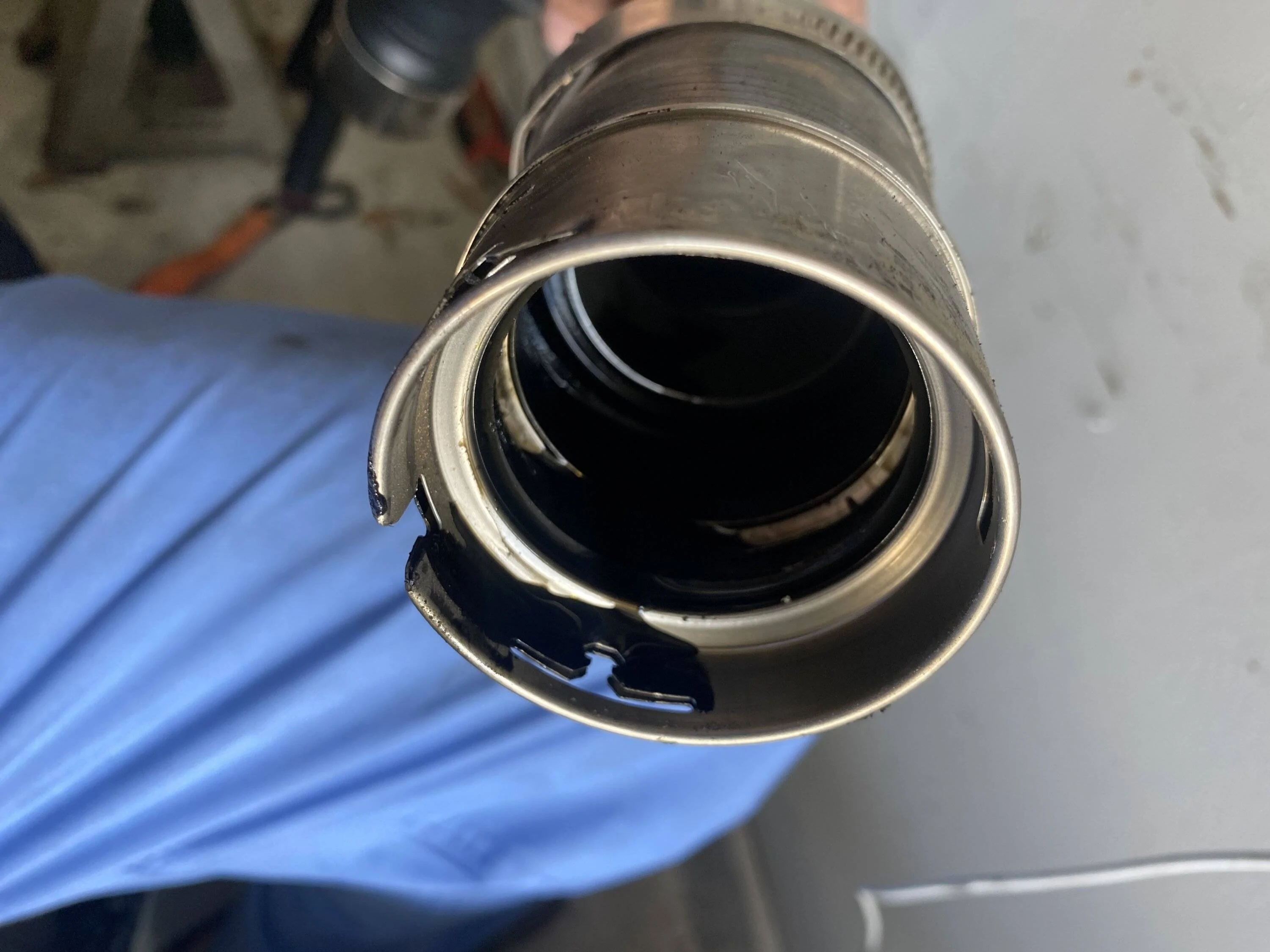

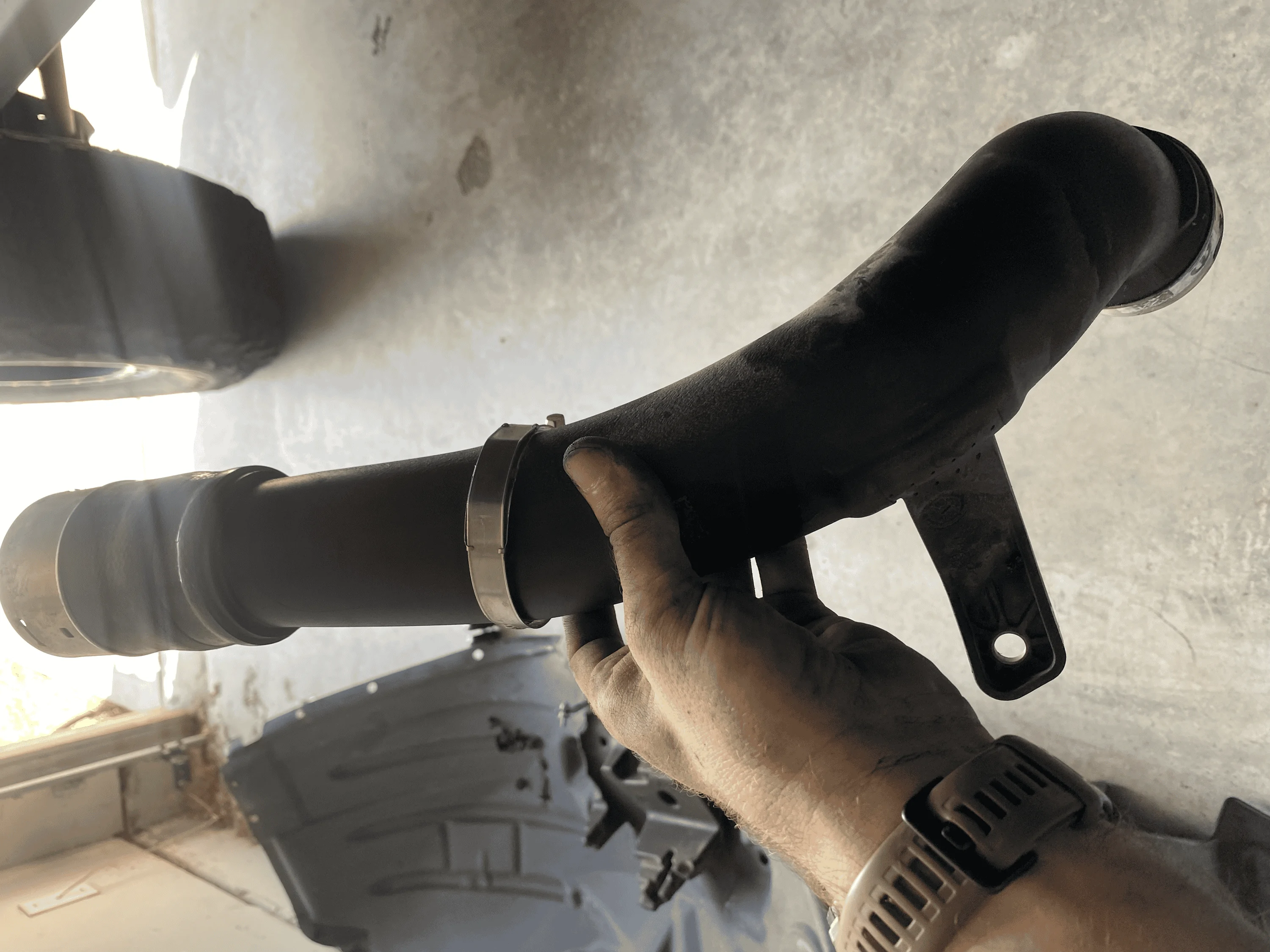

I think my turbo went. There was a weird sound when I accelerated that I thought was the AC. Later that night, I lost all power and had the CEL light come on. I also got warnings to service the electronic throttle and traction control. Weirdly enough, my Tazer did not pick up a DTC code. I cleared the CEL the following day, and the Jeep drove fine; however, I still had that AC surging sound. Upon rolling my window down, it was apparent it was not the AC, but a vacuum sound coming from the intake or turbo. I drove it to work and boom, lost power and had the same "service electronic throttle control and stability control lights come on. I must add that the Tazer's boost gauge is not reading anything. Well today I removed the right turbo inlet pipe and it's full of oil. Additionally, the high-pressure EGR tube looks like a mess. Not sure what happened, the jeep was running fine until this. Previously I did have a coolant leak at the turbo, however, that was fixed when my warranty was still current. Just posting to let y'all know I guess. Not too sure what I'm going to do, as removing the turbo is a serious job.

Looks like there’s been some oil coming out for a bit there. Is all caked on next to the tube.
Hows your oil level? Did they damage a return line when they did the coolant leak? Is air filter completely gummed up?
PCV valve or bypass stuck closed?

Oil level is fine. I've never had oil pool anywhere, I assume the return line is intact. Air filter looks fine too. Not sure about the pcv valve or bypass...

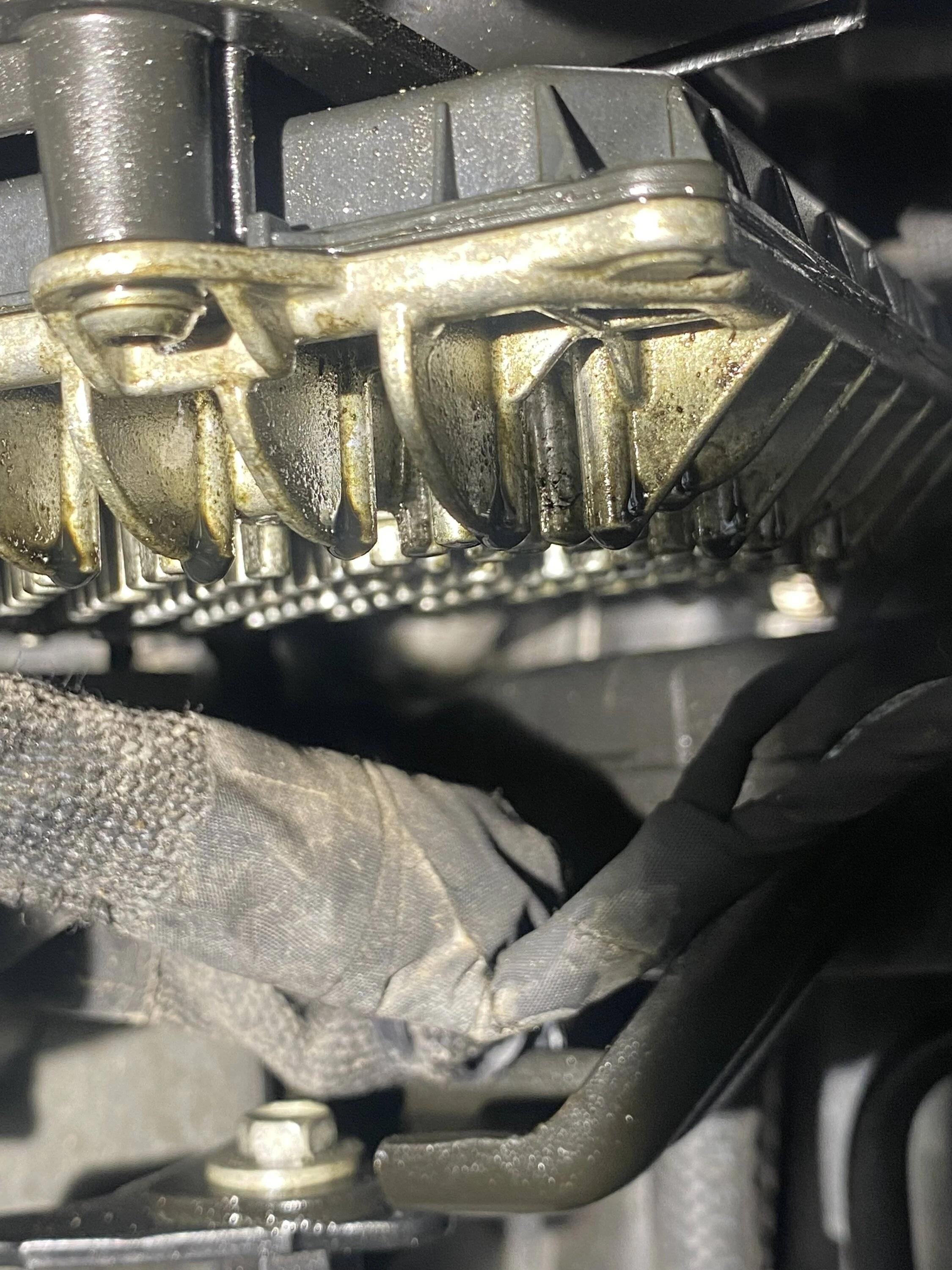

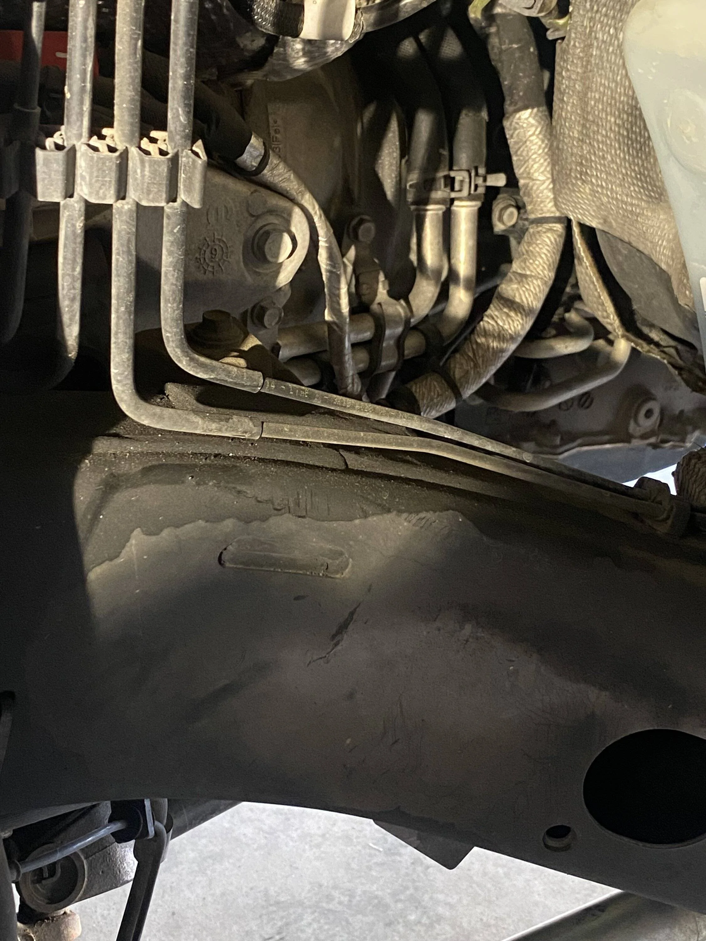

So not much of an update, but I found all of this behind the driver tire in the wheel well. It doesn't feel like oil, more like sooty coolant? I haven't a clue.
[/QUOTE]
mixture of both perhaps
