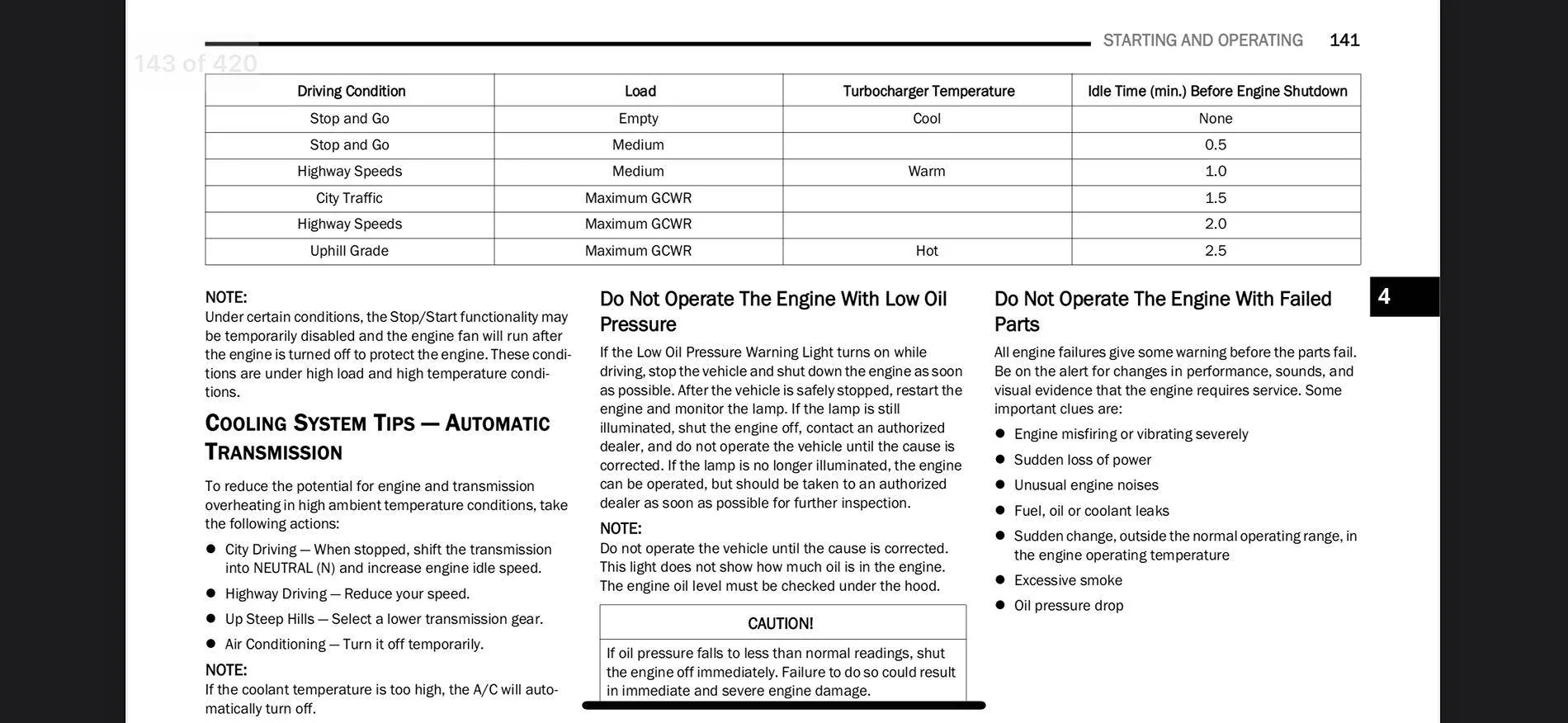

Are you idling your Jeep to cool it off before shutting down? My guess is your shutting it down hot and the oil is cooking inside the turbo.
Your manual has recommendations for when you should idle and cool down before shutting off the engine. Every time I go to shut down I put my heat on full blast and wait until my engine oil temp falls below 200° F before I shut down. Excessive? Most likely, but this engine runs hot and heat soaking your turbo with hot oil will cause issues sooner or later.
Edit: Page from my 2022 Gladiator below.
Letting the turbo cool down is key. I monitor my turbo temp with a scangauge and make sure the temp drops below 400 before I turn off the engine. This number falls in line with the idling time recommendations in the manual.

Fantastic information. No. When the check engine light came on and throttled me down to 45 mph it was ran hard out of town and back home at high speeds so that makes complete sense.
